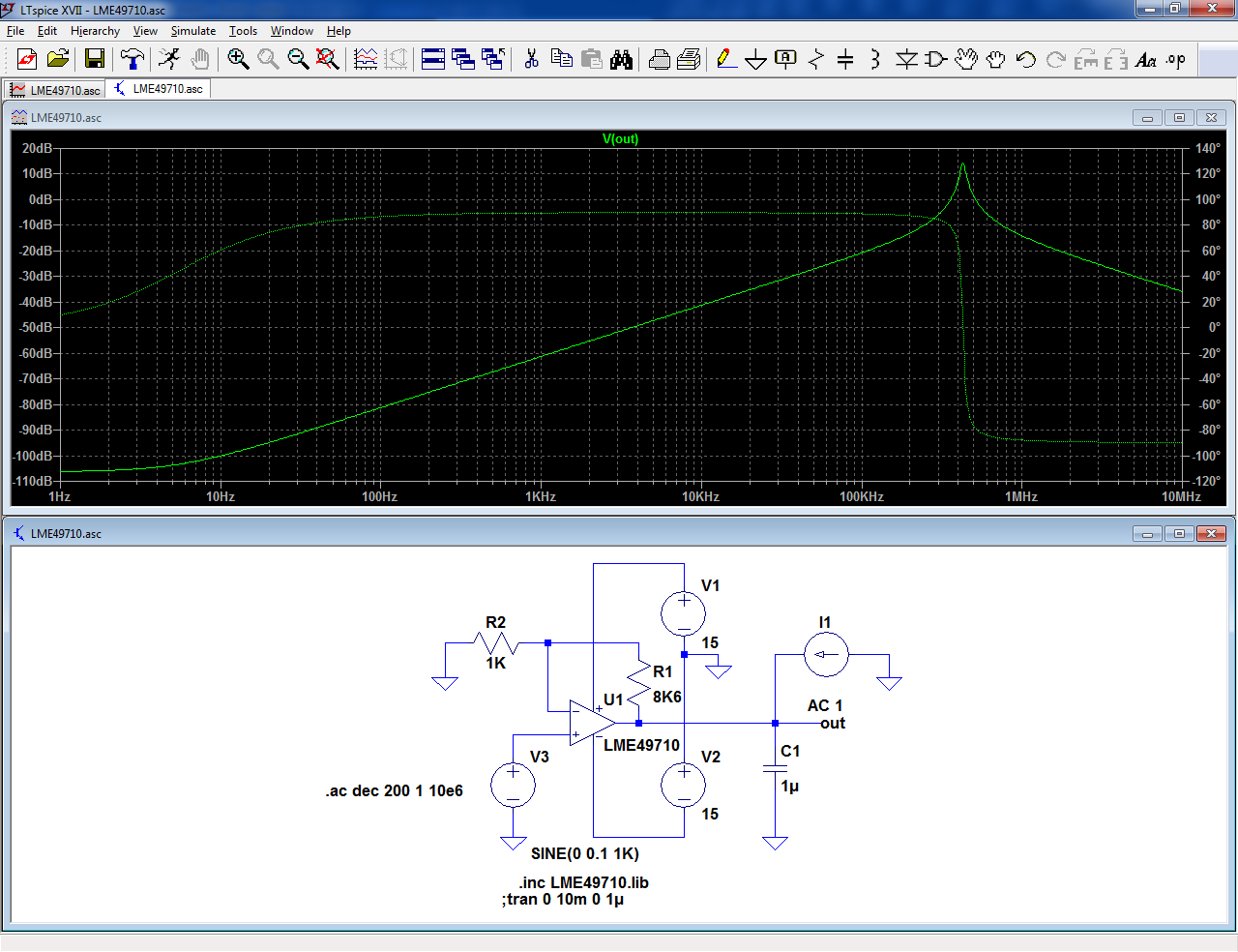

In this application note from National Semi, look at the opamp power supply buffers that feed the RIAA preamp. Joe Curcio showed this basic opamp buffer first in issue two-1985 of The Audio Amateur in his Daniel tube preamp. I have not seen any discussion of this power supply buffer that is supposed to have low impedance over the audio bandwidth. Has anyone tried this buffer design, and if so how did it perform?

A straight connection directly to an undamped 1µF capacitor sounds dangerous for the vast majority of opamps.
Here, the opamp is operated at a gain of ~10, which may ease matters, but that would still be insurmountable for the vast majority of the chips.
Some opamps are known for their tolerance: for example the LF356 tolerates 10nF.
Maybe, as an insider, Mr Curcio knows certain things we don't, but in the datasheet, there is nothing hinting at that:
The LME49710 is a high-speed op amp with excellent phase margin and stability. Capacitive loads up to 100pF
will cause little change in the phase characteristics of the amplifiers and are therefore allowable.
Capacitive loads greater than 100pF must be isolated from the output. The most straight forward way to do this is
to put a resistor in series with the output. This resistor will also prevent excess power dissipation if the output is
accidentally shorted.
I don't have 49710s handy, but I have LM4562s, and they look very similar.
I will make a little test, to see how the output impedance behaves with a 1µF load

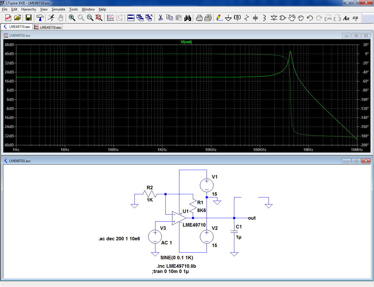

According to the own model provided by NS/TI, this arrangement does nasty things.
The output impedance shows a peak at ~400kHz, something less than ideal for a supposedly perfect bypass:
attachment.php
Looking at it the other way, the peak is also present in the gain: more than 20dB excess, which is going to corrupt the carefully LP-filtered input:
attachment.php
792668d1573037969-opamps-low-buffers-lme49710a-png
792669d1573037969-opamps-low-buffers-lme49710b-png

...output impedance shows a peak at ~400kHz
This after the paper states "the power supply rails must present a low and more importantly flat impedance across the audio bandwidth" ???
Instead we get 1 milliOhm at 1kHz, 10m at 10k, 0.1r at 100kHz ???
In fact it is a 0.15uH(?) inductor !!!
I agree this is "low". Sure aint "flat".
1 Ohm in series would swamp the <20mOhm impedance in the audio band.
I have made a real-world test, not on the LME49710, since I don't have any sample in my drawers, but on the LM4562 which looks like an almost perfect clone, based on the characteristics.
The pathological behavior observed in sim was present, but to a lesser degree: the resonance peak was around 250kHz, against 400kHz in the sim, and the peak magnitude, both for gain and impedance was ~10dB, against 20dB in sim.
I made the test on a breadboard, and the 1µF capacitor was an ordinary 63V metallized mylar cap, which could explain the differences in part or totality: the breadboard adds contact resistances and parasitic inductances, and the cap is not the ideal one of the sim.
It could be that with a good PCB and a PP plain foil cap, reality and sim would converge -or not-.
Anyway, even if this expedient looks rather harmless, it is probably better to stick to more conventional solutions: monolithic voltage regulators are designed for the job, in particular capacitive loads, and they can be quite good regarding noise.
The LME is in principle better in this respect, but since it necessary to attenuate the reference voltage to reamplify it 10x afterwards, it mostly negates this superiority.
Initially, I made the test with ground-referenced inputs, but later I realized that using the opamp in a single-ended, regulator fashion could make a difference, and I modified the test setup accordingly, but no significant change was visible
