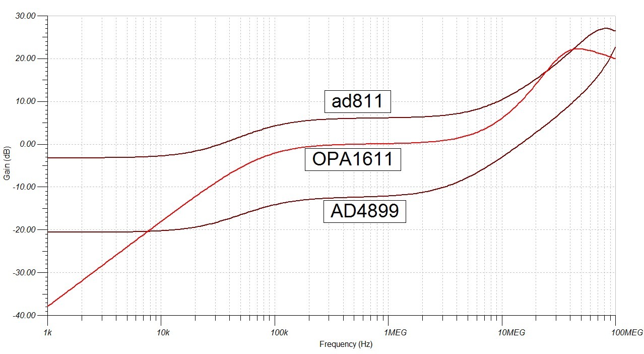

This thread sparked my curiosity.. is it for granted, that a CFA with low 1/F noise corner is the best under the sun? How about modern fast VFA parts.. I have shown the OPA856 before, but OK, it shows high-ish 1/F noise corners (though for me don't seem that tragic).
Looking closer, the AD811 has the drawback of instability (with Cfeedback) without that certain 1kohm series 'damping', compensation resistance inserted at the -In input.
The problem is that once this compensation part is inserted, we can say goodbye to the most desireable feature of the CFB opamp -the 'natural' low impedance at the -In pin.
Also, that inserted 1kohm series res. brings at once 20nV/sqrtHz extra noise on -In input. bye bye 1nV/sqrtHz nominal input noise! sounded so nice, in fact could not ne true..
Also, the compensation resistor forms a divider with -In input node ~15ohm impedance, so some kind of 'noise gain loss' is introduced, we loose loop gain efficiency.

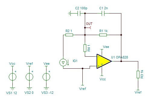

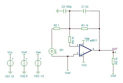

Here it is a sketch of my sim file:
- the actual values are arbitrary, I've been concentrating on the comparison of different parts in the same circuit, though tried to choose close to the usual values. that input 100pF wish to represent stray capacity in dac output circuit. C feedback again, only approximately the usual applied range.

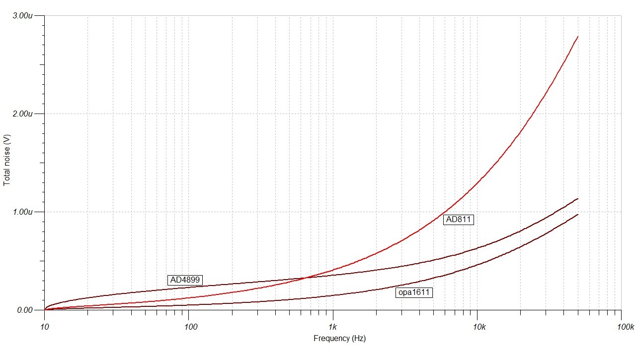

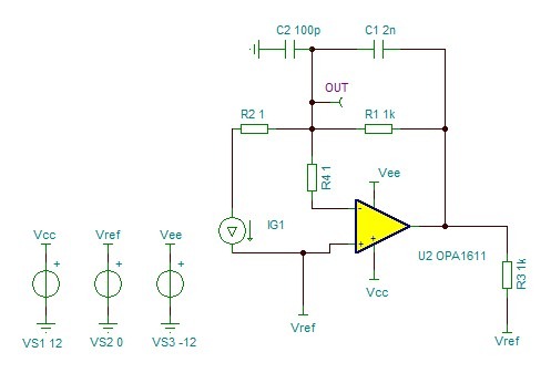

So, I tried to sim three parts:
AD811; the popular CFA;
OPA1611 (VFA, classic for I/V); ADA4899 (just to see what a real good VFA could offer)

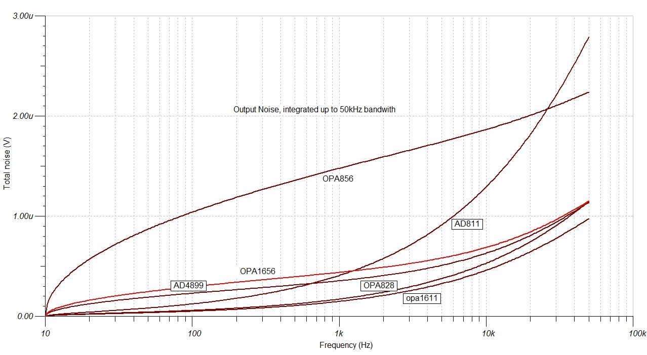

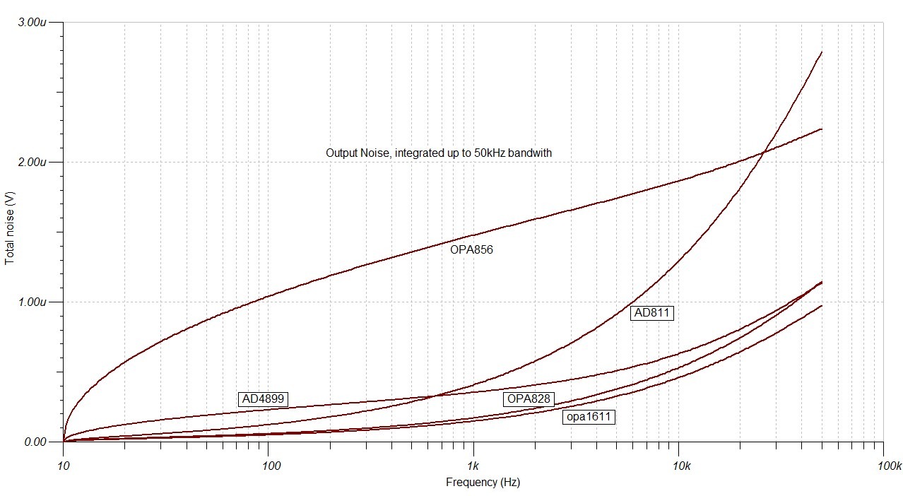

First round of comparisons is the noise on the output:
I do not see the AD811 as the absolut champion here..

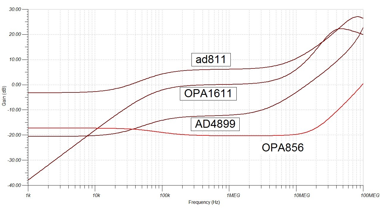

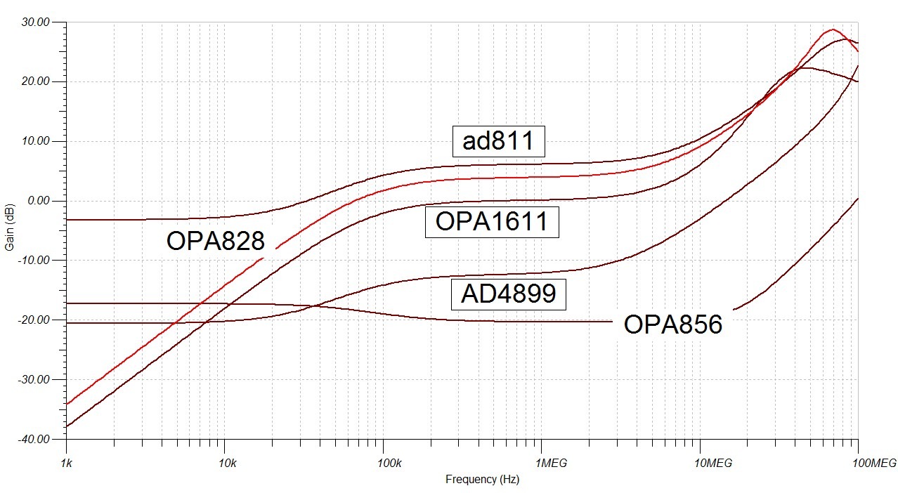

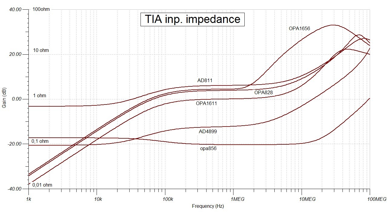

Now the interesting part: how about the real (simulated hehe) impedance at the Feedback node in an actual applied circuit:
I beg your pardon, in Tina is a bit awkward the presentation of the result: we see the log. value with respect to 1ohm (0dB= 1ohm, -20dB =0,1ohm, +10dB =3ohm etc..)
I hope it shows what I tried to describe: The AD811 is far from the best result, at least up to 100MHz...
In a practical I/V circuit the feedback node input impedance is depending on both the available loop gain, & the actual Rf value. Higher Rf > higher (worse ) input impedance. So in active I/V circuits the higher the dac output current, the lower can be Rf and better conditions for summing node impedance..

I see the OPA1611 ivery near the AD828. The AD828 is not my prefered I/V OPA while one of the best I have found. At the opposit I find the close OP1611 to be very borying at that task... I am not the only one that experienced it. A little "noisy" op1656 is much more nice at ears than the opa1611.
That opa 856 has some linearity... high SR iirc.

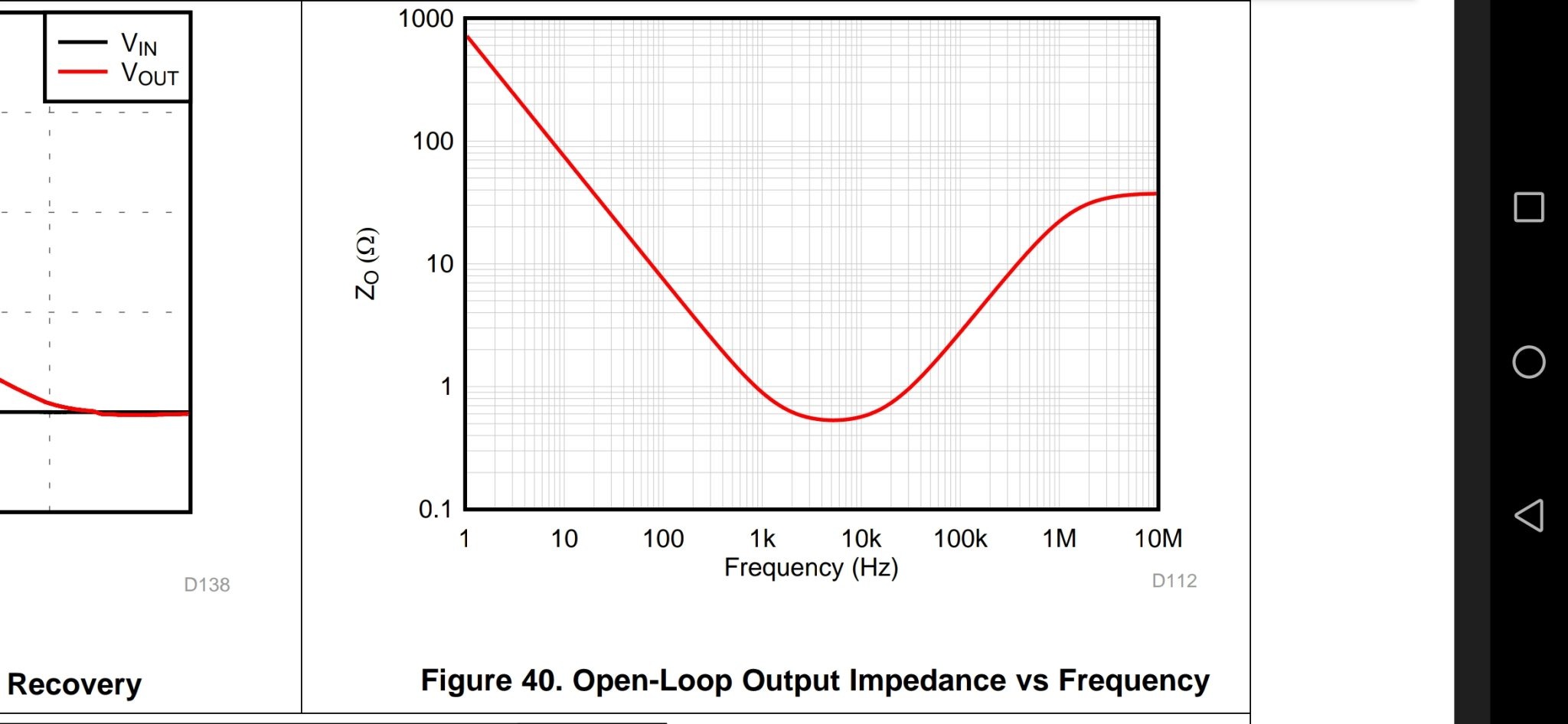

That jump in the 1656 inp. impedance curve .. how can that happen? An error in the spice model..🤔..
Or.. open loop output impedance excursions maybe?
I have quickly found an exchange with JohnC here, talking properly about that.:
3. OPA1656 will not have the flat, 5 ohm, output impedance of the OPA1622. Combining a rail-to-rail output stage with a 3 gain stage architecture in CMOS normally results in regions where the output impedance is inductive. There will be a graph in the final datasheet.
Looked up the datasheet. It's clearly stated:

This paper might be of interest, it suggests the 1k isn't the only possible solution : https://www.ti.com/lit/an/slyt081/slyt081.pdf
Very nice article.
Though a ferrite bead will increase the impedance at the input node the same way as the series 1kohm res, at those frequencies where it 'hurts'..
It does help with less noise in the audio range, but do not resolve the rising impedance at high frequencies.🤔
What about a 'turbo' solution, like an opa1611 with max ~1ohm impedance all the way up to 100/200MHz?
with only a little noise penalty

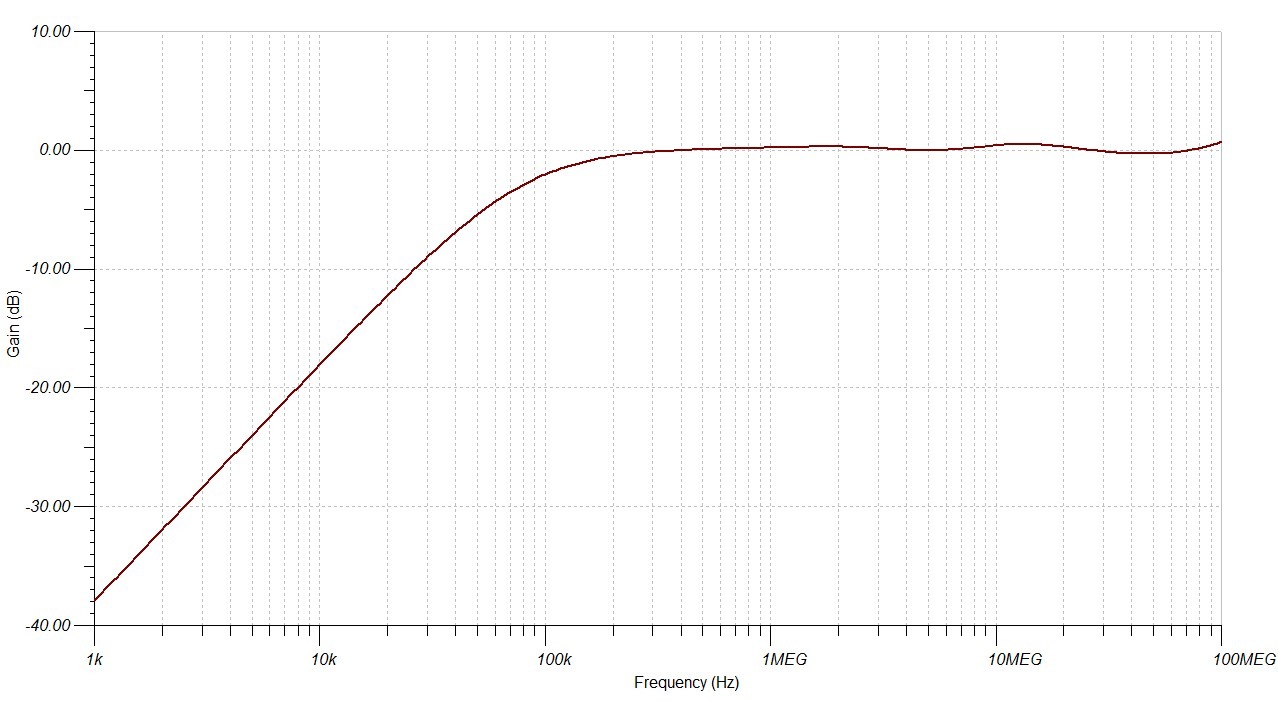

what about making with it a second order low pass at this corner with a shunt cap or if not feasible swap the ferrite by a smd coil ? Too much inductance maybe? not linear ? Added input stray capacitance due to the footprint of such parts hence less linearity ?
opa1611 40 M hz at unity gain (not bad, not great for a dac output) ; SR is not great : 27 uV for that task but certainly not the most arming. The settling time is certainly bad. Source impedance of the AD1862 is 2k6 Z, certainly too high for that chip. (ad797 or opa211 better here in the family of low noise bjt opa?)
Perhaps the max flatness is important for a dac chip currentto voltage conversion and a 0.1 % max flat is the thing to focus on ? Current noise input is low but a fet one is by definition greater : the ad828 is in the fA range...
