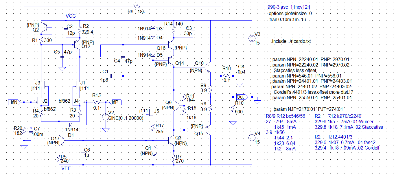

yeah well the schematic for the JE990 and other variants of high performance discrete opamps are being published and digested right here
heres the latest JE990 schematic

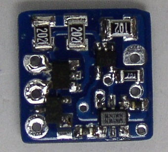

and Scott Wurcers SW-OPA which people are starting to breadboard.
