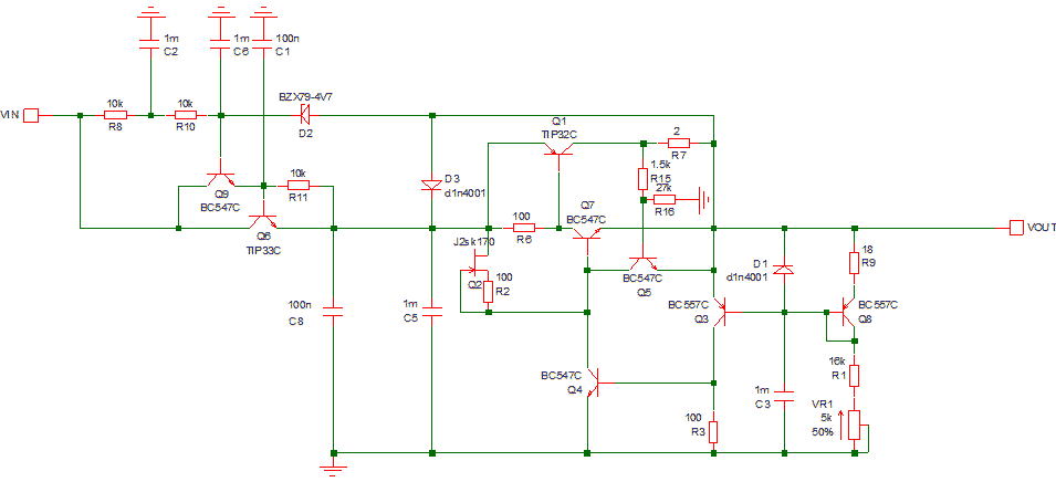

Hey guys I was just doing a little web surfing and I found this little DIY company in Taiwan and they have this dual regulator that you can buy as a kit or just pcb for around $32 or $8USD

What do you guys think of this regulator circuit?? The price for the kit is almost to good to be true, I mean it would cost me almost $30 to get just the pcbs for the Jung super regulators!

I think you can do better on your own. Three things stand out on a cursory glance; the way that reg is laid-out, you need a raw rail at least 5-6v above the desired output (minimum 3v dropout for the LM317/337 pre-reg; opamp might swing within say 2v of its supply rail; a further 0.7v lost at pass transistor base-emitter). Also, the output from the zener reference could use some RC decoupling for lower noise (e.g. add a good-sized resistor between U3 and C7); and R4 could use a capacitor bypassing it (say 10uF)to reduce noise gain in the error amp.
Dig up Walt Jung's articles on improved regulator design and re-read - there's lots of good hints in there. As it is, implementing a basic LM317/337 well will take you much of the way for peanuts, while you decide how you really want ot 'go for it'.
