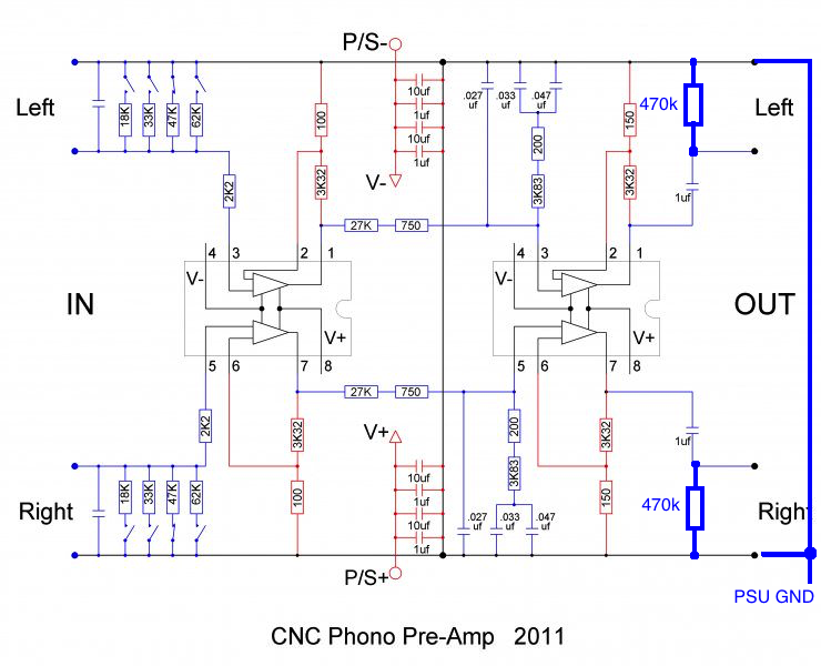

Hello. I just finished building a phono pre based on this schematic:
I already built one and it sounds great. When I assembled my second one tonight, the sound is distorted after a few seconds. A little experimenting revealed that if you turn it off and back on again, the sound is great and then it gets distorted and stays that way after a few seconds. Turning it off and on restores the quality temporarily. Here's a video I took:

Whomever drew that schematic missed the ground. I'm also not a fan of the floating output caps. Connect the ground and add 470 kΩ on the "outside" of the output caps, and I bet your amp will work just fine. I bet the reason it isn't working is that the ground is floating.
You're using a dual or split supply with this, right? I.e. ±15 V or something.

Any of the opamps getting hot?

Hello and thank you for trying to help me! I'm using 2 9 Volt batteries. You can see the power supply setup and hear the problem here: YouTube
I don't know anything about circuit design and I'm new to DIY, but I built this same circuit a week ago and housed it in the same enclosure and didn't have any trouble with it. If it's not a grounding issue, do you know what else could be causing the distortion in the video? Thank you.

The centre point of the two 9 V batteries in series will need to go to the connection I marked PSU GND in the schematic.
I don't know if this is how you've connected it already as your schematic does not show the battery connections. I don't have the patience to try to tease this out from a video. Please post a schematic.
