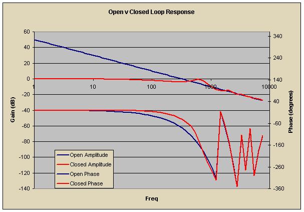

Opamp phase shift - open and closed loop.
As we all know, any opamp has a certain amount of phase shift that gets greater with frequency. Manufacturers publish these figures for open loop. What happens to the phsae shift when the loop is closed though? Obviously the phase shift still exists inside the feedback loop, but what if you measure it outside the loop? Does it decrease in proportion to gain reduction like distortion does? Does it stay the same?

Hi Circlotron and others,
Open and closed loop phase shifts are related. Then, both are related to the opamp’s bandwidth. The higher the bandwidth, the lower the phase shifts at given frequency. Also, opamp set to lower gain has higher bandwidth and hence lower phase shift.
Here are the numbers. With gain of 20, LM6172’s (100MHz at unity gain opamp) phase shift at 20kHz is less than 0.2deg, and group delay (difference between 1kHz and 20kHz) is notably less than 1picosecond. In the same circuit OP27 (8MHz at unity gain) has more than 3degs phase shift and difference in group delay is more than 1ns. The same OP27 when works with gain of 4 has phase shift less than 0.5deg and group delay of a few picoseconds.
If you check these numbers calculating these shifts from corresponding group delays you’ll se, as Steve mentioned, the bulk of these phase shift numbers are caused by the propagation delay and not by the non-linear group-delay. But again, propagation delay is in relation with the non-linear group delay.

From a theory point of view, in a unity feedback system (buffer) the frequency response of the closed loop system is G/(G+1) where G is the complex open loop response. I made a plot showing the relationship for an arbitrary system with a delay.
The simple way of looking at it is that closing the loop reduces phase lag in the 0dB gain neighborhood, but not by much.
