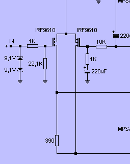

The interesting point then is that it also applies to most power amps, which are also op amps topologically, although perhaps not considered as such usually. It seems then it would perhaps be a good idea to rethink how the feedback is done in power amps, and make the whole amp inverting instead.
My thoughts exactly. Have a look at this small portion of an Aleph 3 cct which in this part is similar to many other designs. Notice that the signal is applied to the left side fet gate and the feedback is applied to the left side fet source via the long tailed pair. This is because the signal and feedback are in-phase so they must be applied to legs of the fet that have opposite phase properties to each other so the signals will subtract.
Now comes the important bit... Notice that to get to the left fet source the nfb has to go through the right side fet gate-source!!! The point is, the nfb signal at the gate of the right fet is a virtually perfect but scaled down version of the output signal, but the nfb signal that is supplied to the "inverting summing junction" of the left fet has suffered the indignities of passing through the right fet, and so any distortion added by this fet has made the nfb signal invalid because it is now not a perfect representation of what is coming out of the amplifier. The summing junction is making incorrect compensations because it is based on false imformation because there is an active (and not distortion-free) component in the feedback path.
The alternative is to have the left fet gate tied to ground, and feed the signal in through the bottom of the 220uF cap that is normally earthed. This makes the whole cct inverting just as in the opamp discussion, and what's more the summing junction is not now a semiconductor but rather the junction of two resistors, the 10k and the 1k. If they together are not several orders of magnitude more linear than a gate-source junction then I'll eat my hat.

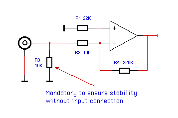

Maybe it is already said and have I missed it in this long discussion:
If you use the inverting topology for audio the op-amp MUST be unity gain stable! Why? Well you don’t now one forehand by what impedance it is driven and the driving impedance is part of the feedback circuit. Let’s say the input cable is disconnected: Then the closed loop gain is 1 or unity. If the op-amp is not unity gain stable the amp will for sure turn into an oscillator.
The LM3875 is only stable for closed loop gains of 20 dB and higher. When in inverted topology and without sufficient low driving impedance (particularly at high frequencies, just before the 0 dB open-loop crossing point) it will for sure oscillate and possibly damage your tweeters.
You can get rid of this by placing a sufficient low resistor at the input, according to the attached schematic, to keep closed loop gain above 20 dB under all input conditions.

Circlotron,
In non-inverting mode there is no "inverting summing junction" as such. You see in this case the term "summing junction" is really to do with summing current, not voltage. In the non-inverting differential amp the differential output current is related to the difference in gate voltages divided by the sum of the transconductances of each device. It is the summing of the transconductances that benefits distortion. In this mode is is not correct to think of one FET acting as an unwanted gain stage - both devices need to be considered in tandem. Even in the inverting configuration the differential FETs are still in circuit: the output current is related to the "summing junction" voltage divided by the sum of the transconductances. So perhaps the critical question is whether the "summing junction" voltage is equal to the (scaled) difference between input and output, and I think Pjotr's point applies to the answer.
