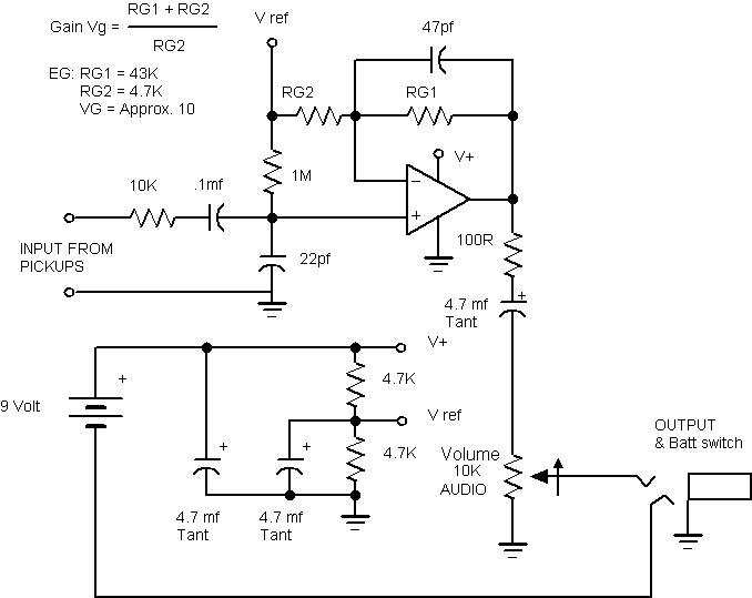

Im planning to build a Opamp based preamplifier for my guitar(complete SMD). The circuit should act as an impedancetransformer(don't know the right word, sry) with about 10dB gain.
Here's the schematic:
Could you check the values which i plan to use?
Which Opamp fits my needs: SingleOpamp, SIL-8, Low power consumption? TL061?
It will be powered with an 9V battery.
Thanks in advantage for your answers.
julian
If you plan on using just one 9V battery, the op amp needs to be referenced to 1/2 the supply voltage in order for it to swing rail to rail. See the drawing I attached. You don't need the volume pot if you don't want it.

Ok, after Reading through the "Op-Amp Design Reference" from TI I came to the decision that I need a split supply(wonder 🙄 )
So I thought this would be nice:
Because I want to use as less space as possible I want to leave out D1/R1(useless) and C1/C2(does that work without?)
D1/R1 can surely be left out. But the caps should stay. Though lower capacitance would do I suppose.

If you want something simple and low-power, I'd suggest going with a couple JFET transistors instead of some Op-amp.
I designed one with 4 JFETs, that has up to +20 dB of gain, very low output impedance and draws only about 500 µA (max). The plus is that it does have this slightly "tubesque" sound that you can't get with an op-amp. Oh, and after designing your first circuit with JFETs, you start feeling like a grown man. lol. 😀 :smash:
