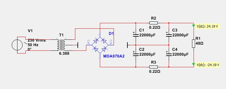

The power supply is based on a toroidal 2x18VAC transformer.
This gives like +/-24 Volt.

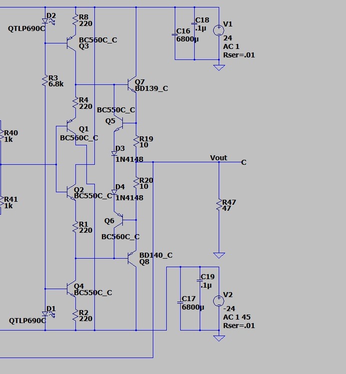

Despite the symmetry, it needs a polcap between the collectors of U12-U13.
U12-U13 do not transfer ('equalize') any (open loop) differences causing the feedback to do much more correction.

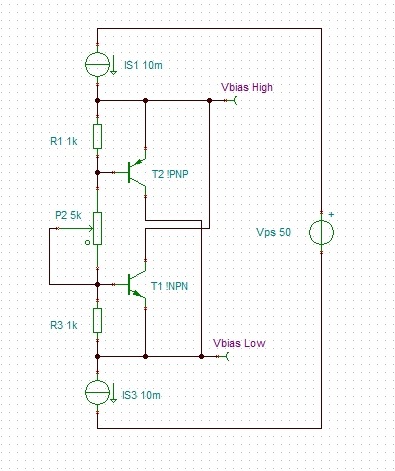

Use a symmetrical 'diamond'-style bias circuit instead (emitters on the outside) to get rid of such a polcap, it improves dc stability also.
I have added a polcap like you said.
Value = 47uF.
Is this a good value or ....?
Can you show me how that 'diamond'-style bias looks.
I am not familiar with that.

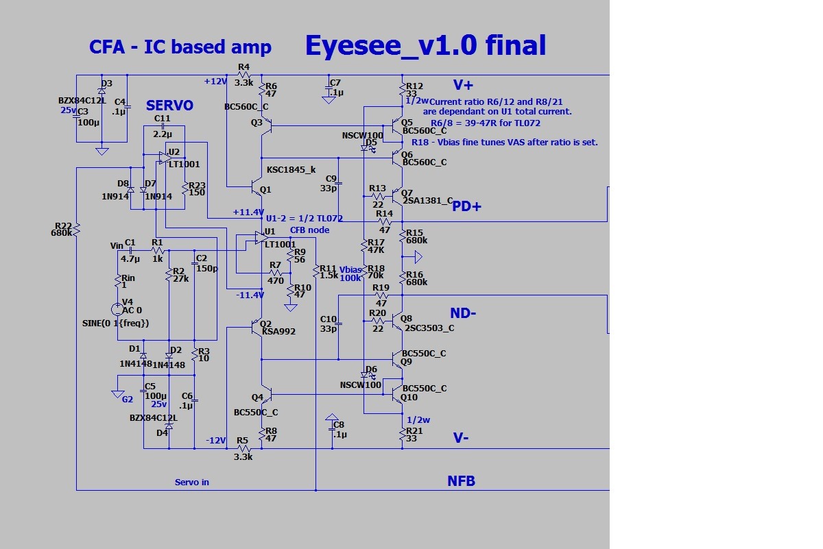

Is this even stable? The opamp is dominate pole compensated and so is the remainder of the circuit. Looks like 180 degrees of phase shift to me. This is an Oscillator. Use really cheap transistor on the output so when they blow it won't cost you much.
C4 is necessary for stability with these amplifiers. If “slow” output transistors or large parallel banks of them are used, connect C4 to the output of the VAS instead of the output terminal. If you insist on symmetry, split it.
I‘ve seen amps like this get the value of the lead cap dead wrong, and that makes them really finicky….
Here is the "real" way to do it, My builder got .001% , reflecting the op-amps native THD.
What is cool , the 2'nd op-amp controls the servo by tweaking the current of the active one.
The squarewave response of this was in the CFA realm @ 200+ V/us. builder said the sound was
"holographic" - that's subjective BS.
If I upgrade this , I will add pass 12V regulators and a upgraded VAS. Current mirror VAS's are quite
speedy , Widlar CM's are even faster.
This will drive a standard "Wolverine EF3" most perfect.
