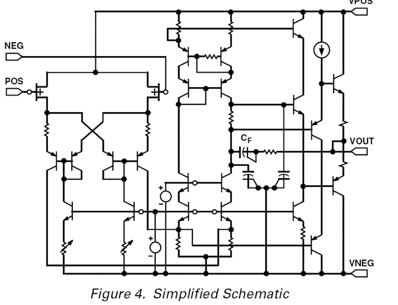

Christer> It is true the compensation method described in the app note I linked to is to compensate the Buffer only. If you noticed the illustration circuit it was used in had the Buffer driving a Converter input. This is almost a purely capacitive load with an almost non existent parallel resistance. Emitter followers do not like this very well and can peak or become unstable driving purely capacitive loads. Several methods are used to deal with this, with the most common being adding a small resistor in series with the output of the Buffer to isolate the load capacitance. This method has the drawback of higher output impedance. An alternative method I use a lot is to put a ferrite bead in parallel with this output isolating resistor so as to bring down the output impedance at lower frequencies while still letting the impedance rise at higher frequencies to maintain capacitive load isolation. This is similar to the R/C network on the output of loudspeaker Amps. Also in addition to C1 you can put another small cap across R3 to compensate the overall loop including the Buffer. Finally you could additionally add what I call Noise gain compensation. This is a series RC/ network connected from the Inverting input to the non inverting input of the op amp. I must point out that noise gain compensation requires at least C1 in the first schematic illustration I posted. I don’t think you will have to go that far however and Noise gain compensation can get real tricky under some situations.
The Attached Image is of the AD825 op amp. notice the R/C network on the output stage. this is similer to the capacitor placed between the Buffers output to input as depicted in the app note i linked to in my first reply.
Ppl,
thanks for your suggestions. I will use an output resistor, of
course, but have never heard of/thought of the ferrite-bead
method before. As with many things, it is obvious in retrospect,
when somebody tells you. I am not sure i will need it, though.
I will also consider the other suggestions you made.
However, my original problem was solved by jcx. Of course,
if someone had told me to draw a unity-gain op amp
configuration, I would have done it right. But I was so stuck
into my design and various historical design decisions in it
that I missed the obvious.
