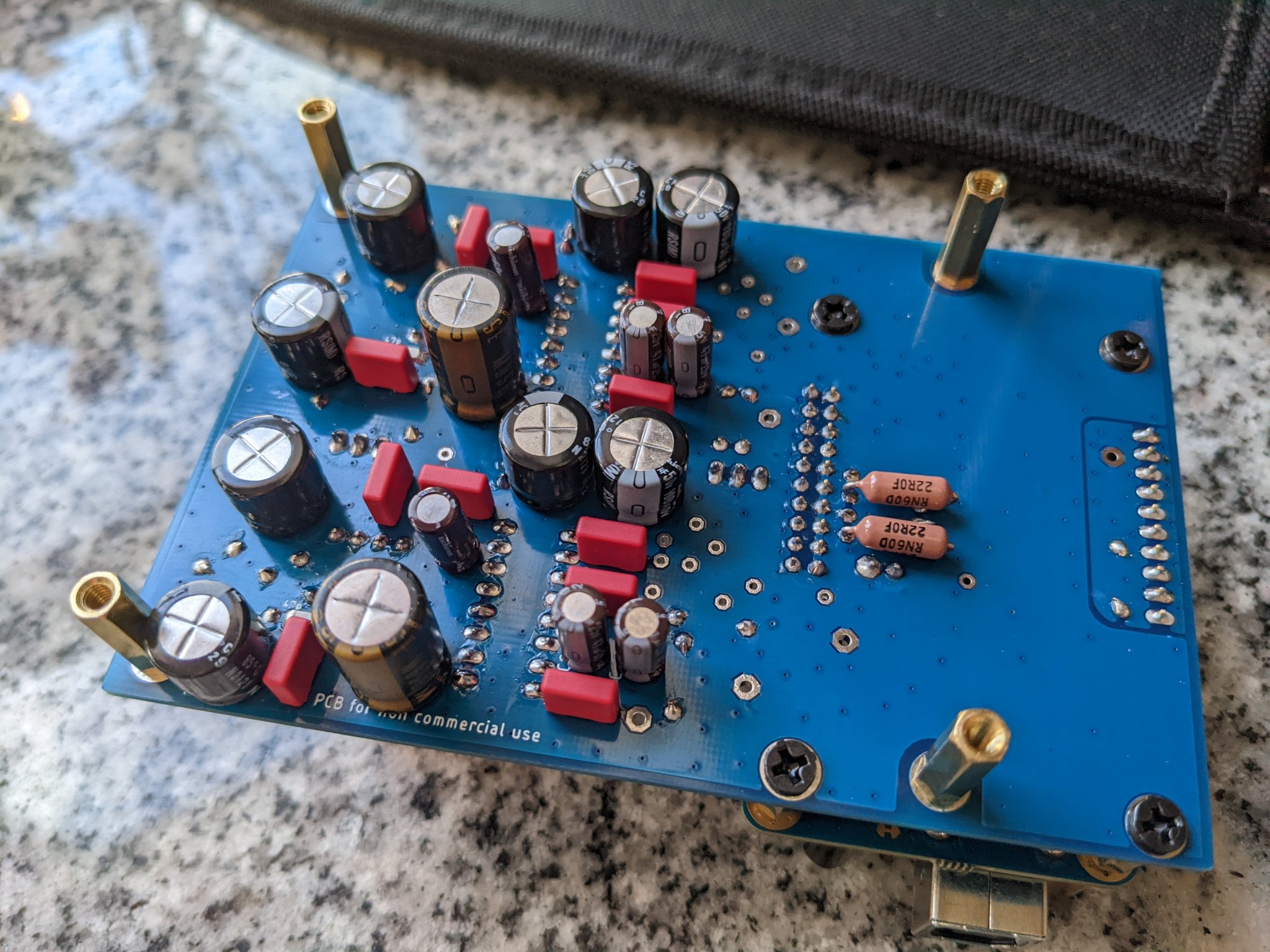

In order to get the Burson Op amps to fit my board, I had to build a second one with components on the bottom.
I was hoping to make some revisions anyway so it's not a huge deal in my case, but if I were less comfortable with soldering and I was working with factory built stuff, this would be a cautioning factor
(In case this is worrying anyone let it be known that I still need to clean flux off, so these photos are not the final for this board.)

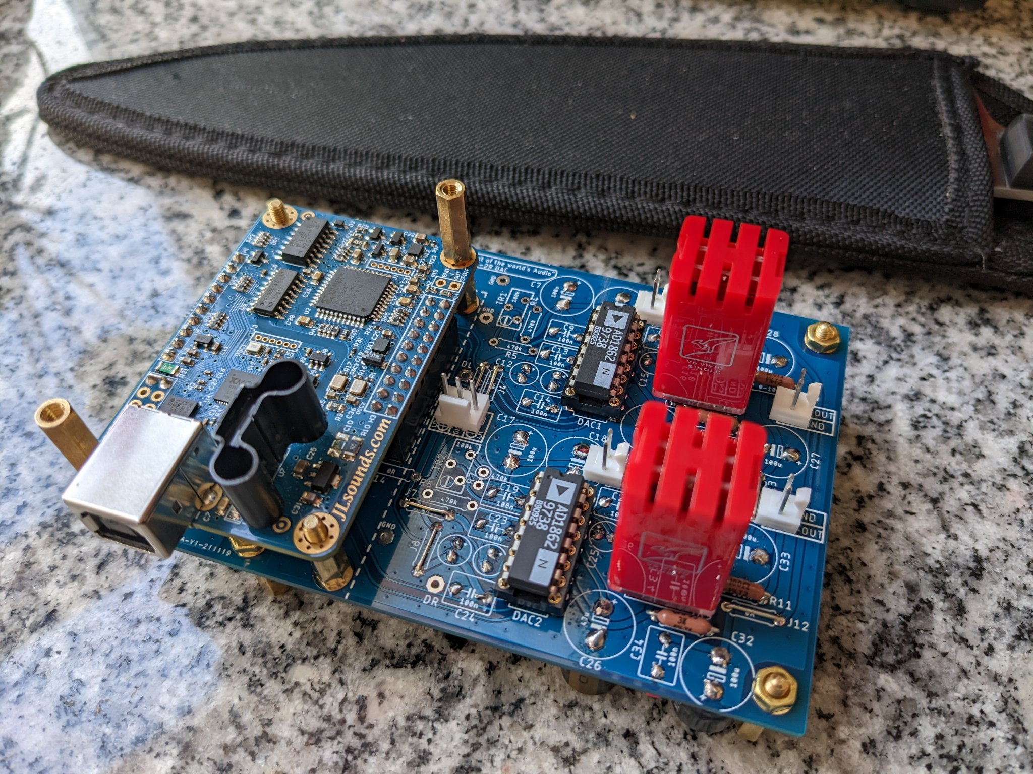

Asilker, your dac board looks great with the dac chips and twin towers on top 👍

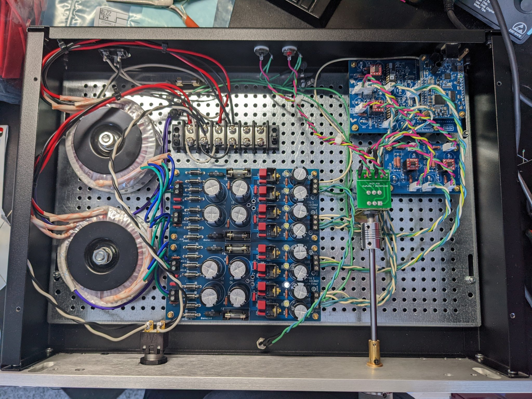

Finished a full rebuild on my DAC and my friends will be over next week to test things out. I also have a box of Owens Corning 703, maybe I'll finally knock up some frames and get them on the ceiling -- intent is just to catch some of the obvious slapback and sibilance in the room.

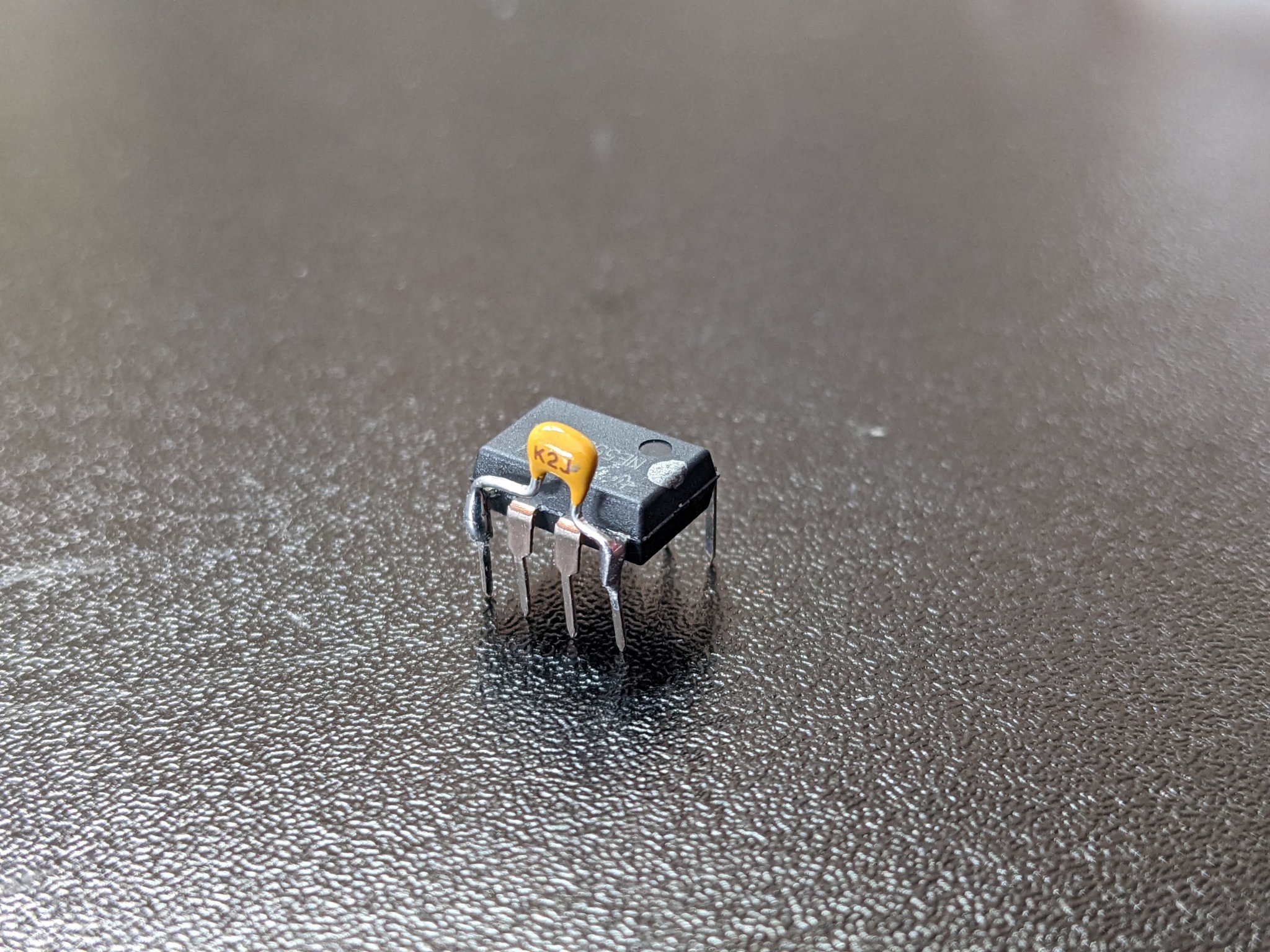

And the NE5534's are externally compensated as per the Phillips spec sheet.
