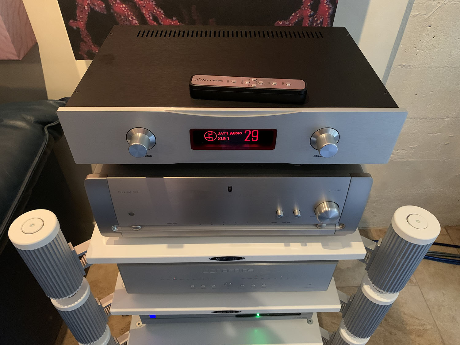

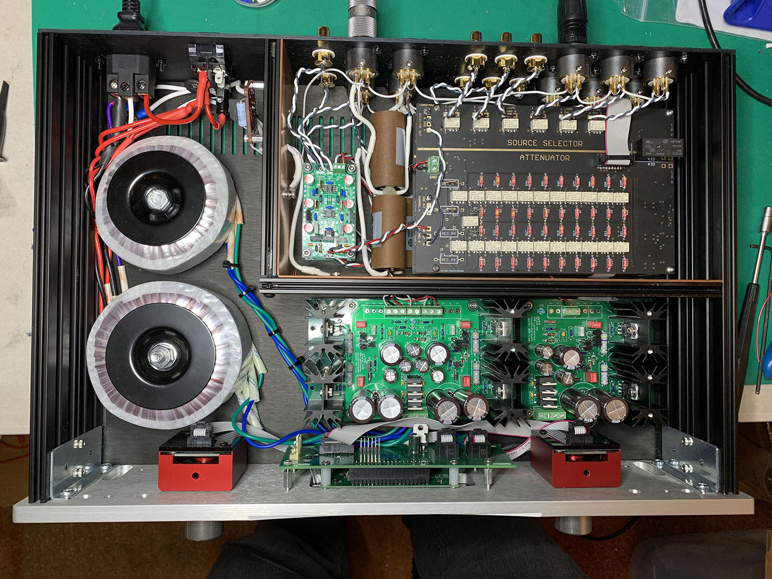

I recently completed a preamp very similar to what you are describing. I used a four channel (balanced stereo) relay-switched attenuator from Khozmo, operated as a shunt attenuator, feeding an op-amp based output buffer using alpha-24 PCBs from AMB Labs.
The alpha-24 is an instrumentation-style design using OPA1612s as input buffers feeding a OPA1632 as a balanced differential amp. The two outputs drive a OPA1611 for single-ended output. I use the balanced outputs for my main amps and the single-ended outputs to drive my subwoofers.
The preamp sounds fabulous - besting my Parasound JC-2.
I also built some projects using boards from Neurochrome, and I don't think you could go wrong either way. The main reason I decided to use the components I did in this preamp is that I wanted to try using Vishay Z-foil resistors for all the signal-path resistors, and also wanted to build the output buffers myself.

thanks for sharing. that's a neat display. also how did you get the remote control costumed your way ?
The Khozmo attenuator I used comes with the OLED display and rotary encoders for controlling volume and input selection. Included in the price is an engraved remote control and customized logo displayed on the OLED.
I have one set of balanced outputs that are AC coupled, but this is to provide some high-pass filtering since my main speakers (GR-Research NX-Oticas) roll off at around 45Hz and I use powered stereo servo subs to handle the bottom couple of octaves. The caps provide a gentle roll-off of the signal to the main amps and allow easier blending with the subs.
The other outputs are DC coupled all the way through and my DC offset at the speakers is less than 100mV when I'm using the DC coupled preamp outputs. But, of course, this will depend on your sources which may have more DC offset.
