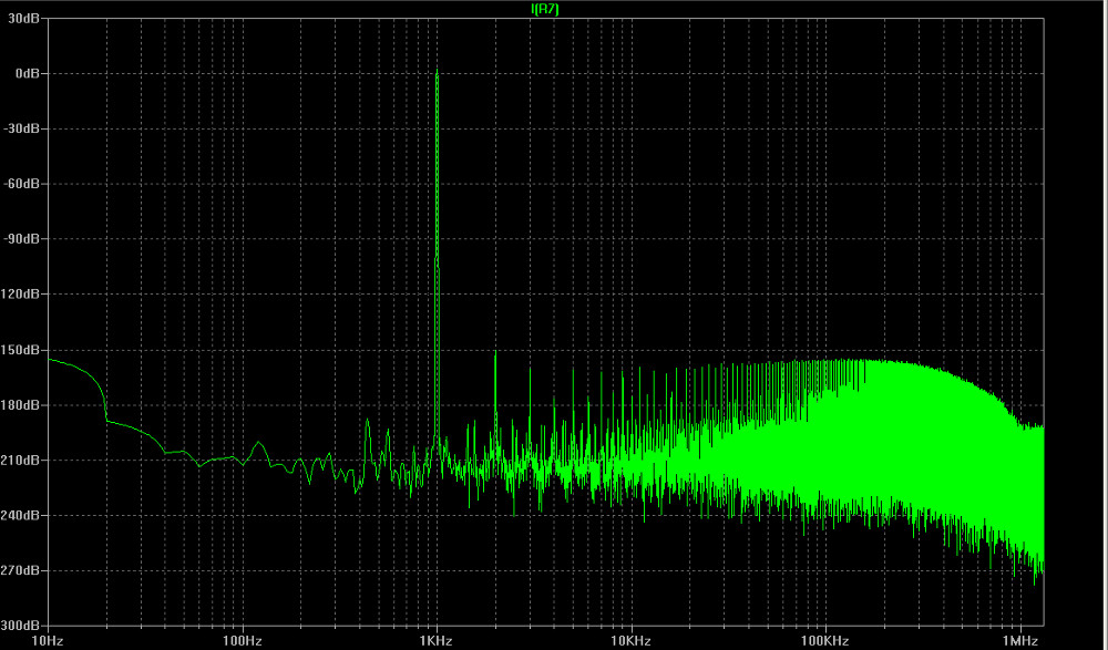

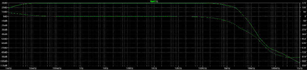

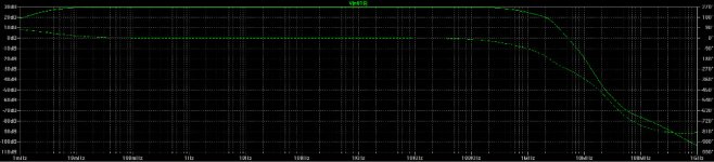

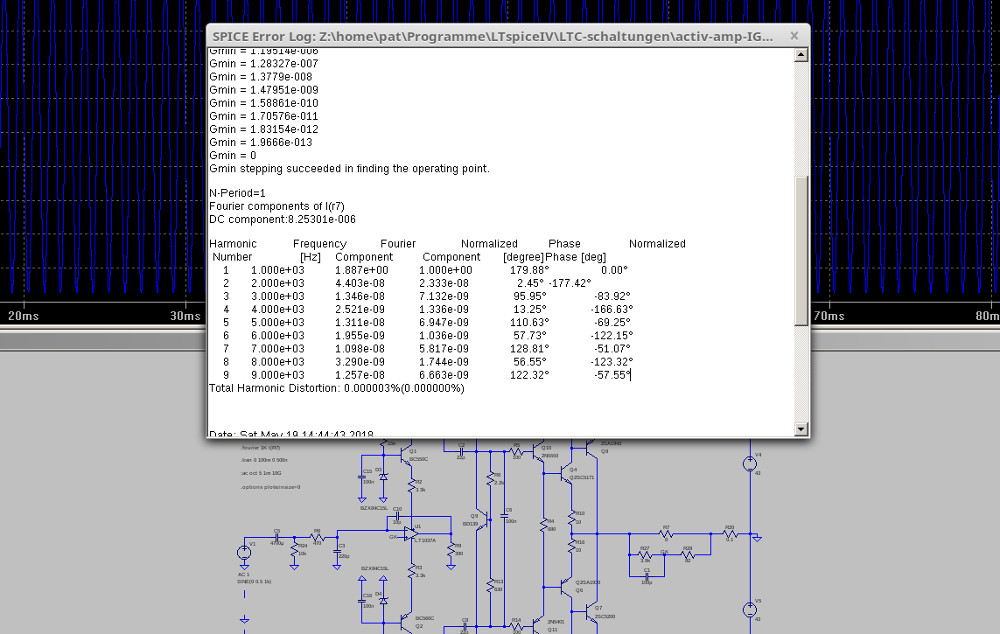

That's an idea for an opamp-powered amplifier with current-driven VAS. The simulated values are not bad, so far.
Especially since the amplifier is operated (simulated) only at 26.2mA total. 5mA for the power transistors.

The 3k3 resistors in the power rails of the opamp look to be a problem. At the nominal quiescent current (2.6mA) they'll be dropping 8.6V each. The opamp will still operate at such reduced supply but its output voltage swing will be severely constrained.
