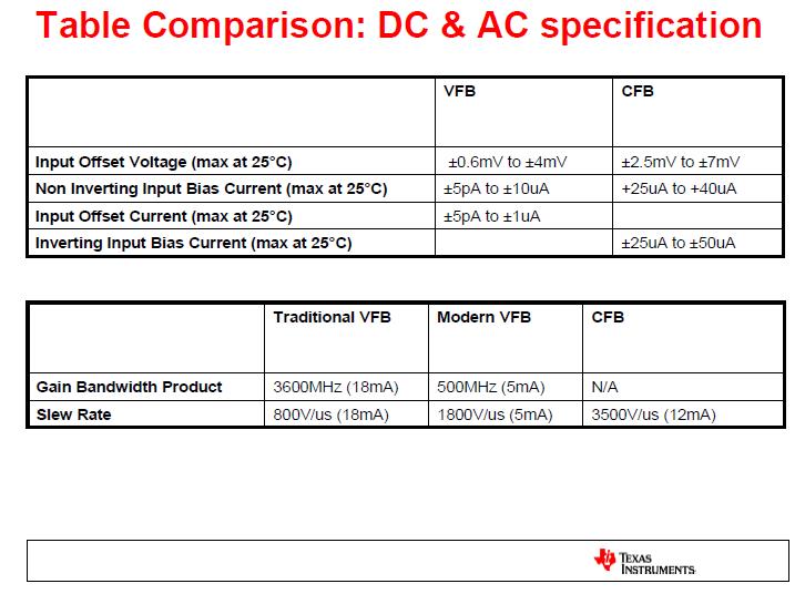

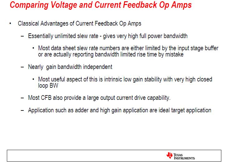

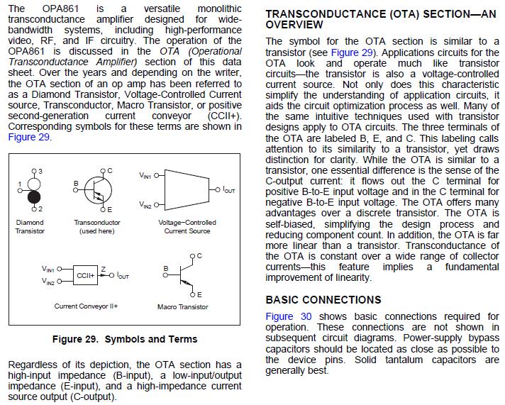

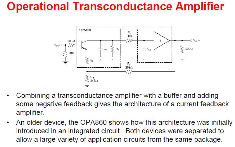

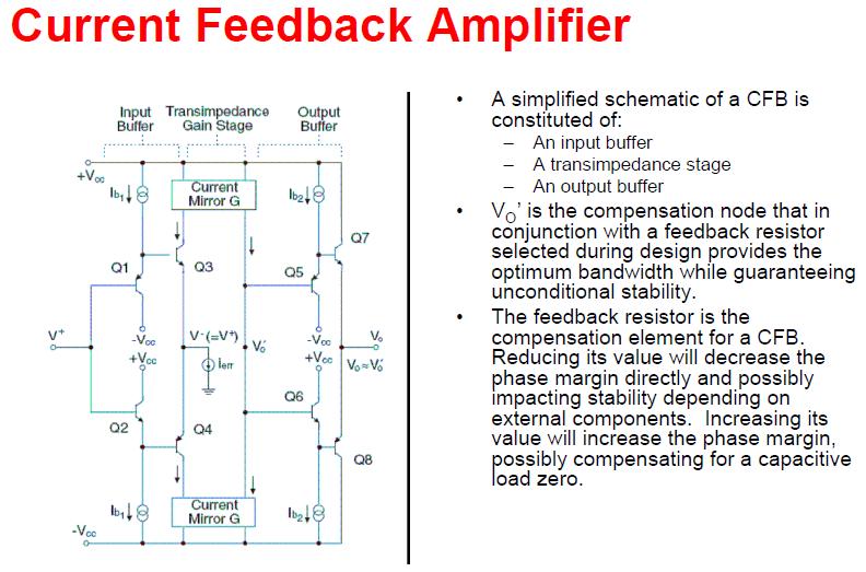

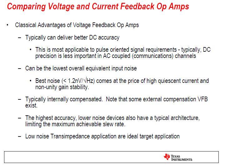

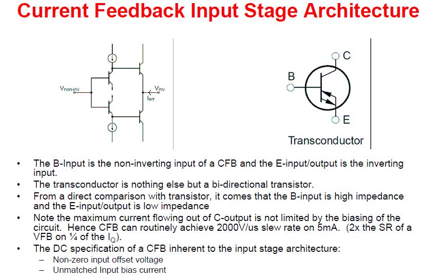

Noticed there was no specific thread for this ...
From TI's informative 2009 Current vs Voltage Feedback presentation (OPA861 pg. 8)
Features:
WideBandwidth OTA(>80Mhz)
900V/usecSlewRate
2.4nV/√HzInputNoiseVoltage
Very Flexible Circuit Building Block
Ideal Complementary Transistor Function
Tuneable Transconductance
Externally settable supply current
http://www.ti.com/lit/ds/symlink/opa861.pdf
http://www.ieee.li/pdf/viewgraphs/current_feedback_vs_voltage_feedback_amplifiers.pdf

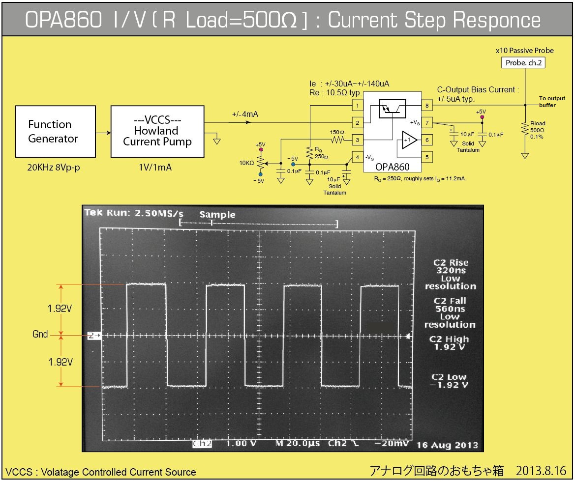

I simmed the OPA861 for PCM179x DACs as sources quite a while ago with a cascoded NJFET-Buffer (LSK389C or BF862 + 4391) that is THD and Noise transparent.
pros:
- simplicity
- very constant input impedance into the 10s of MHzs
- very fast --> clean square response
- nice THD spectrum with clean decay of harmonics
cons (not really, but rather mediocre performance):
- THD-niveau (close to -60dB/0.1% at 0dBfs)
- Noise figures just ok, though depending to a large dgree on the value of the IV-resistor.
It should be noted that DACs with offset currents require a current source or - sink to cancel that offset.
A simple JFET ccs may suffice here as best solution (noisewise) but will inevitably introduce some noise.
In fact it might be the dominant noise source of the whole circuit!

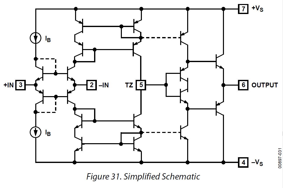

1.
http://www.essex.ac.uk/csee/researc...Current steering transimpedance amplifier.pdf
2.
AD811 as I/V with LM6172 as differential to single-end stage
2.

The transcoductance (current amplifier) with AD811 is better than OPA861, and much better than AD844 (I only ever tried single 844 in diamond buffer config, no feedback, but this had a lot of distortion - too much for my liking, couldn't listen...). The OPA861 sounded better compared to an AD844. The DAC was initially 1541. Once I settled on 811, I implemented the same I/V stage concept to dual differential 1704's (inside heavily modified Denon 1650 CD player) with very good results.
I will probably give stacked 844 a go... just need to find the NOS 1541 DAC that I still have... gathering dust somewhere...
But these days I can't be bothered to look for, and place the CD's inside the player(s) any more... it's iMac and modified W4S DAC2 DSD that keep me happy, and the sound isn't half bad neither.
Nick
Nick
Maybe it was implementation but I had a commercial PCM63 DAC with AD811 output and it was terrible, impossible to keep those from oscillating in that service I think.
