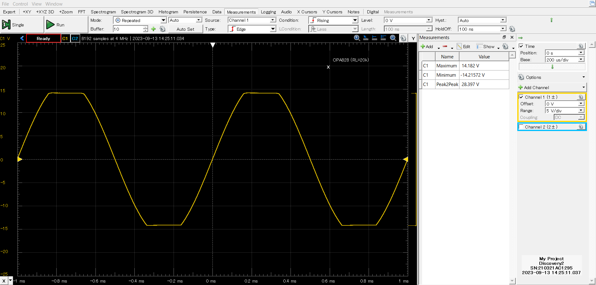

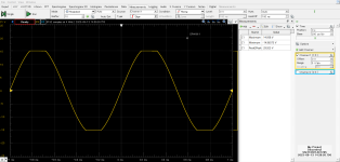

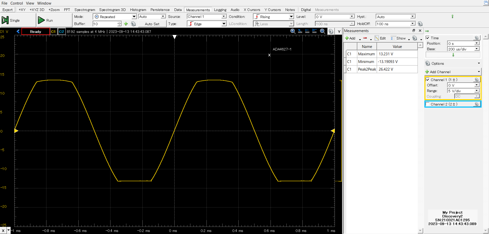

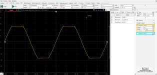

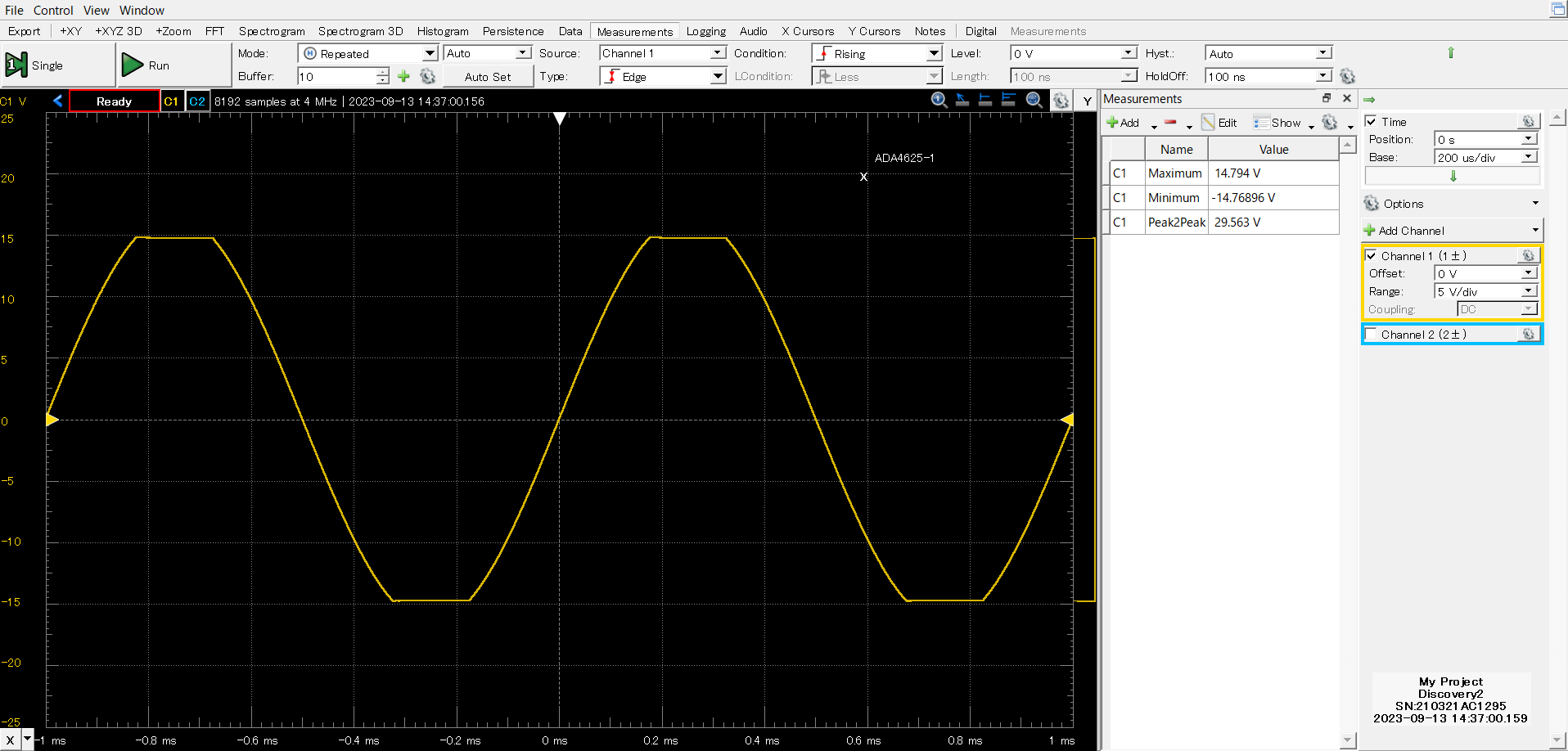

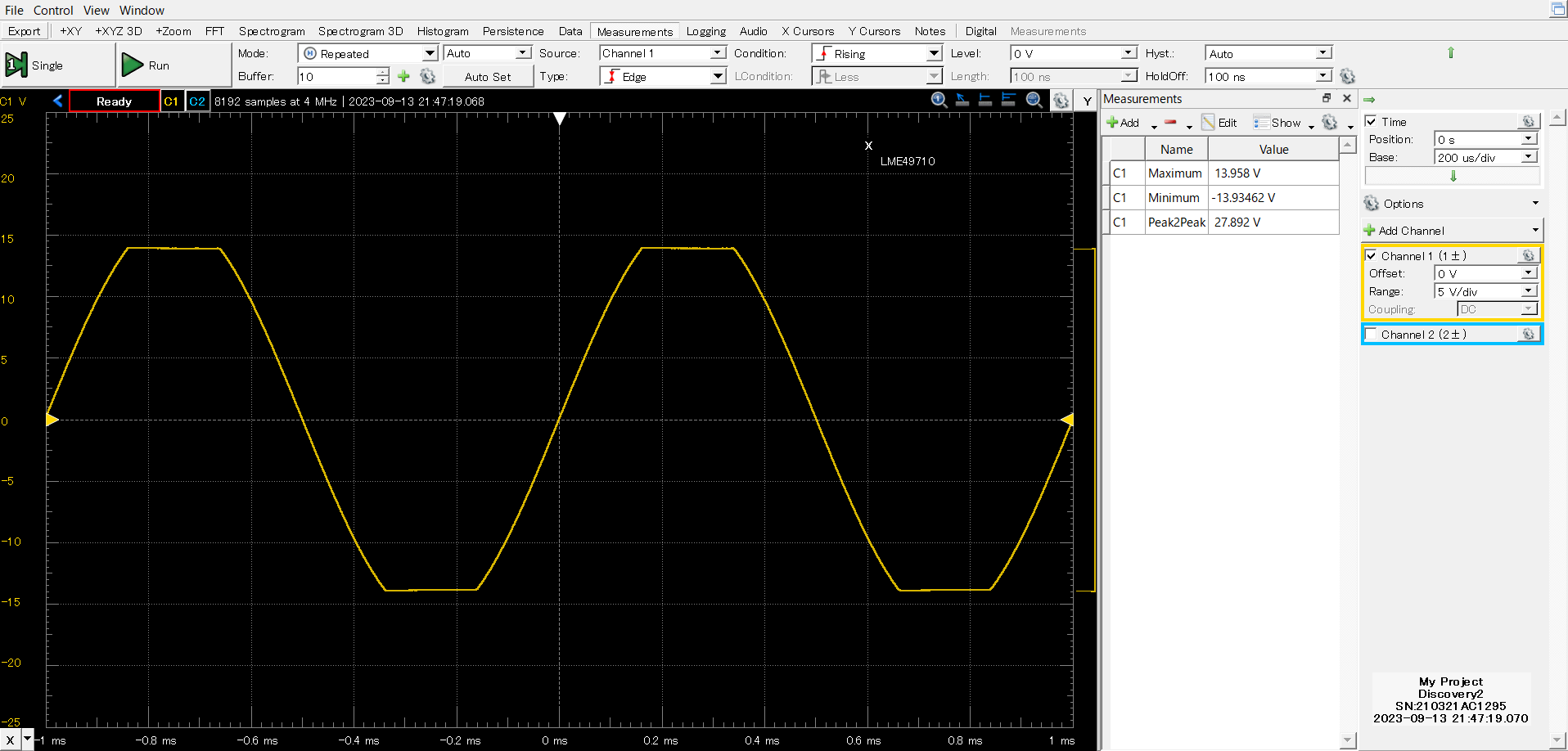

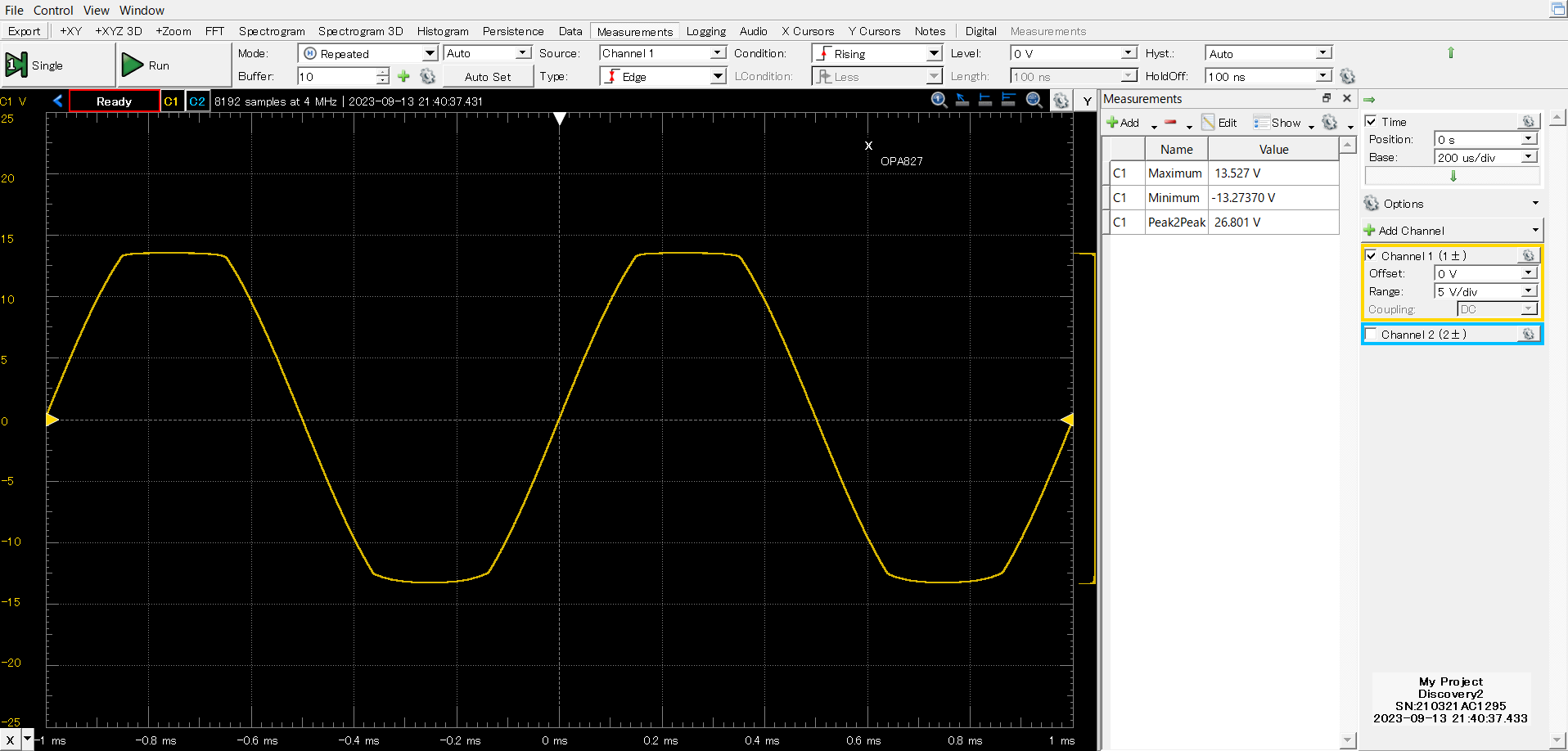

The output of OPA828 is announced as rail-to-rail,
but as I mentioned in post #9,
I thought that was strange for as a rail-to-rail (common emitters) output.
Apparently, OPA828 is not a rail-to-rail output.
The output of OPA828 looks like a typical emitter follower.
I only noticed this after checking RickTH's post here.

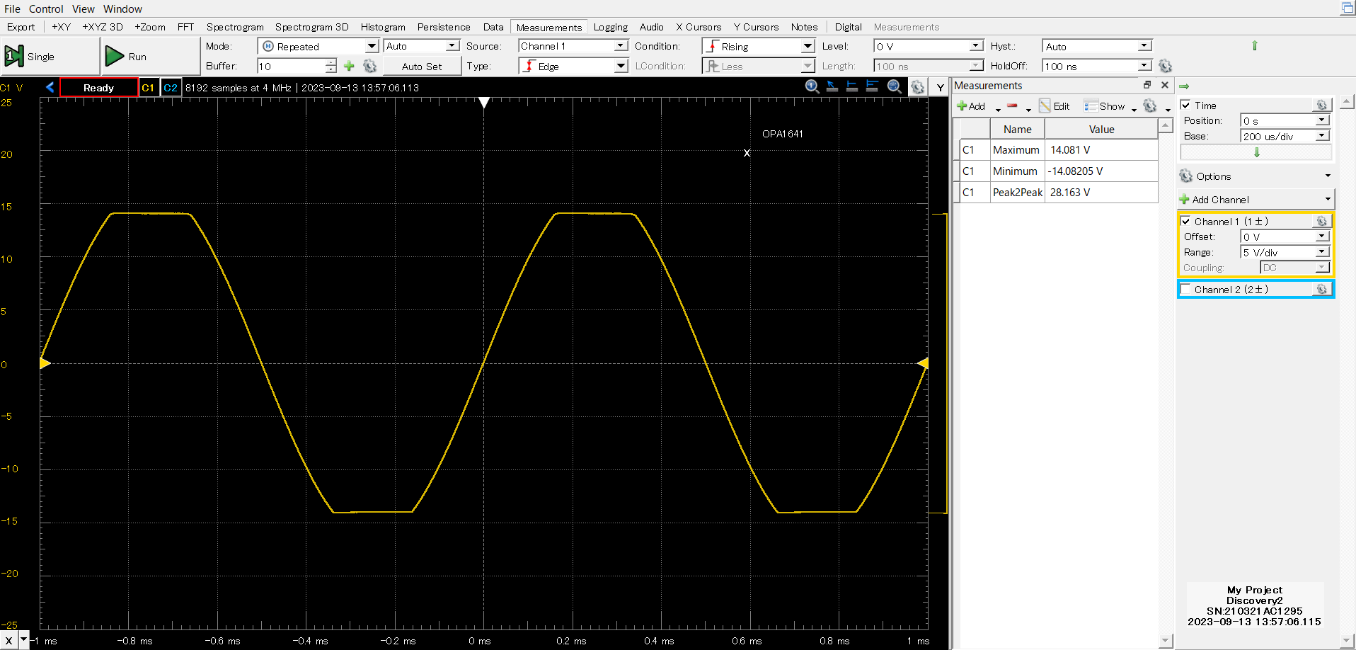

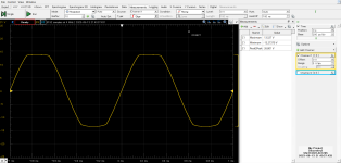

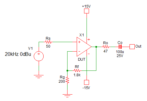

The confirmed circuit is shown in post #4, the input is 1kHz, 1.2Vrms,
To read the output DC level accurately, a probe (1:1, 1MΩ) is applied to the front of the coupling Co. The power supply voltage is adjusted to ±15.0V (±10mV).
It can be seen that the output headroom has a loss of approximately 1V on both positive and negative sides.
Just to be sure, I also tested it with a lighter load (Rf=18kΩ, Rg=2kΩ).
There is almost no change.

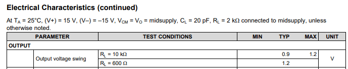

I checked the datasheet again I found the following notation:
Although the wording is not clear, I think it mean the loss voltage of output headroom from the rail voltage.

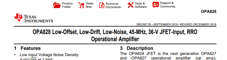

TI may have realized this mistake.
When the datasheet was revised due to the addition of OPA2828, the notation "RRO" was removed.
However, the web page is still marked as "RRO".

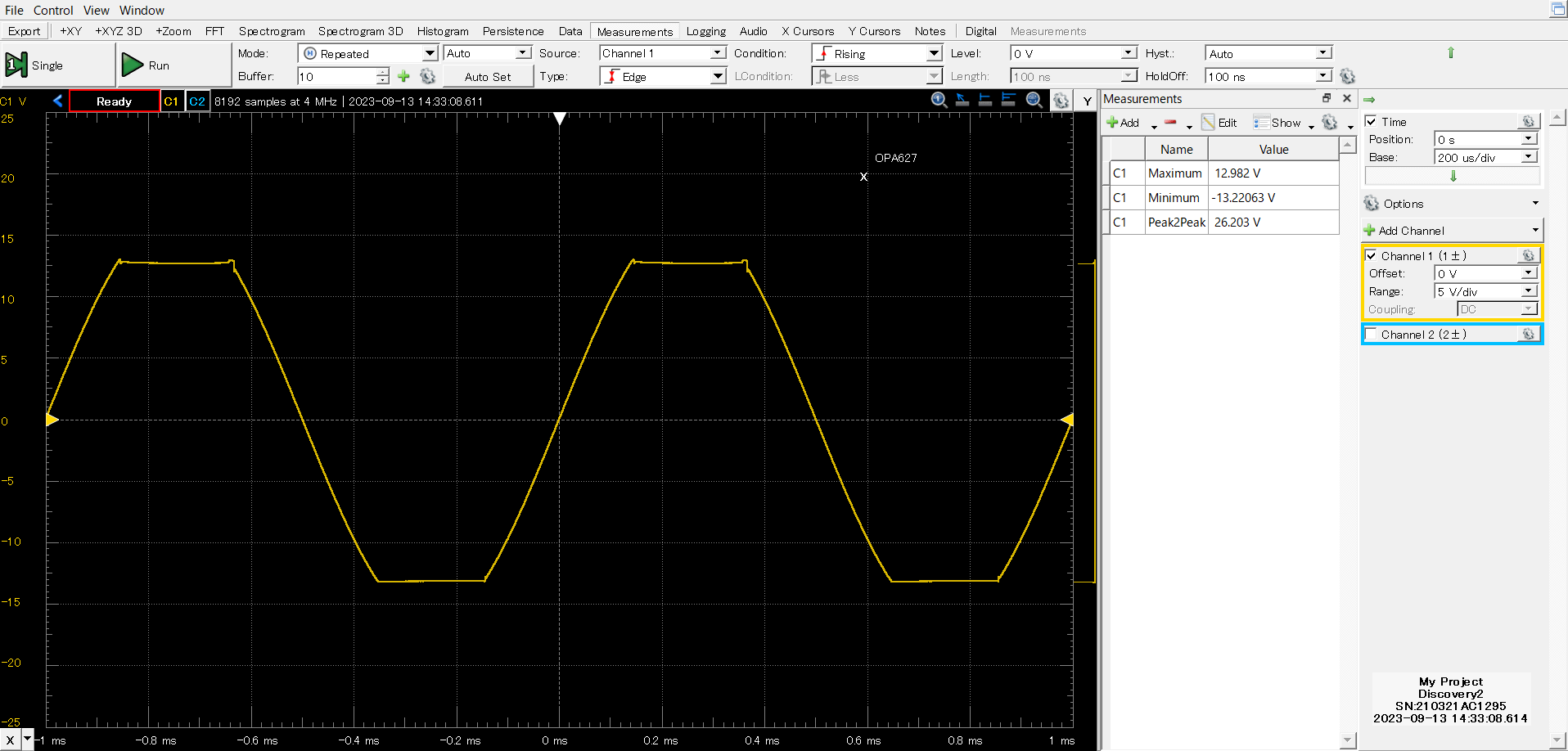

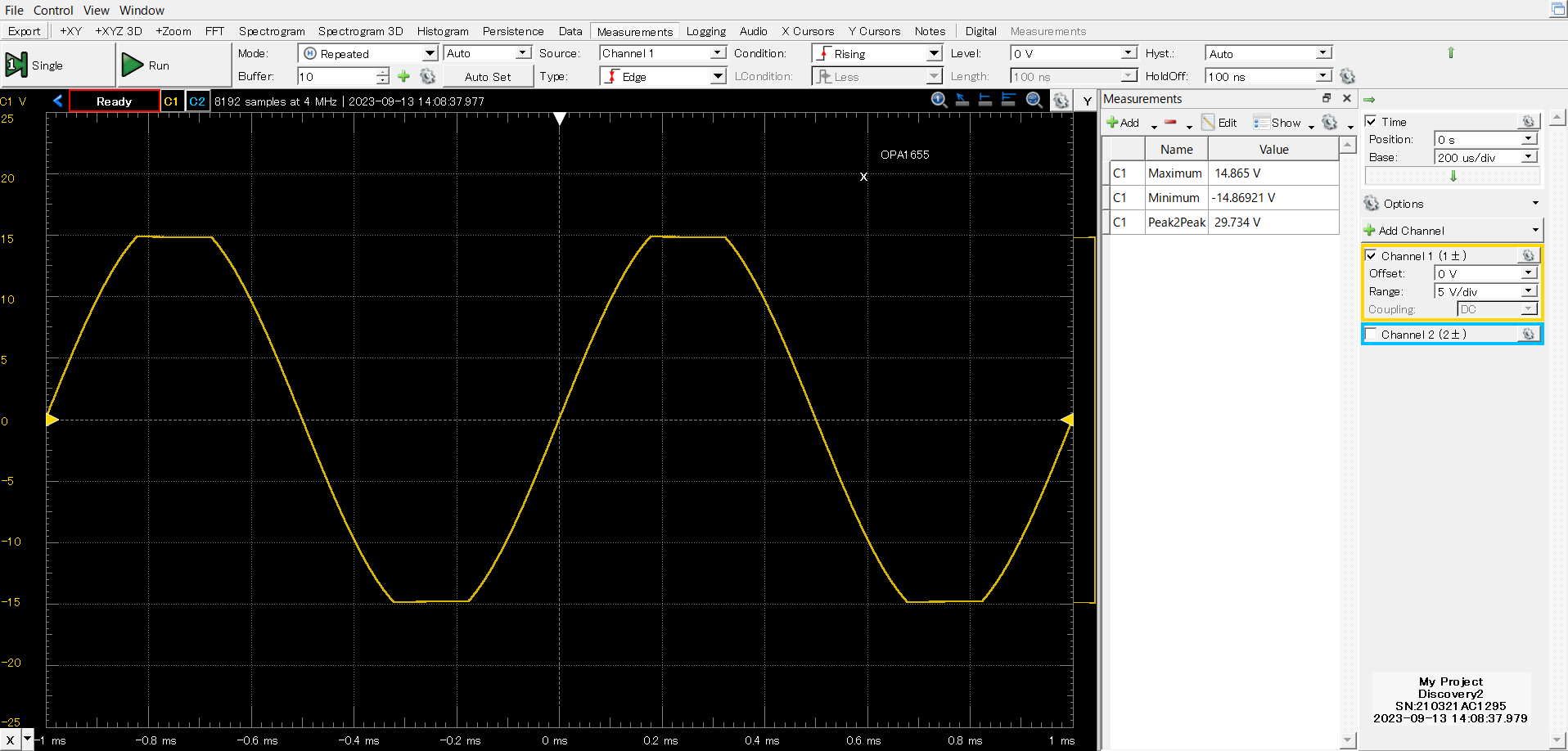

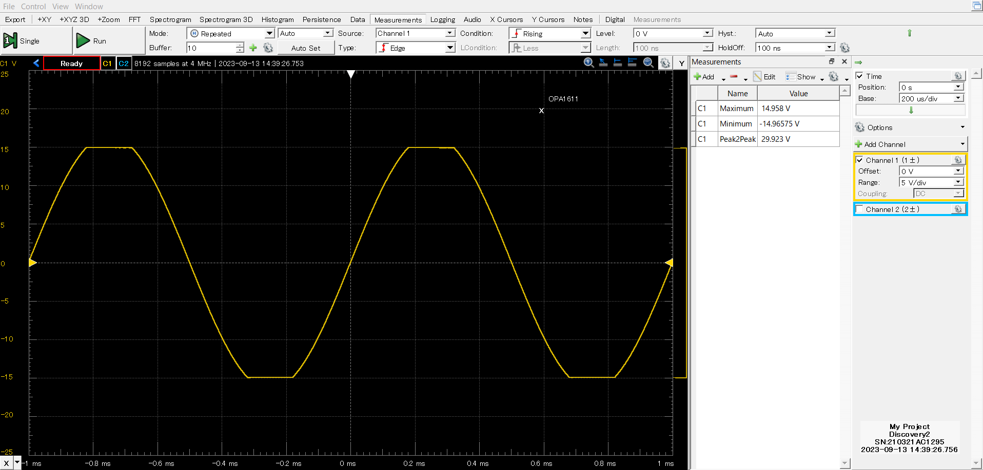

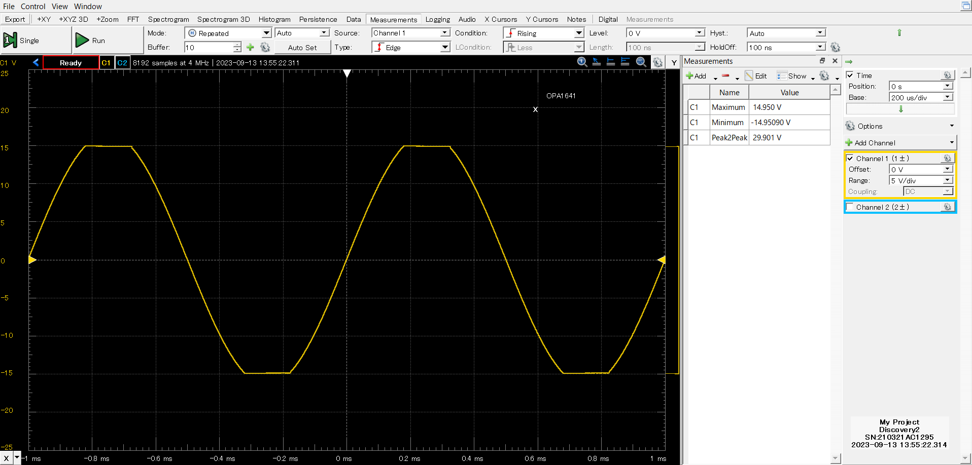

For comparison reference, the waveforms of RRO type OPA1611, 1641, 1655, ADA4625-1, and non-RRO type OPA627, 827, LME49710, ADA4627-1 are attached. (RL is the original 2kΩ.)
Compared to OPA627 and OPA827, OPA828 has improved headroom. However, there is a difference from rail-to-rail OP-AMPs.
I got OPA828 as soon as it was released, loved it, and have been using it for over four years, but I never noticed anything. (lol)
the distortion pattern of OPA828 differs from the rail-to-rail of traditional BB products, and the open-loop output impedance shown in Figure 25 of the datasheet is low and constant over a wide frequency range.Also, the main components of distortion are the low-order components of 3rdHD and 2ndHD.
This point is also different from conventional RtoR output such as OPA1611/1612.
It seems that tombo56 also likes it and uses it, did you notice that?
