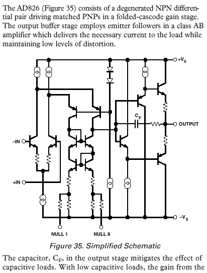

AD826 & AD797 - High Class Bipolar Opamps
which can be considered having Very High performance.
They have actually very much in common
when you look closely at the simplified schematics
that are in the datasheets.
They are bipolar.
They have only 2 stages before the complementary output buffer.
- First stage longtailed NPN pair,
feeding the other stage, which is a Common Base Pair.
In this stage, via a current mirror,
the resulting current is put out to the Buffer.
Only 2 stages and common base - fast opamps.
Compared to for example the interior of NE5534
this is a very simple and beautiful design.
/halojoy - likes AD797 and AD826 (well, not the price)

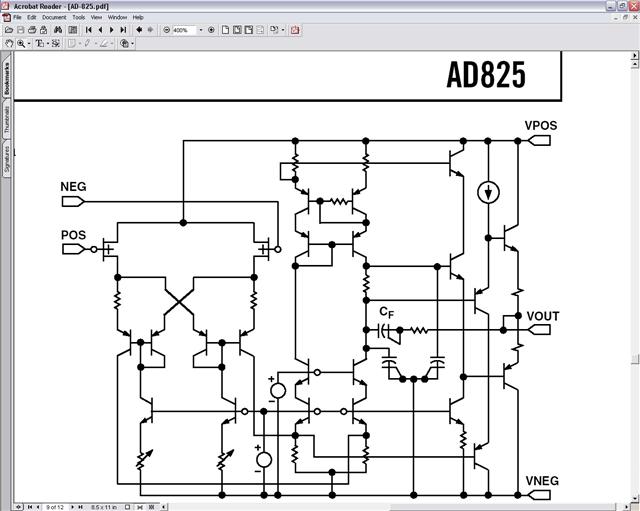

That seems to me to be what the AD-825 except a J-fet rather than BJT input. But that same what is it called Folded cascode? used as the interm stage.
