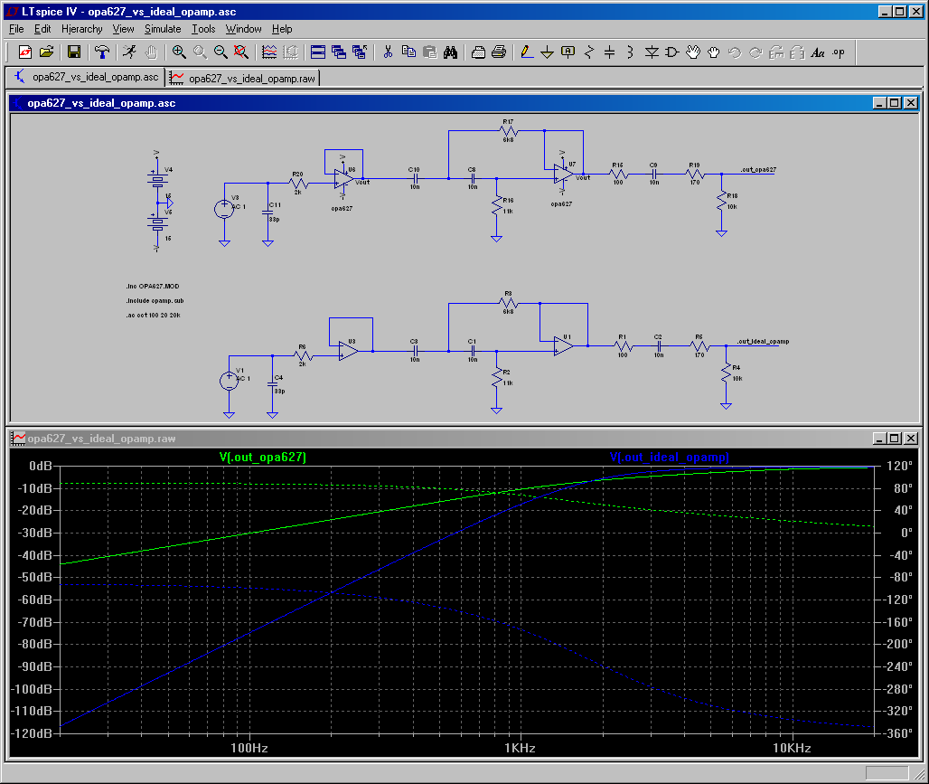

Refer to the attached simulation of a 2nd order high pass filter, the green curve is the result of using the opa627 PSpice model directly downloaded from Texas Instruments today, while the blue curve is the result of using the ideal opamp model.
I can't believe the difference. It is not possible to be that much different. What has gone wrong?
The asc file was created by Keantoken for me a while ago. I think I supplied him the TI downloaded model file, and he digged out a symbol and put it into an asc file for my use. Today I replaced the opa627 model file with the latest version from TI.
The asc file is attached. Unfortunately, I can't attach the MODEL file but you can get it from the TI site.
Bill

Ummm . . . (mustering up my best "Sophomore Electronics Class" instructor's voice) . . . Which result is closest to what you were EXPECTING to see? Is there anything you readily notice about the difference between your expectations, and the simulation results? Do the answers to these questions provide a clue to the error you are looking for?

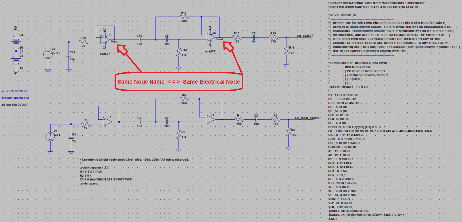

You have a SHORT CIRCUIT between the output of opamp U6 and the output of opamp U7. LENGTHEN IT.
(Probably a careless cut-and-paste error during editing.)
Dale

Dale,
To me :headbash::headbash::headbash:
To you :up::up::up:
Thank you wholeheartedly :worship:
Bill

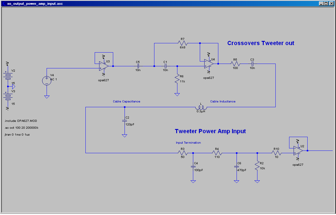

There are more. For an example, I have been wondering how much compensation is needed for a non-inverting gain stage (cap from Vout to -Vin) to achieve the best transient response, i.e. minimal overshoot or undershoot. Could I simply generate some squire waves at 100kHz from the input and check the output? Or perhaps the marcomodel won't give me this level of accuracy and only a scope can provide the answer?
For another example, I would like to know how much isolation resistance is required for capacitive load. Attached is the real (i.e. almost real) circuit I am planning to use. I am learning to design the entire preamp/active crossover, as well as the input stage of the power amp. How would I know if C6 is too big to cause grief to the proceeding opa627, or if C6 can be increased to provide better RF noise suppression for the power amp, as the low pass corner frequency is really too high at the moment?
Of course, I wouldn't expect you to write a book for this lesson but if you could in the briefest way point me in the right direction that would be very much appreciated.

For another example, I would like to know how much isolation resistance is required for capacitive load. Attached is the real (i.e. almost real) circuit I am planning to use. I am learning to design the entire preamp/active crossover, as well as the input stage of the power amp. How would I know if C6 is too big to cause grief to the proceeding opa627, or if C6 can be increased . . .
Many opamp data sheets give good guidelines on this. (The OPA627 data sheet seems to suggest that 20 ohms is adequate. See Fig 6.) TI App Note SLOA013A discusses this with greater theoretical analysis in Section 6.

Dale,
Your posts have been very much appreciated. For capacitance at the input or output of an opamp, I think I can follow the TI App Note SLOA013A closely. I should be able to get good result by doing that without relying on simulations. For the rest, it is always a good idea to use the macromodel, feed the opamp with maximum input voltage at the highest possible frequencies the opamps needs to deal with, and with fast rise time and check the results.
