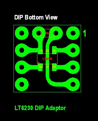

I tried the OPA627 in my Meridian 508 to replace the original NE5532s, and they worked at +/-5V. There was improvement, but the OPA627 really wants the full +/- 15V to give best performance. I am now using LT6230, which is happy at +/-5V. In fact there is a whole lot of low-voltage of opamps to choose from these days, like the ADA4841, TS971, etc.
You will need to make a small adaptor board yourself.
