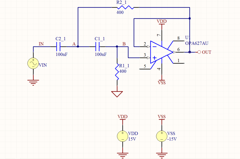

I am trying to design a HPF using the OPA627 op-amp.
I have simulated the design in Protel and ran simulation, however I am getting some weird results. (or so I think).
My HPF is supposed to be a 4kHz HPF.
The schematic & simulation plot is attached!
From my understanding of filters, the crossover point should be the -3dB point, right?
From the plots the -3db point is CROSSOVER/2 or 2kHz.
Also at the 4kHz point, the attenuation is -6dB.
Why is that?

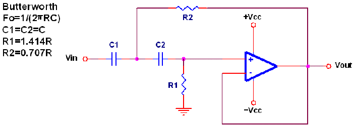

I guess you are trying to build a 2nd order Butterworth HP. Then you should double the value of some resistors and capacitors - can never remember which ones but you can either do the math or just look it up on any site. The Texas Instruments (http://www.ti.com) site has a Filter Wizard that relieves you of the work.
For most filter characteristics the cutoff point is specified as the -3 dB point. Not so for Linkwitz-Riley (two cascaded Butterworth stages, hence the name Butterworth-squared) where it is at -6 dB.
/Magnus

Ok, so lets say I go with a LR x-over.
Does that mean that if I wanted a x-over at 4kHz I should actually design the filter for a 8kHz crossover, therefore the 4kHz point happens at -3dB rather than -6dB?
Also, has anyone used UAF42, the TI Active Filter?
No, you should design the filter for 4 kHz. That is, calculate the components for a 4 kHz 2nd order Butterworth filter. Then you connect two of them in series to achieve the 4th order LR filter. The same goes for both LP and HP sections.
Now, both LP and HP filters will be down -6 dB at the crossover frequency of 4 kHz. That means that their output voltage is down to 0.5 of the input voltage which nicely sums up to 1.
Would you have used 4th order Butterworth's instead their output voltage would have been 1/sqrt(2) which sums up to sqrt(2) or a 3 dB bump in overall response. You can very easily simulate all of this in PSpice or LTSpice or whatever you prefer and play around with the component values to see what is happening with the frequency and phase response.

This filters is right but the Q factor is at 0.5 for -6dB @4KHz.
If you want to transform it into a Butterworth (if you need so...) have the feddback resistor at 280R and the input one at 562.
You will end up at -3dB at 4KHz.
By the way did you think to use a pair of 0.1uf for PS bypassing?
