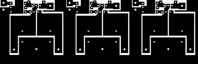

Well, I have been busy building 10 channels of OPA548 gainclone for a friend over the past week or so, and as I had to make so many I made a single sided pcb layout to make it easier!
So, for all those that are interested the PCB layout is below, scale is based on 1" squares, so it should by easy to rescale to whatever output you want. The circuit is based on Thorsten's new ideas, and is not minimal! As I live in an area of huge RF interference from two of the biggest TV/Radio transmitters in the UK, I have given up on the minimal designs, but if you wish you could just use wire links instead of some components. You may also need to slightly adapt the design depending on the size of your components.
The circuit layout is completely hum free and stable, with no oscillations I can detect on my 5meg scope.
Note, the E/S pin(9) is snipped off the IC before installation!
Have fun

Hi Popes
Looking good! Certainly much quicker and more economical to home etch
The only problem you will have is with the Earths. The three up board will definately need the ground plane splitting so you have one per amp, and you may need to split the signal earths to make a star ground as I did on my version. The only way to find out is to build one!
Good luck
Good luck

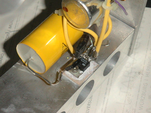

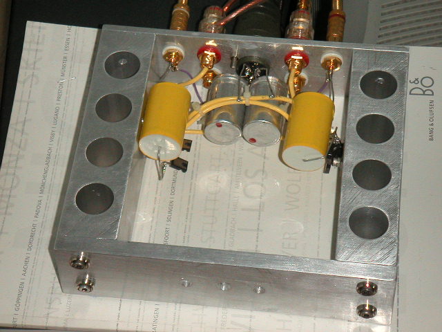

Re: my 548 pic.
How is the sound?
I am planning to build one with an opa548 or opa541.
popes said:i'm aready make 548clone
here is my..
inverted
R=caddok 10K and IRC 200K
C=10uF MKP
power supply is two single output SMPS 20V 5AMP.
How is the sound?
