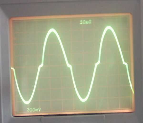

I agree, with your scope readings (notice those notches - current limiting I think).

till said:supply +- 25V
sine wave 1kHz in,
2,83V output in 10Ohm
excuse bad camera quality:
The notches you see are the classical xover distortion, meaning the bias is too low. But anyway, if you see this sine wave when driving your speaker, it is not distorting a lot, and unless you are trained in recognizing THD, this should sound perfectly OK.
Again, try to scope with the speaker connected, try a couple of frequencies, if they look reeasonably OK, than it might be something with the preamp or whatever. You use a coupling cap, and the 1MOhm to ground as in the app note?

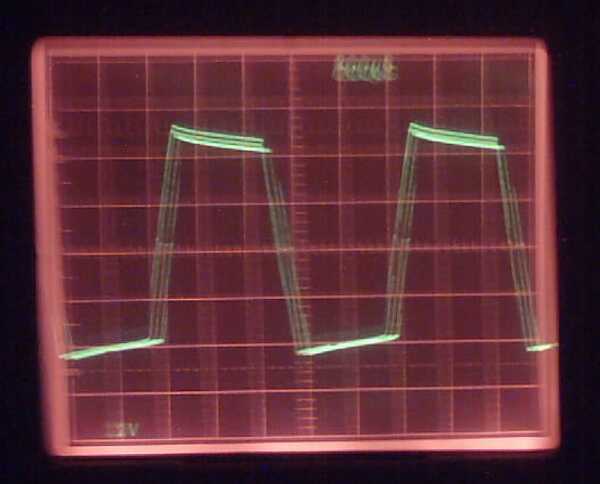

I don´t know the circuit Shoog used.
I build a circuit for measurement flying wired, without input cap, but with a bipolar cap between amp and speakers (no so good idea to blow some 1000€ speakers ...) No 1MOhm.
Inverting, input 10 K, feedback 180K.
The main pupose of the scope measuremt for me was to prove the high THD at 16V + is the amp is clipping.

Yes Till, this is about worst case (20kHz), and apparently you have some noise and/or hum. But even so this should not "distort as hell".
Shoog, I see no reason to blame it on the chip. You really should solve this, because with another chip you may have the same problem. Do you have a scope?

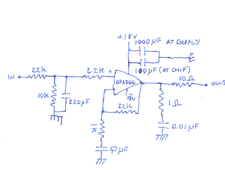

I will draw up a circuit for posting, but I don't believe it will enlighten enyone as it all standard opamp stuff as per the spec.

Shoog,
A couple of points. The figure with the voltage spikes in your referenced site is misleading. The mechanism described is correct, but any reasonable amp has a very small output impedance. That will take care of the spike energy, you will not see it on the output line. ANY amplifier has to cope with it, but it should be noted that this is only as big a problem as it looks with really very complex xover circuits & speakers.
I don't buy the current limit story; why should there be current limiting in normal use (as you do I understand). There is xover distortion, we have seen that, but unless your ears are asa sensitive as a cat's, it'll not sound "distorted as hell". (Still don't know how that sounds, any description?).
On your drawing (sure this is the amp as built, right? you didn't copy it from the data sheet?): doesn't show a supply cap at -18V. This may cause oscillation. Does show a 10 Ohm output resistor. That needs to go, of course. (Unless this is meant as the load, and you mean to ground the right side that says "output").
At the input you attenuate the input signal by 3. This may or may not be intentiaonally.
Again, when it distorts, what is the outp[ut level, load resistance, frequency? Or does it distort with music only? Is the distortion depending on the level?

The negitive supply line is filtered as per the positive supply line (omitted on drawing because of space). The input is through a 3uf cap before the voltage divider. The 10ohm resistor was the only way to tame the "distortion from hell" to a listenable level.
This chip does distort, I am not certain exactly what form that distortion takes.
The chip has an input sensativity of 0.7V so a 1/3 divider is correct. My circuit is not the problem because it is as per the datasheet.
