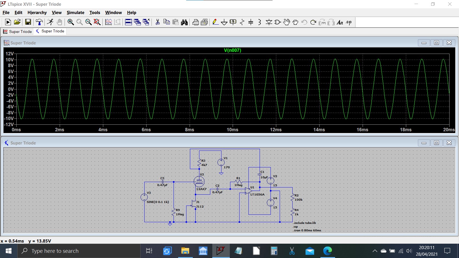

Its an intriguing circuit. So intriguing I simulated it.
The opamp must still follow the rules, i.e the output does what is needed to make the difference between the inputs equal zero.
Working backwards, with 100mv applied to the input I get 10 volts at the output and with 180 degree phase shift.
So the circuit has a gain in my test of -100. That implies the transconductance if that is the right word via the valve must be 'equal' to 10k
The gain looks to be hugely dependent then on the valve characteristic itself?
The 1meg feedback resistor effects gain. I tried 500k and 100k and got 9 volt and 3 volt peak output. The 1meg gives 10 volts peak. So not linear as you might expect.
That's as far as I got for tonight 🙂

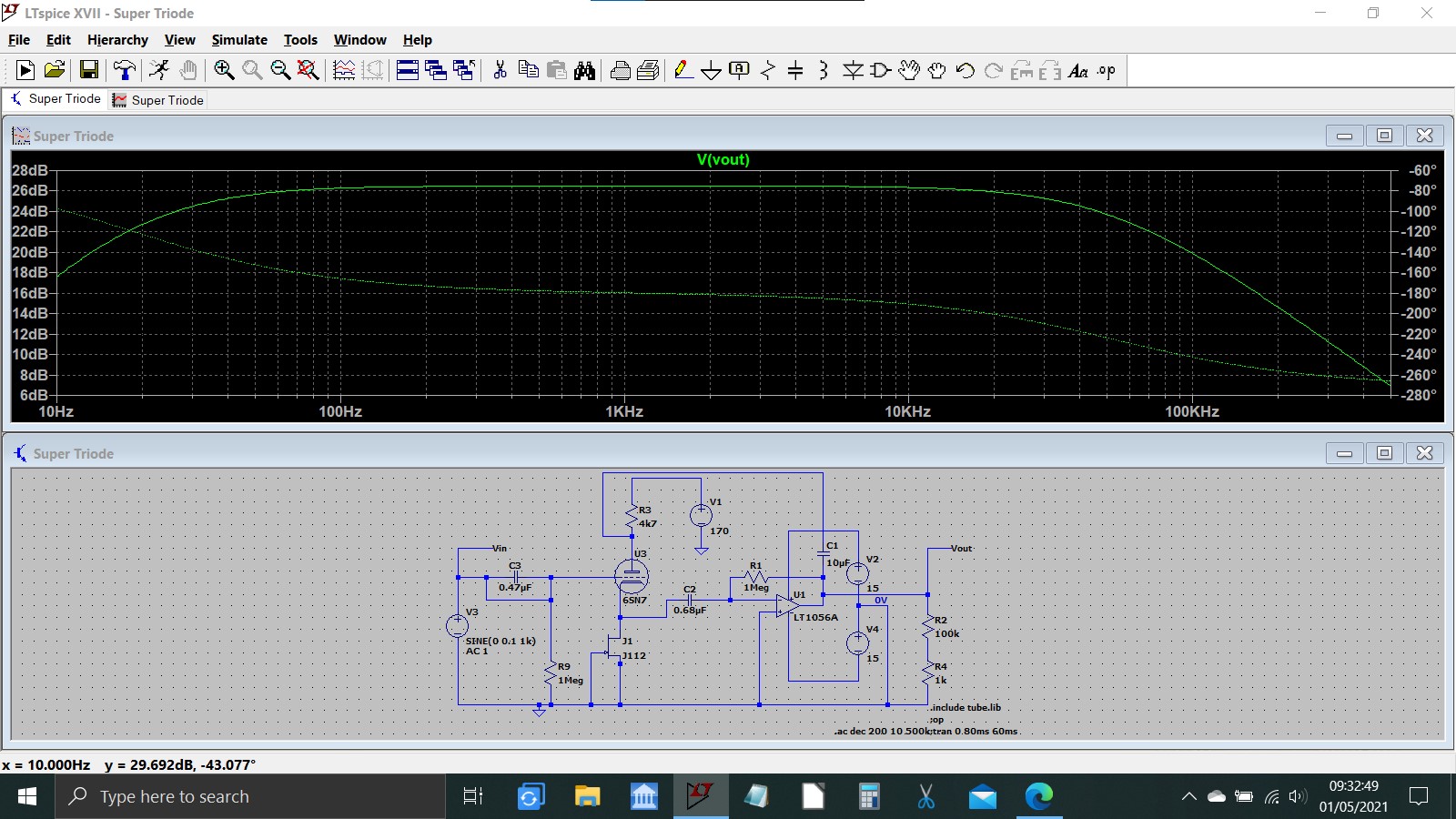

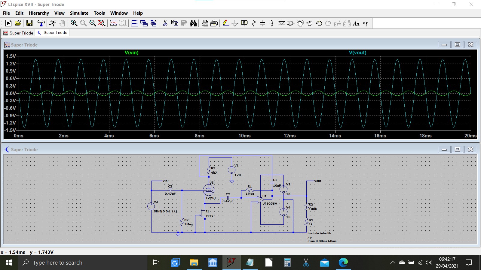

So lets try a different bottle. Here is a 12AU7. The voltage gain now is just 14.

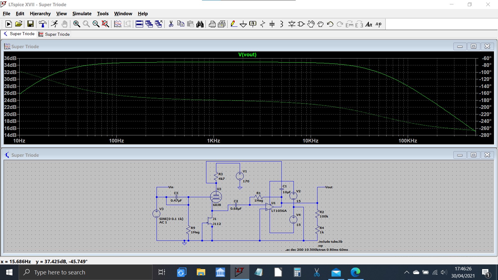

"This amplifier's gain will equal the 6DJ8's mu of 33. Moreover, the 6DJ8 will leave its imprint on the solid-state power amplifier's output, which is what super-triode amplifiers are all about. The output impedance proves amazingly low." (More Super-Triode Amplifiers)
I've got one of those (models). Lets see.
So the voltage gain comes out at around 55. That sounds pretty close in simulation land to your 33 but I would worry how repeatable a real design would be between different valves.

This is a plot of gain using a 6DJ8 model and with the same value coupling caps as in the original post. Midband voltage gain here is 35db or approx '56' numerically.

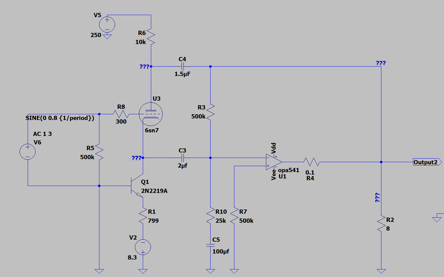

If anybody wants to play with this idea and circuit in LTSpice, here it is.
Just as with any real world tube circuits, it will take a little bit time for U3, an indirect heated triode 6sn7 to warm up.
Before that, r3, r10 and c5 serve a feedback network to prevent u1 opa541 going crazy.
After U3 warmed up, almost all audio signal will pass thru u3, c3, u1, r4, c4 back to u3 to complete a feedback network w/vacuum tube. And hence, output audio shall be signal being mostly orchestrated by a triode, supposedly.
For the case of v2, it should be a 6.3V filament AC transformer winding being rectified by full bridge semiconductor diodes and filtered by adequate electrolytic capacitors. So, the negative voltage is -8.3V.
Q1 + R1 + V2 make a stable 9.5mA CCS as U3's bias, in which U3, as a triode, works best with a fixed load and a constant current sink. (Triode also works
with Constant current source and fixed bais, FYI)
