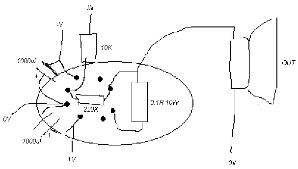

i made the bridged and parrelleled circuit last night (at last 🙂) and powered it up with +/-5v, as +/-4v is the lowest the chip will work with, and didnt want to damage anything if i had made a mistke.
powered it up, my 1A power supply overloaded (light came on), so i switched it off, re-checked every connection, all fine. re-power it up, still overload, shut it off again.
leaft the room, and had a cup of coffee. came back in, checked pin layout and circuit diagram of OPA541 and DRV134 (or is it DVR?), anyway, i noticed that i had missed the 'top view' on the OPA541 pinout. so i had connected the +v and -v connections backwards, and, less important, the + and - input backwards. doh!
desoldered all components, and started again. double checked all components, and again powered it up with +/-5v, nothing, no load, no output. i touched the input, no output (on my working gainclone i get buzz if i touch the input pin).
checked the speaker, i had blown it the first time 🙁, got a new speaker, conected it, powered it up again, still nothing. i disconceted power and the speaker and check voltages at the output, now +5v on both outputs.
very iritating, could the chips be blown? with +/-5v? i may have accidentally turned the power supply up to +/-15v as when i came to power it up the second time, it was set to this.
thanks for any help, below i have posted a picture of my layout, sorry, it is very quick and messy, i am not on my own computer so i do not have images here.
oops, forgot, view is from below of chip,as i have them mounted on a heatsink and all i can see is the leads.

From my experience the chip is fried.. I too missed the darn "top view" resulting in a dead chip
pricy mistake...
is there any other response? is there any way i can check the chips? or should i just order some more?
I find that they are quite sensitive to ps mistakes and not only despite all those protection circuits.I must have burned 2-3 OPA 549 mainly from simple mistakes like yours.The other day I was just switching my pre on and off with a low vol and even though there was no thumps on the speakers I managed to burn another opa.Beats me why.Just change them , wire them up correctly and all will be well.No use trying to "pick up the pieces" here.

Just btw.: Never touch the input pin (at least with no load connected). It will result in instant oscillations (which may be unhearable). And if you do not have a Zobel connected to output, you can damage the amp permanently (if you have a Zobel, the Zobel resistor will get very hot, probably melt).
I speak of experience, at least with P3A, and R. Elliot confirmed that this is the case with every amplifier which has no decent protection circuitry (and I find all internal protection circuits in ICAmps somewhat lacking, none has really protected me from faults, so far...)

what more is there to say... hmmm... next time read carefully... and don't waste samples...
Re: Re: OPA541 blown?
i have no zobel and havemt heard any damage by touching the input, ill stop doing it anyway. 🙄
back to soldering, luckily i have 4 more chips to have another try, as i was going to make 2 channels. ill order more for the second and maybe some extra incase i blow these 🙁
