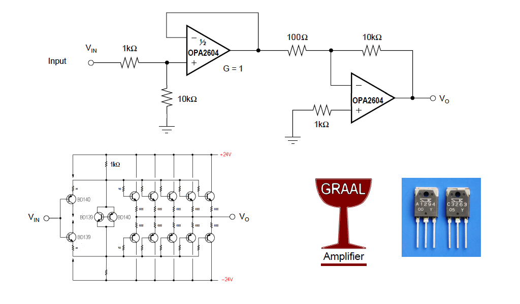

opa2604 inverting input
the quality of an amplifier condenses on all for direct feedback
the correct ratio is 1 to 100 (40dB)
so to drive this value (100R) need a buffer 🙄
