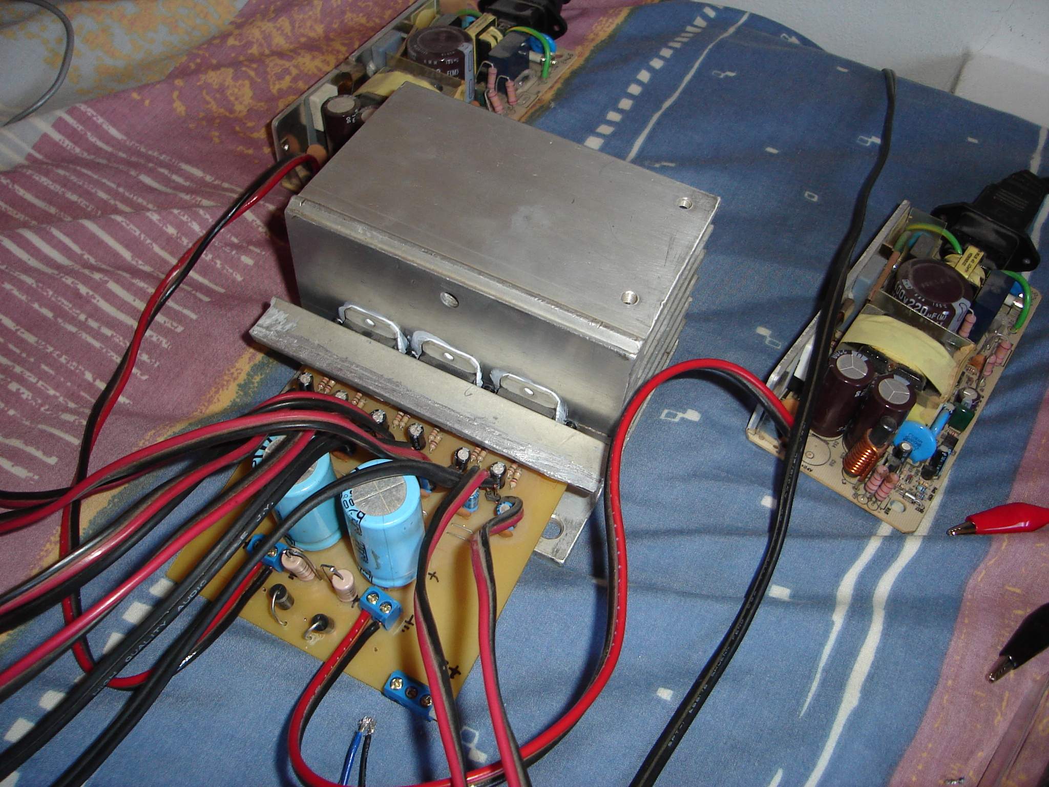

OPA2544 why not?, lets try!!
Fired it up... it sounds OK, not good, not particularly bad... but not wonderfull... certainly very strong output... ideal for those with hearing damage or those who would like to have hearing damage...
I will when I get the time again play around with gain, maybe I find a sweetspot... lots of bass, lots of treble... hollow spot in the midrange... and DC offset is also quite high, about 115mV
Otherwise I will recycle the chips into power supplies.

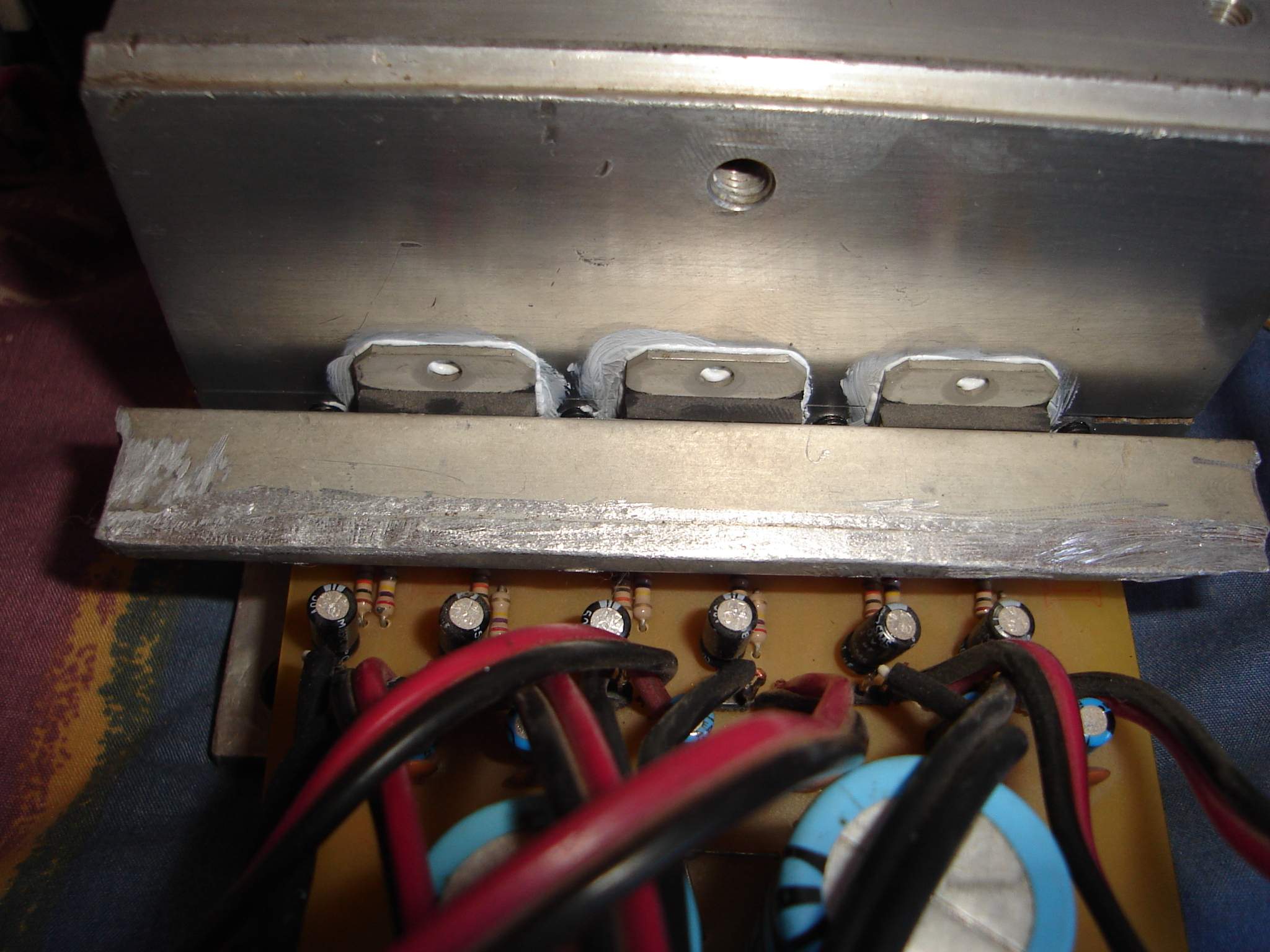

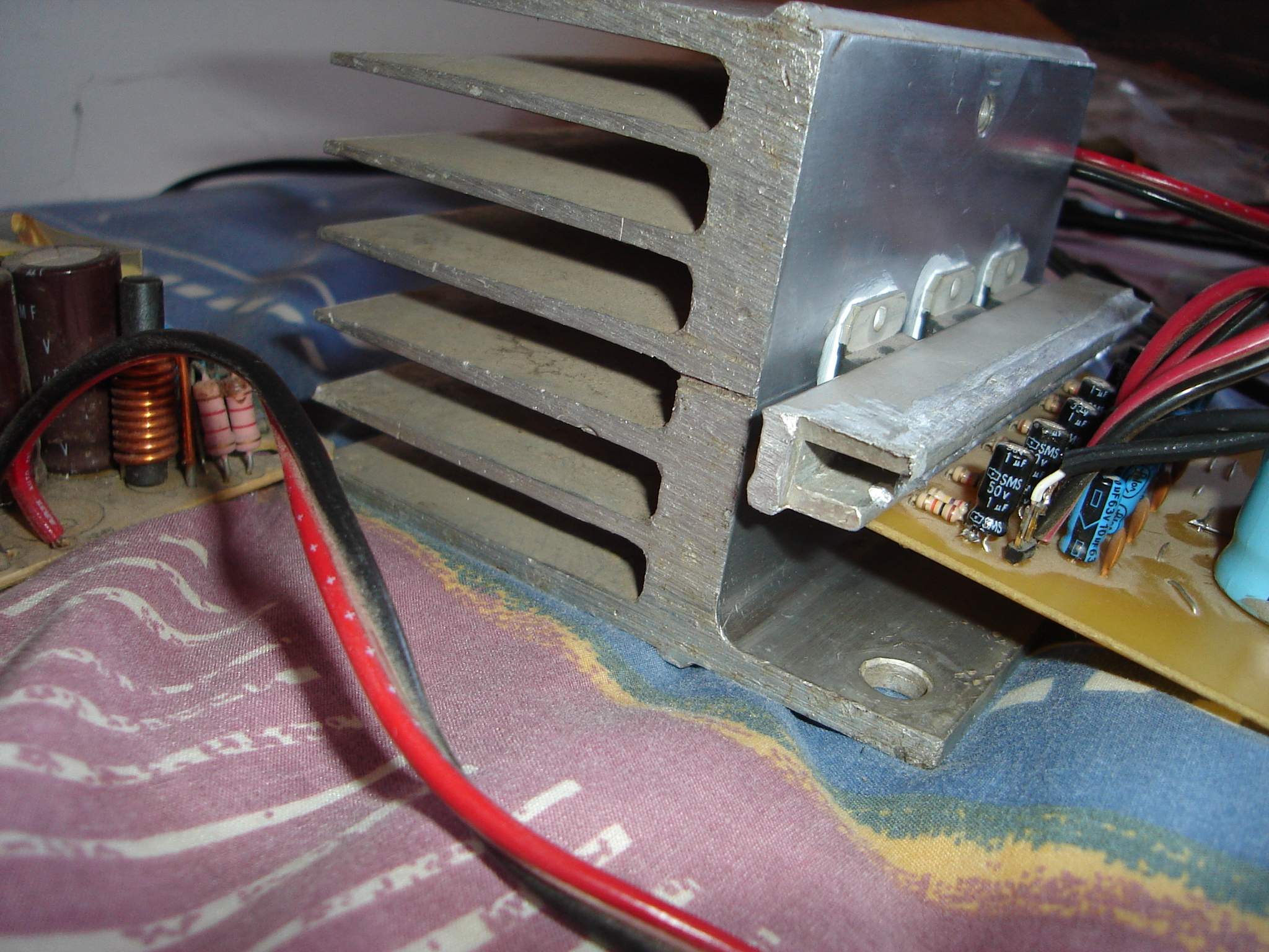

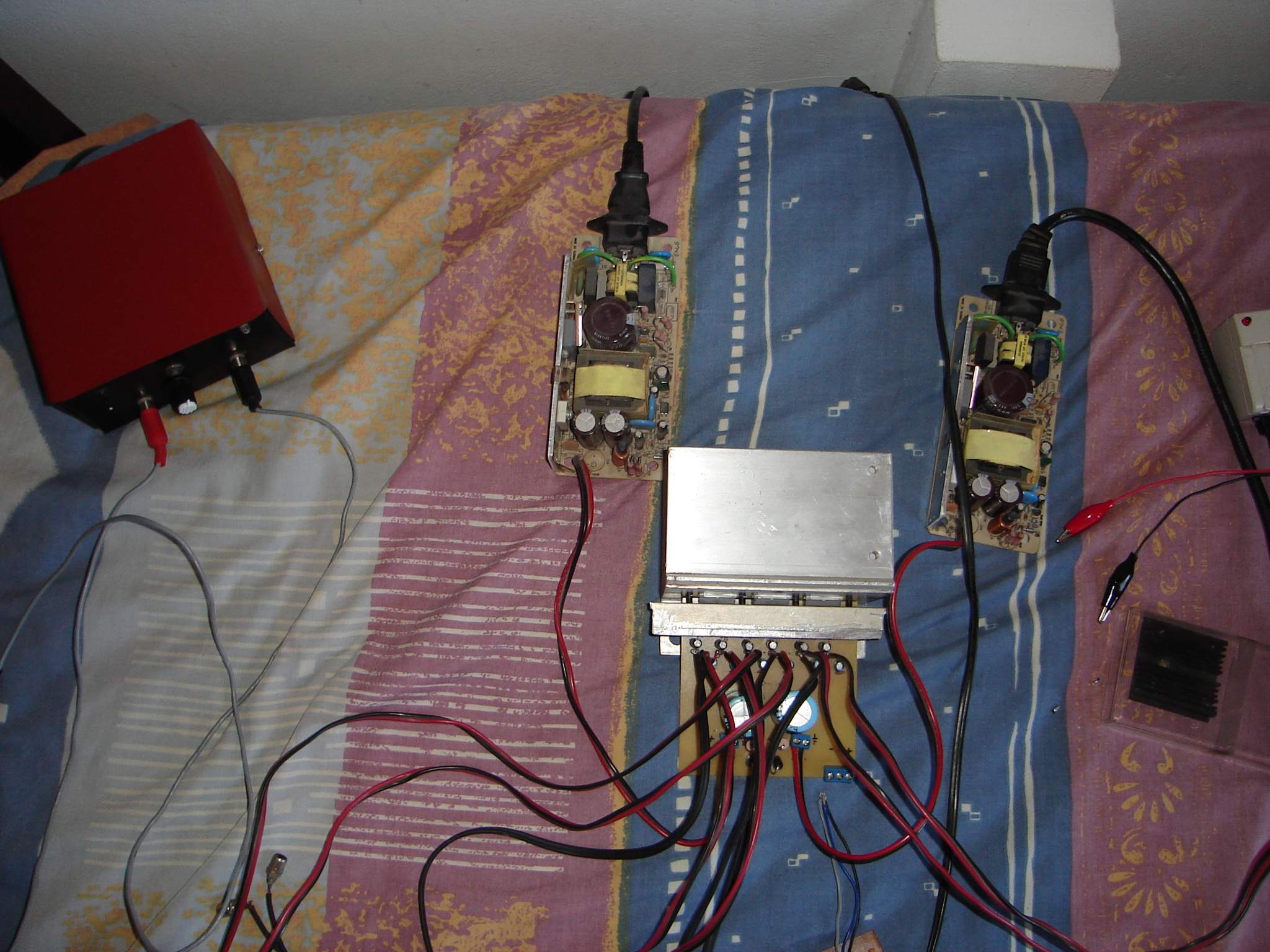

Yes it does, it can be bridged, but high loads are recommended....
Last year I took the time to test it with a scope at uni....I've left it for a long time; and since I was needing a 6 channel amp I finished it and wanted to know If what every one was saying here was true....sadly it was...beyond 250Hz the chips starts to have a cross over distrotion....quite visible on the scope, but it's not that much audible, I don't recommend it if you are seeking high quality.
It's not all sad story here....the chip delivered 100W onto an 8 ohm load without getting hot like an LM3886 for example at 70W. I recommend it for subwoofer aplications since the signal does not suffer any distortion up to 250Hz and the chip works really cool, and has a really low quiscent current
Here are some pics of the 3 chips on the heatsink and the two swiching supplies feeding the little beast !!
