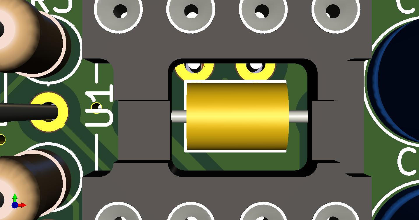

DIL opamps don't have a GND pin so if you want to be compatible with an existing socket on an existing board created by someone else, you won't find a pin connected to GND.
I routine decouple opamps with a cap between Vcc and Vee. I do not want to decouple to ground as that can work both ways - introduce gnd junk back into the circuit.
I normally use SOIC to DIL adapters with a single 1206 1u/50V decoupling cap on the bottom side. Never had any oscillation issues from it.

I normally put the decoupling cap at the back side of the PCB, between the opamp pins. Keep leads short, that's important too.

If you don't have a ground plane layer, it's probably the best way. With sockets, what else can you do?
When using a SMD-to-DIP adapter the PCB is layed out for DIP. So, in 99% of cases there are already 2 decoupling caps (often 2 x 10 µF electrolytic caps) that now are a bit too far away from the SMD IC power supply pins. One could use that GND point for the new decoupling caps and remove the old ones that are too far away. If the device originally does not have 2 decoupling caps per opamp it probably is not even worth it to try out better opamps.
