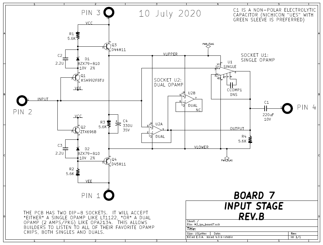

It works great in the First Watt M2x power amplifier, deployed as a unity gain buffer. No oscillation observed among a dozen different implementations, by diyAudio members on three different continents. Schematic below.
The PCB contains two DIP-8 sockets, one for a "single" opamp and another for a "dual" opamp. DIY builders can plug in either an OPA134 into the "single" socket, or an OPA2134 into the "dual" socket. Whichever they like, whichever they have in their parts bin. Just don't populate both sockets at the same time!

I have tone control boards (bass and treble controls) that use the 2134 and they're excellent. The First Watt schematic referenced does not use any of the "tricks" I used to make the 2134 work as a unity gain buffer.

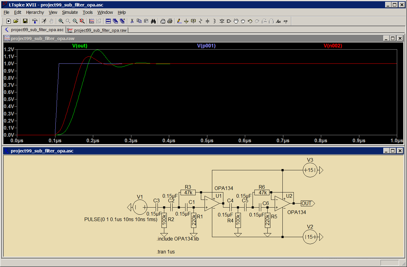

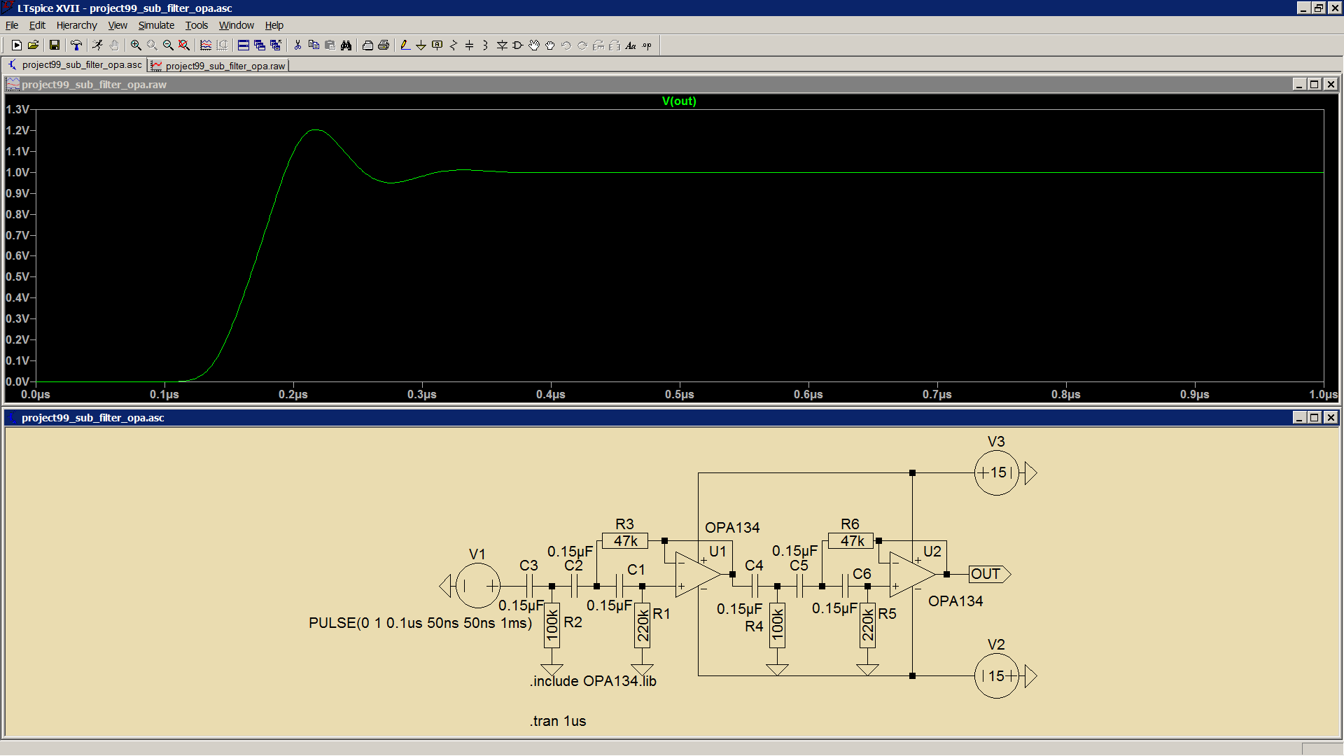

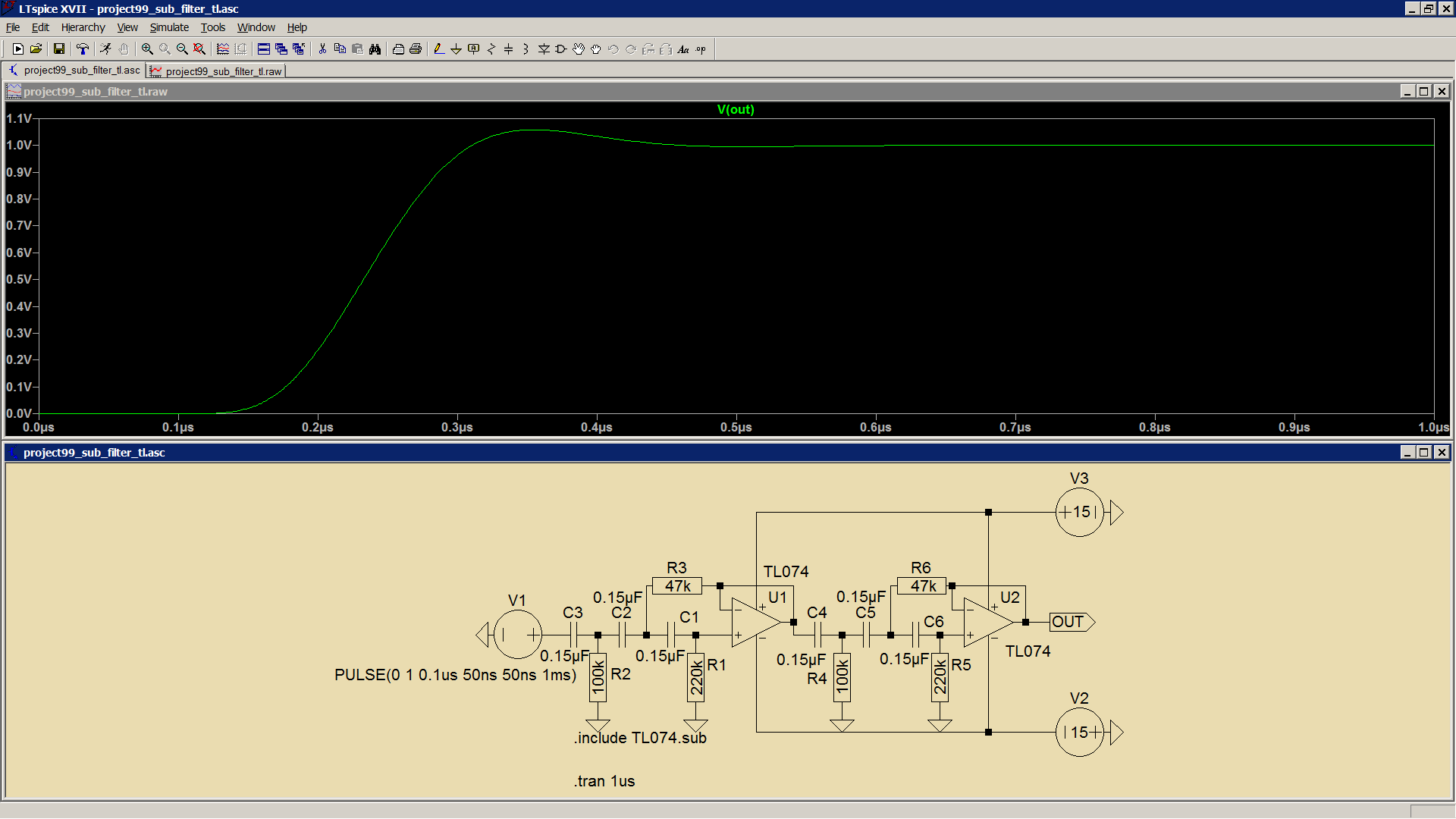

Oh, but you should. This tool gives so much insight! Like what changing the opamps does to this circuit. I just tested the pulse response for TL072 (here TL074) and OPA134 (single OPA2134). The OPA is much faster and here has a significant overshoot. Temperamental chippie that... 😀I haven't done LT Spice ever
The sim files are in the ZIP file.
Well thank you. That is very insightful.
As I thought. And SPICE agrees with me.

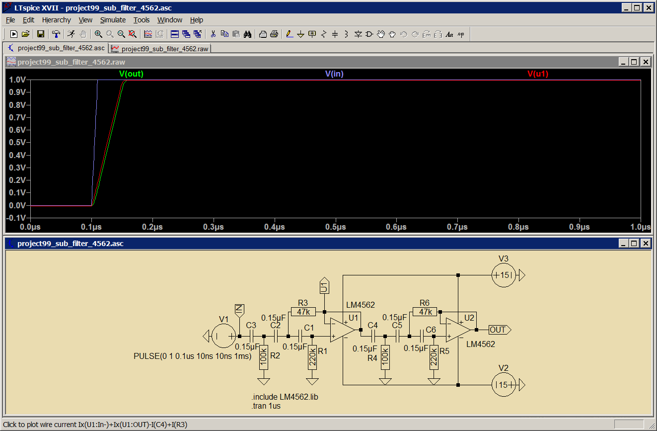

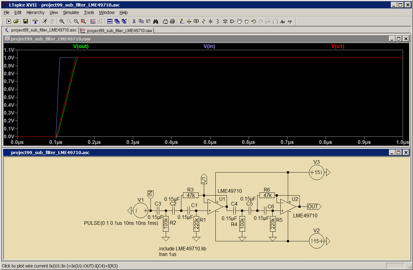

That was an interesting challenge. According to this post the model for LM4562 is broken in LTSpice. There is another model, for the LME49710 that does work as well as a fixed model for the LM4562. Both give the same results. I don't trust them as the OPA gives totally different results. Or maybe the LM(E) chips are just much faster still than the OPA. Whichever the case, there is no overshoot so that is good.How about simulating it with the 4562? Thanks.
