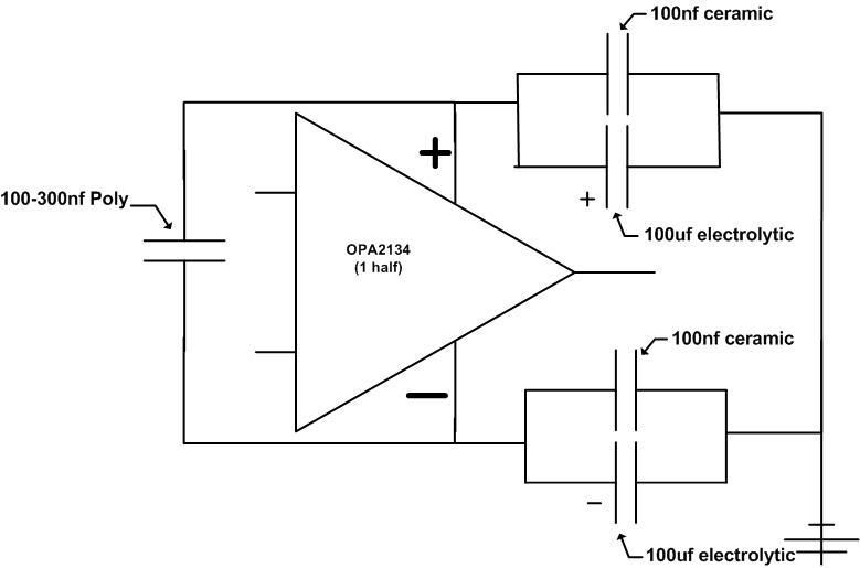

carlosfm said:
No!
I was telling you to try because it will sound very bad!
The word was C R A P, but it was censured.😕
The OPA2132 is better than the OPA2604, and as I said lots of times here, I recommend between 22 and 100uf capacitance on each supply pin to ground.
You can also bypass the electrolythics with small 100nf multi-layer ceramics, but this is not so critical. Note: the LM6171/2 needs them.
Also a 100~330nf poly cap directly from V+ to V- PSU pins on the op-amp. Usually you can do that under the circuit.
This gives me very good results everywhere, not only with the OPA2132.
For me, it's a rule.
After so many tests I made years ago, this is what works best.
Always.
Also, if you don't do it this way, forget the OPA627, it will NOT sound good.😉
Carlos,
I am new to this so this may be a stupid question but I read that opamp bypass caps should be ceramic COG or NPO types but 100uf is too big for those types. What type of 100uf bypass cap are you reccomending, electrolytics? If electrolytic would they be polarized or non-polarized? I understand the 100-330nf is a poly cap. Thanks for your help.
Is this what the circuit looks like? Since I have the 2134 is a dual, I assume each opamp will have two circuits that look like this .. correct??
Although the OPA 2134 is a 'dual', the pair of op amps within the single DIL package share common +v and -v pins (pins 8 & 4), so your schematic applies for the pair rather then for each individual op amp.
Otherwise your schematic is how I interpreted the thread. I've now got the caps and will crank up the iron over christmas........sure is gonna get crowded under the board!! I note that somewhere in one of these posts it is suggested that they be soldered directly on the pins, but I figure this is too messy and probably not neccessary and soldering onto the pins of the DIL sockets under the board would be OK. Perhaps Carlos could confirm this and the schematic.
the small HF caps should be soldered in with the shortest possible route between cap and opamp. This means trimming the cap leads short and soldering them direct to the same pads as the opamp, preferably without a socket.
The electrolytics are less critical and may be soldered in upto 10mm away from the opamp pins. Well, you might get away with 20mm if space is a problem.
