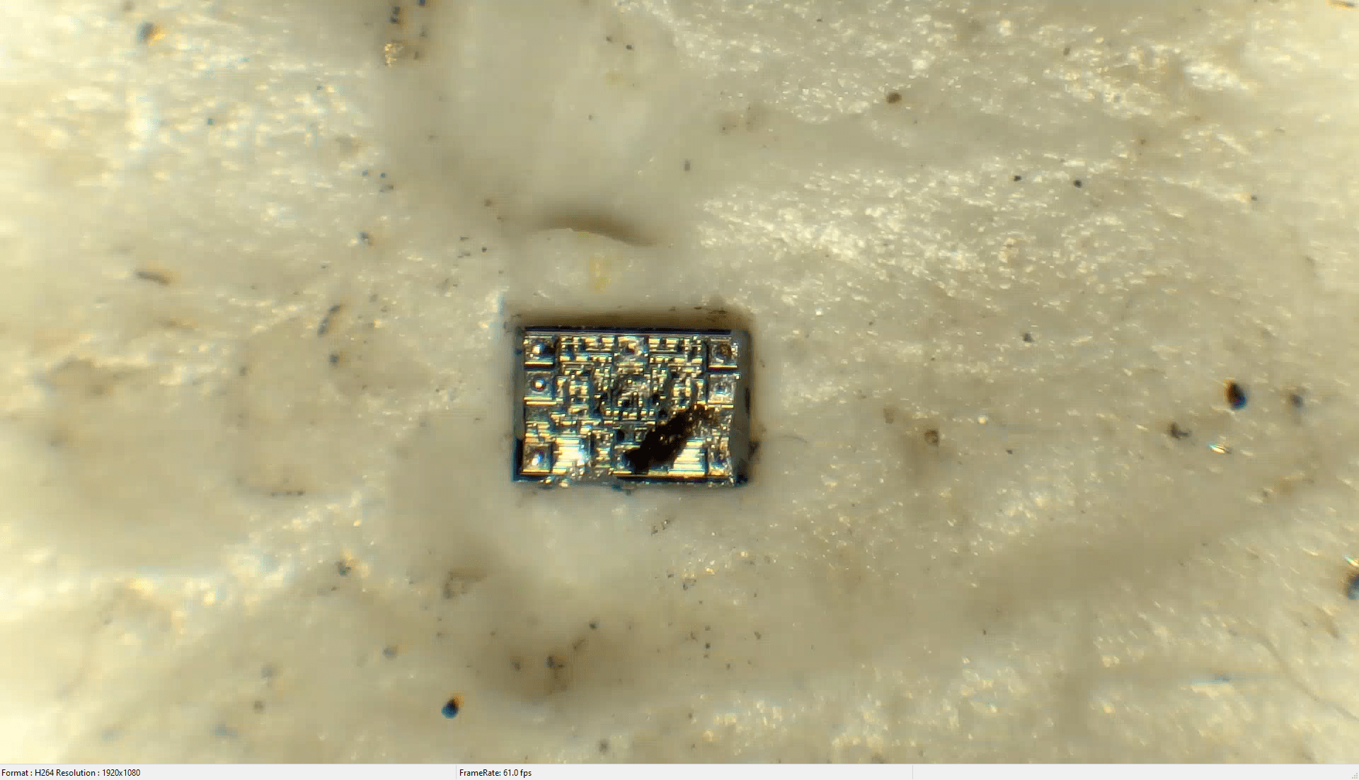

So not all sellers seem to be honest,
my last order from a ali seller hong ming ltd were fake. no wonder at 83 cents each.
it extracted the chip and found this inside.. its 1/6 the size of the original.

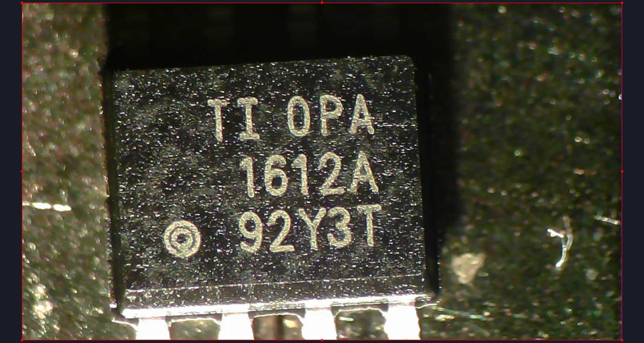

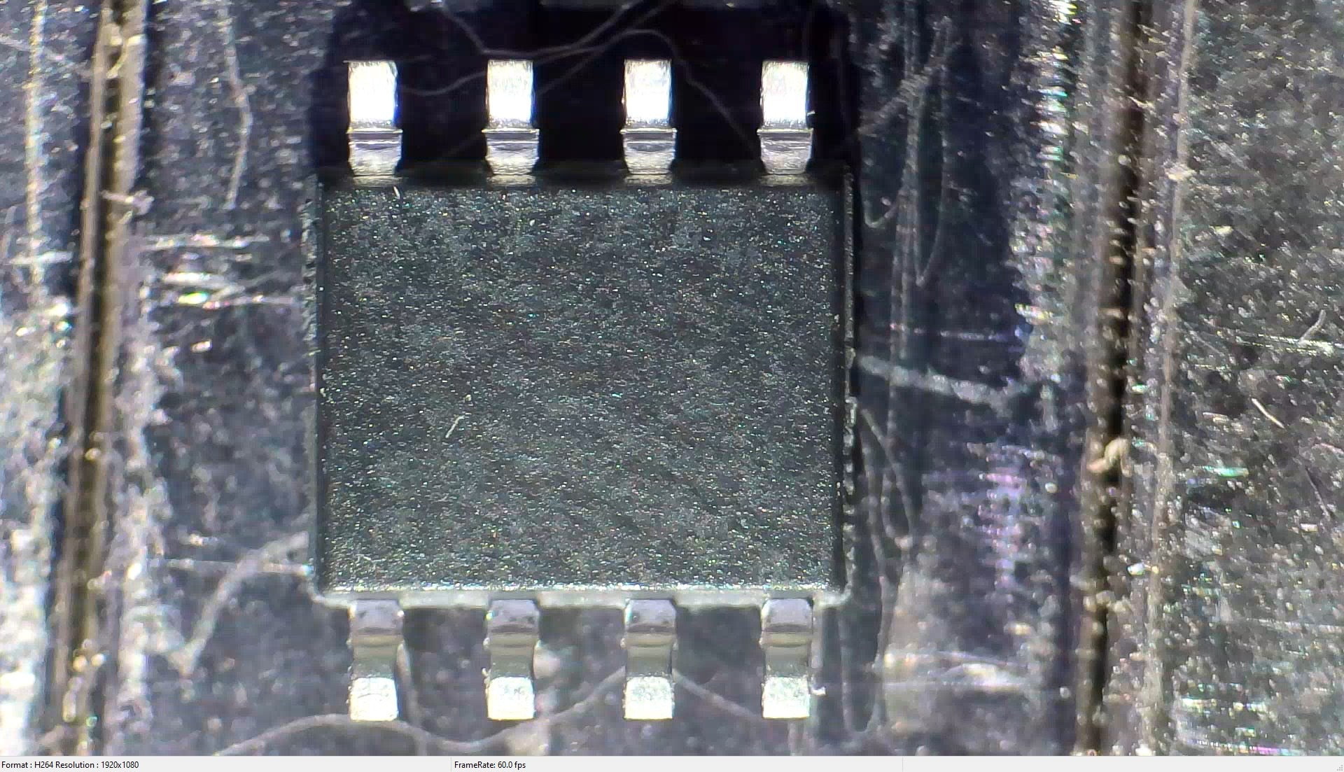

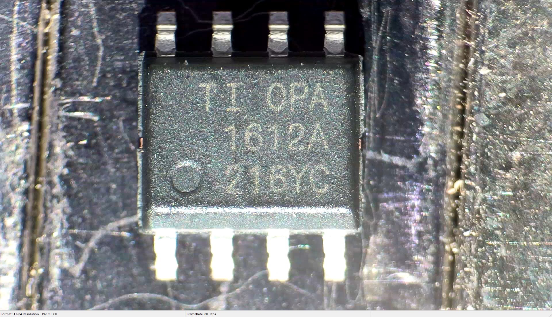

Gamerpaddy,
Do you happen to have a side-by-side comparison picture of the genuine and fake 1612 before examination?
sure.
genuine ones (easy to replicate so dont build on it) have their pin1 marker laser etched two concentric circles and a indented stamp on the back with numbers
the ones i received had a pin1 dot / stamp on the front and no stamp on the back.
Fakeon :
Genuine looking one:
(i dont have one here to take a picture of the backside)
Fakeon :
