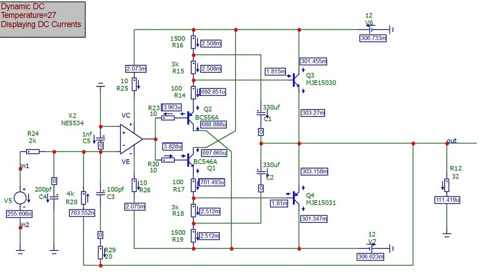

No, it is not possible. To tie to ground.
But it is possible to tie collectors to the output. I might try this to see if it is any better.
It is almost the same result with collectors tied to the output.
But it makes a more nice circuit.
So I use this option.

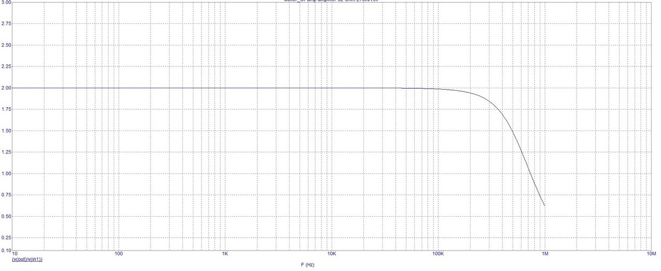

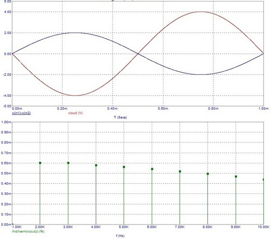

Here is the new version.
There is a few changes to the circuit.
Mainly tied the collectors of drive transistors to the output.
This is a good amplifier suitable for headphones with impedance 8, 16, 32, 64 Ohm.

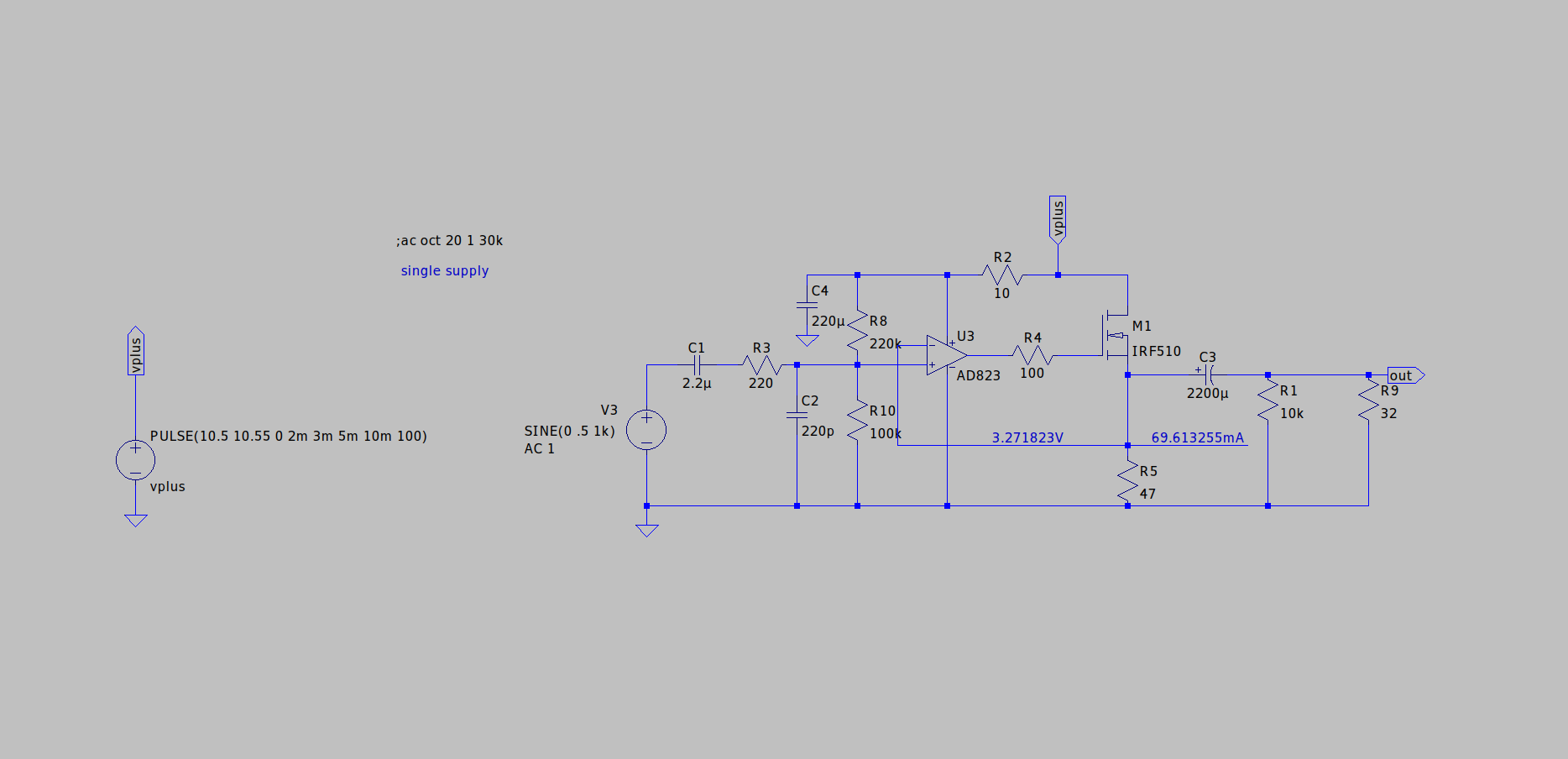

Im working on headphone Amp based on your Navajo project but with btj output.
First sims are promising.

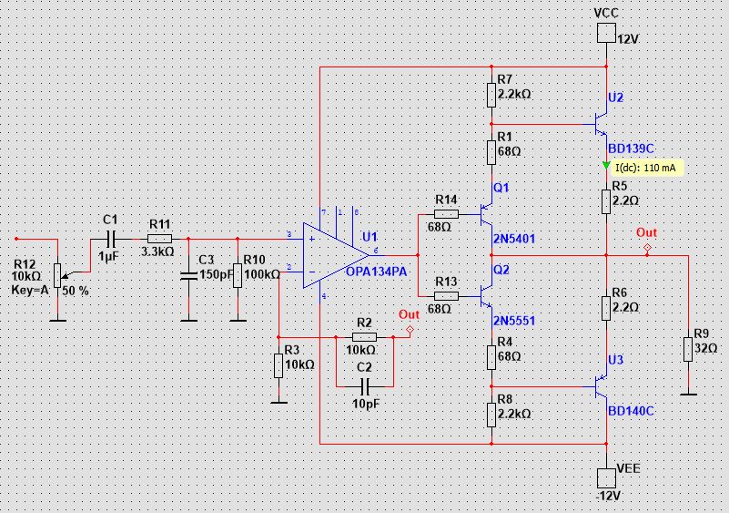

Inspired by the well wishers, I went ahead and built this one.
It sounds good (not the best I've heard), and it just fits my configuration for a convenient headphone amp. The simulation figures matched, so I didn't have to fiddle around.
Thanks for all your help ;-)
