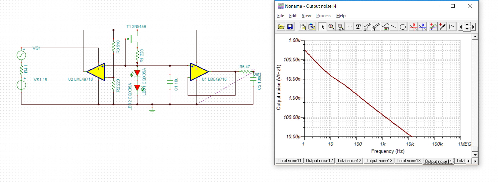

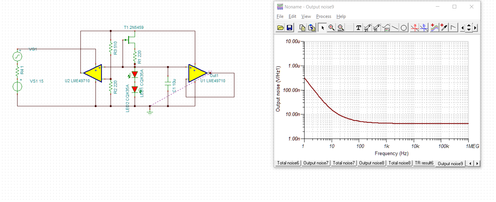

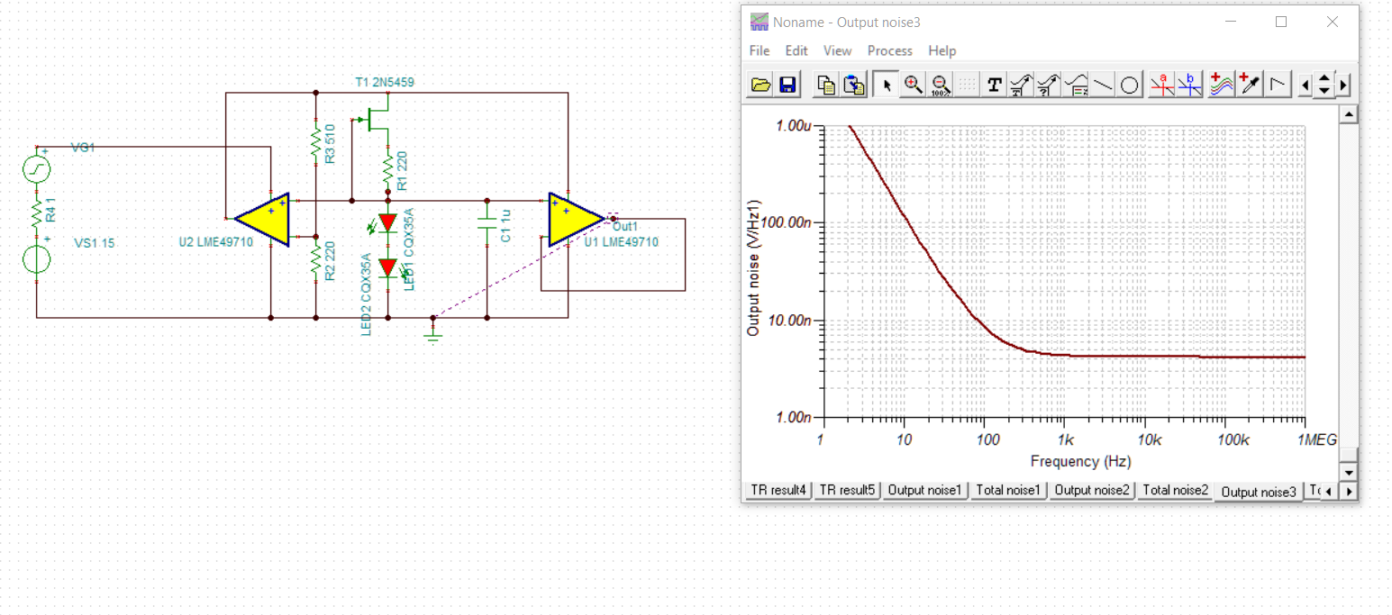

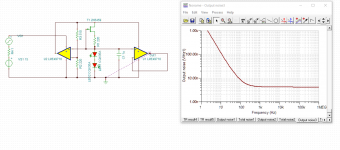

meanwhile I did a modelling. Somehow I can't manage it with LTSpice just in Tina.
Not exactly the same components are found, but I tried to add similarly low noise ones LME47910 (2,5nV versus 0,8)
The capacitor on the LEDs does a nice job
Also on the output (but anyway it is needed)
picture 1: 1uF on LEDs
picture 2: 10uF on LEDs
picture 3: 100uF on output

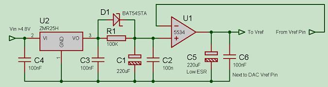

Presumably, that is the schematic posted below, which is very similar to the ESS recommended circuit, only they require using an AD797 or LME49720 type opamp, no 5532's.
For the lower current ESS DACs that opamp type supply is probably ideal, and ESS even says so in rather firm language.
However, some of the newer ESS ES9028PRO and ES9038PRO DACs pull more AVCC current than one opamp can supply (per left/right channel). So the need is to up the output current while maintaining the quality of regulation.
Yes.
Add a small emitter-follower (with, say 1Kohm to 0v) inside the opamp loop and unload the opamp :) ZTX450 or similar is plenty, at low raw supply voltages.
