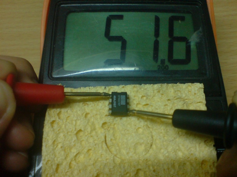

I brought my 627 from a dealer in Bangkok "hifimod" What is the effect of having a bit low voltage anyway? I thought 627 will sounded more open than 2134 but instead sounded more dull.
I've used both 2134 and 627 in my cd player, defenitely 627 doesnt sounds dull compared to 2134.
You can check the resistance between pins 1 & 5 of the 627's to
check its legitimacy, it should read around 50k ohms.
please see attached photo. Meter set to x1K.
