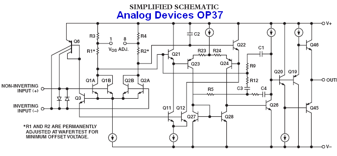

The OP37 provides the same high performance as the OP27,
but the design is optimized for circuits
with gains greater than 5, five.
The internal circuit of OP37 Analog Devices - simplified,
in attachment below.
Enjoy!
Hi Lineup,
A minor point: I think it was TI that took over BB.
The OP27/37 were further developments of the OP07 IIRC, they were improved in DC offset and drift. The OP27/37generally are not so hot as to bandwidth and distortion.
If you use them in audio you may be totally satisfied, but if you look at the specs there are (much) better ones. For a price, indeed.

This doesnt change the fact that OP37 is
a very good OP-Amp for audio at its price.
And I am at www.diyaudio.com right now.
Also true that, if you are willing to pay and can do this,
there are numerous of OP-amps with better specs.
This, however, does not always mean they would do better in audio.

Well, to this I respectfully disagree. This is an opamp optimised for DC and low frequency. They wisely don't even publish distortion curves in the data sheet.
Even at the low price, there are better opamps for audio. The OP27/37 is NOT a very good opamp for audio, even at its price.
