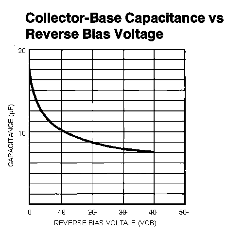

Non linear capacity
It's a fact that non linear parasitic capacity gets more constat and gets lower value as voltage rises, its very usual in every transistor, doesn't matter it's inside a IC or in a discrete way.
It gets worse as its sometimes multiplied by miller effect, if cascode is not used (not in TL, OPAs do), and it causes distortion at high frecuency, and IMD. Also more voltage means less capacity , and it means more speed and less TIM and slew-rate limit.
Power consumption will increase as voltaje rises, so thermal noise will also increase. If noise figure is low, it won't be noticed.
For Vbe and Cbe a similar thing happens, the more current, the more linear, but it cannot be controlled with voltage.
