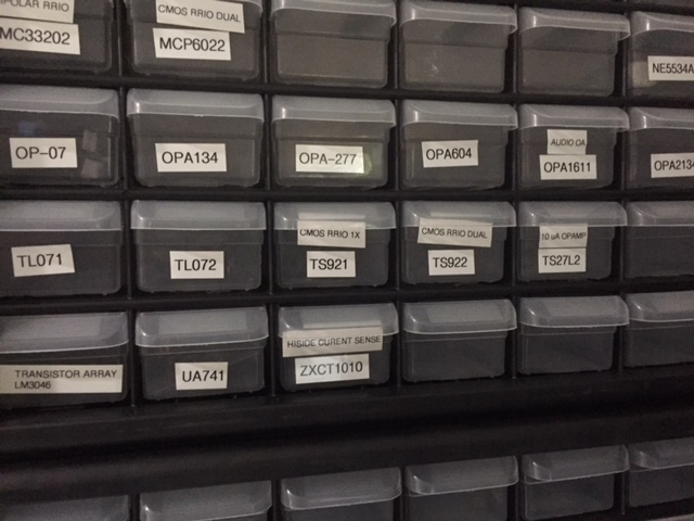

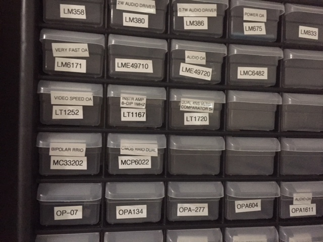

Here are some of the ones I've put into drawers. There are quite a few more lying around in their Mouser shipping bags, waiting to be scooped up and organized into some of those still empty slots.

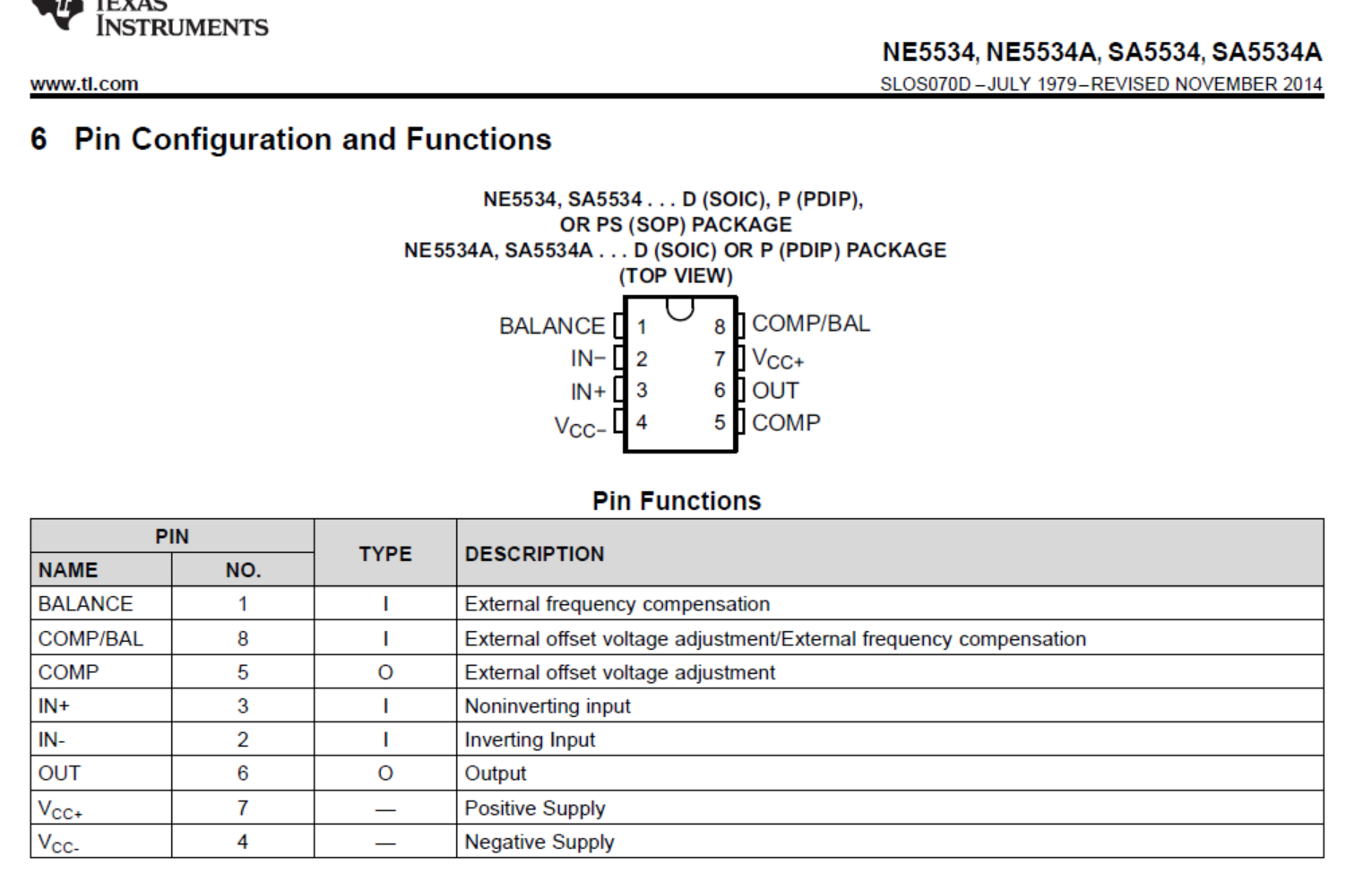

Are you using the single opamp extra circ?
With single opamps:
132/4
604 @24V
5534
AD797
As Andrew T said
The dual only has access to the three standard in/out pins, whereas the single has all 6pins available.
The internal unity gain compensation of the dual makes it's electrical performance significantly different.
Yes, I can use the 'extra pins'.
For example NE5534and unity gain, there is a cap 22pF to add.
Also can use 2 pins to adjust offset.
There are 2 reasons why I fancy single op amps.
1. The easier design of pcb. With dual op amp the card get 'crowded'. While I can have more space with two single op amps.
2. The maximal power. Two in a dual gives only half the power for each. The single op will run cooler.
