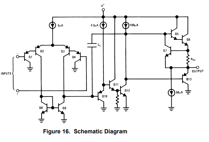

Here's an LM358 connected as an inverting amplifier with a gain of -1.0 . Input (top) is a 5 kHz sinewave that swings between -4V and +4V. Power supplies are ±10VDC. Output (bottom) shows the severe crossover distortion that has made the LM358 infamous. DON'T USE LM358 FOR ANY SIGNAL WHOSE BANDWIDTH EXCEEDS 1 HERTZ.
If you post the internal, transistor level schematic of the LM358, I will help you draw a red circle around the portion of the design that is responsible for its (intentional!!) severe crossover distortion.
_

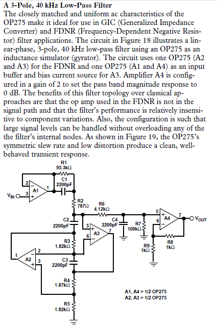

I have some opa2604's but they did not work well in the circuit I bought them for (FDNR). The opa2134's and LM4562 both work fine.
I just checked your circuit. Your power supply is +/-10V. Even with +/-15V, OPA2604 performance is unacceptable. It needs higher rail to perform (that's why it is often lost in an op-amp rolling).

And have you checked OP275? It's another underdog op-amp because it doesn't perform well in a conventional circuit.
As long as the output doesn't have to swing too close to the negative supply rail, it is easy to get the LM358/LM324 output stage to work in class A by adding a resistor or current source to the negative rail. Even then it's not a very good op-amp.
The TLE207x series has a silly bug: when the output clips to the negative rail, the supply current increases a lot, see figure 43 of the datasheet http://www.ti.com/lit/ds/symlink/tle2071.pdf . That's something you have to be very aware of when you want to use one with a shunt regulated supply, like a resistor-Zener diode supply. Comparing the internal schematics of TL07x and TLE207x, you see that TI forgot one diode in the TLE207x series, one that should pull down the base of Q22 when Q26 is about to saturate.
