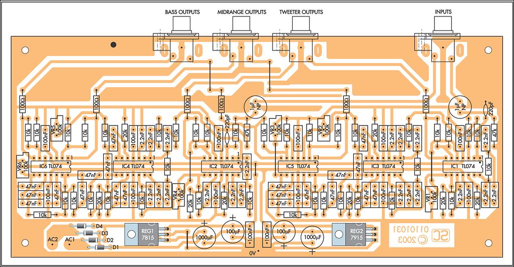

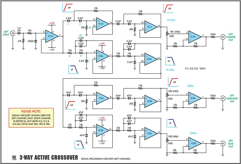

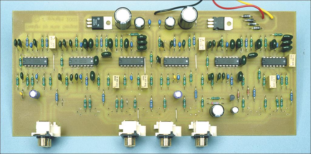

This was a nice one I used, subbed the TLO74's for LME4970's. Buffers each end.
Active 3-Way Crossover For Loudspeaker Systems - January 2003 - Silicon Chip Online
Cheers George

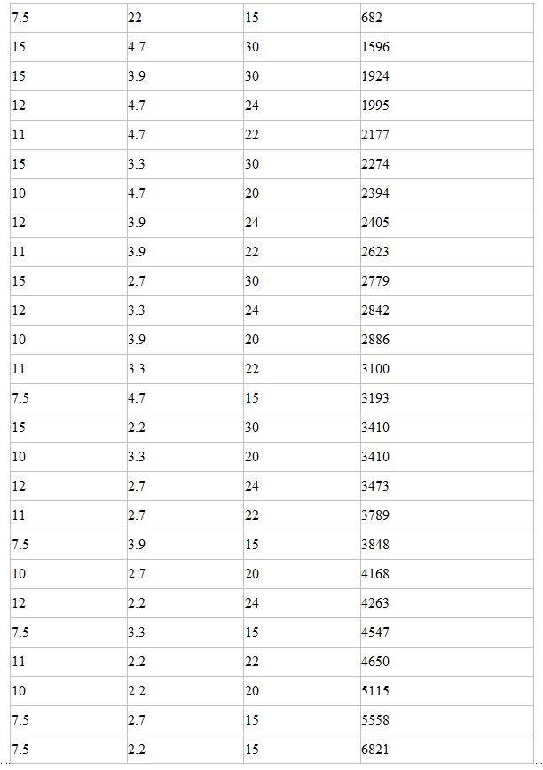

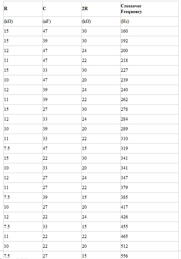

I concur with that substitution, using 10k resistors throughout won't allow TL074s to shine. Scale 10ks up to 220k (and of course the 2n2 caps down to 100pF) though and it'll probably sound more transparent than all but the best amps.
Buffers each end.
Yep definitely don't use a TL07x to drive an interconnect.
@Kev - initially I was just as surprised that TL084s could do the job. I used to build passive (line level) XOs but no need now with such good results from such humble opamps. Quite probably the measurements will show up distortion as the input capacitance of JFET opamps is non-linear and hence gives rise to increasing distortion with higher passive component impedances. However subjectively I notice no issues with distortion when going to higher working impedance, only the substantial dynamics improvement from reducing the PSU noise.
Thats really helpful, thanks to both of you. I've calculated some C & R values but they seemed pretty arbitrary as of course these can be scaled either way, so its good to get an idea of what sensible values are.
