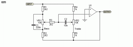

Hello, I have built this simple op-amp tone control/ premap.
Im satisfied with the bass and treble frequency " cut/ add " , but it doesnt sound so " clean / crisp " I mean, using the same op amp in an preamplifier sounded " better " than in this tone control circuit, I've used TL072-NE5532 .
Should I add a buffer before the "tone control " ? i have seen most op amp bandaxall tone controls use a buffer at the front.
I dont want to build Rod's tone control ( it uses 3 op amps ) I want to use 1 or 2 max.

NEVER drive this circuit directly from the potentiometer center tap. The parameters constantly change as the potentiometer is rotated. You would know this if you had calculated your Norton-Thevenin equivalents correctly.
The obvious solution is a buffer after the volume control tap.
This is a very simple circuit and has been widely used. Although not as precise as other tone control circuits, it should sound "clean/crisp"as you say. What kind of capacitors did you use in the tone shaping circuit? You should be using some kind of film capacitor, NOT ceramic. MKP is great for this application, but more humble film capacitors should work fine.l

The circuit is fine, parts used also, and compared to relatively Lo Fi signals (MP3 and such) provided by

As of adding an output ground reference resistor, it does not need it since Op Amp out is both DC coupled and low impedance.
What did you use for power supply bypassing? Did you build it on a small dedicated board? Do you have a 0.1 uF ceramic capacitor soldered directly to the power supply pins of the chip? On board electrolytic bypass? Every board needs local bypassing.
Non inverting input should be connected to noise ground, not power ground. The two grounds shouldn't even be connected together on this board - should be connected together somewhere else in the circuit and only at one point. Sloppy ground schemes can introduce some "grit" to the sound - especially at lower volumes. That's because connecting signal ground and power ground together at more than one point in the circuit can introduce nasty ground loops. If you're sticking this circuit in a device or using it with another board, then failure to get the grounding right can seriously degrade performance.
Finally, this circuit will interact with the output impedance of the circuit driving it. So if the circuit has a relatively low output impedance (say 47 ohms) then the interference should be negligible. But if the output impedance is higher, or not linear with respect to frequency, then you will get some unwanted results.

Do you have this assembled on one of those solderless prototype boards? Audio circuits do not work well on these boards. They're very noisy with lots of stray capacitance. The "experimenter" PC boards from Radio Shack work much better and right now they're practically giving them away. Have you used them? They're laid out perfectly for op amp circuits.
Where do you have the non-inverting input grounded? Lots of noise and distortion can be introduced here. It should be grounded right at the audio input ground. I always have the input and output grounds right next to each other on my modular boards, and any critical signal ground goes right there. Signal ground should only be connected to power ground at one point in the whole circuit, typically at the input/ volume control ground.
The non-inverting input bias current is an unavoidable DC ground loop which can be minimized by using high input impedance op amps like the TL07x or OPA2134 devices. But even a 5532 with its higher input bias current works fine in a circuit like this.

Try this circuit with a 10k volume control at the output. You will probably like it better.
Probably so. It would work best if the power amplifier were in the same case and the signal leads were short.
I would recommend using a 5532 (or 2134) in this case. The op amp is not only driving the pot, but also the resistors in the tone control circuit. This is even more relevant if the second circuit (with smaller value resistors) is used. The 5532 would be best in that circuit and would drive everything at 1 volt RMS with ease.
