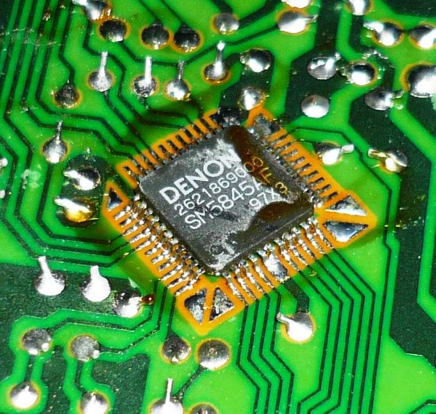

Oh, I would like to hear that DCD-S10 🙂 I hope you got rid of those lame NJM2041 - the "Asia" model came with OP275 as I/V!
I see that it has the same Alpha filter - SM5845 - like my DCD-360. The only issue is that in my schematics is shown as either 5845 or 5848 and on board is SM5845. None of them have public datasheets (Denon proprietary special order).
