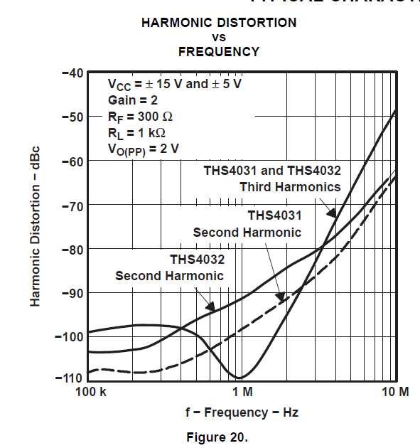

I just got today some THS4032 (TI). Noise: 1.6nV/sqrt Hz; Slew Rate: 100V/us; Settling Time: 60ns, THD: -90dB at 1MHz; BW: 100MHz!
Another contender that I have at hand is ADA4897-2 (AD). Noise: 1.0nV/sqrt Hz; Slew Rate: 85V/us; Settling Time: 96ns, THD: -115dB at 100kHz, -93dB at 1MHz; BW: 230MHz!
I am planning to use them as I/V stage after a PCM61P - it has a settling time of 350ns. I am planning to get rid of the SR limiting capacitors in the I/V stage.

In my application I have +/- 5V so I could use the ada4897 (it's a "low power" device), but I was waiting for THS4032.
THS4032 has 33V max voltage (measurements for +/-5V and +/-15V are given in datasheet) and is almost identical for our I/V scope... And distortion figures are around -100dB all the way to 400kHz.
