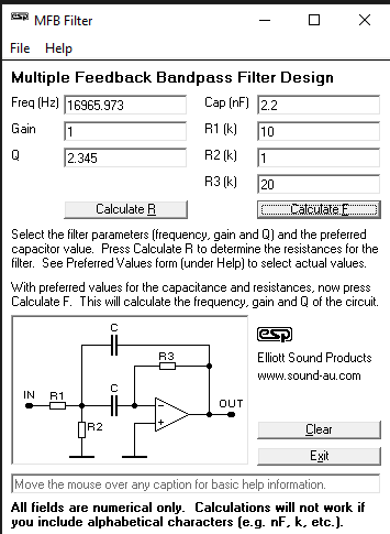

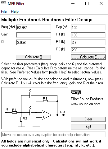

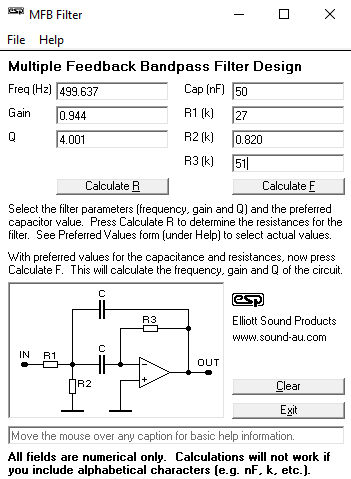

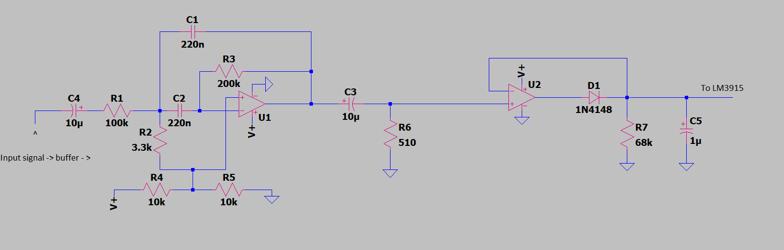

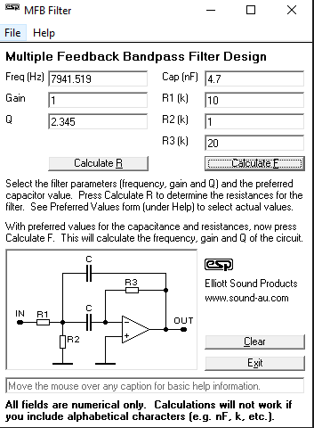

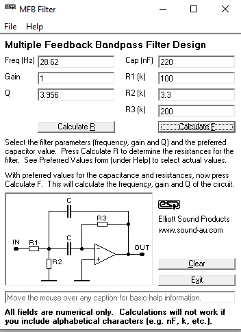

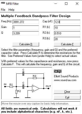

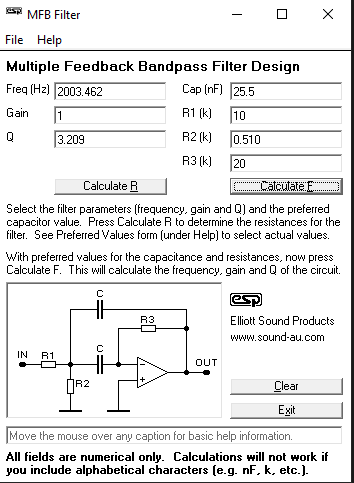

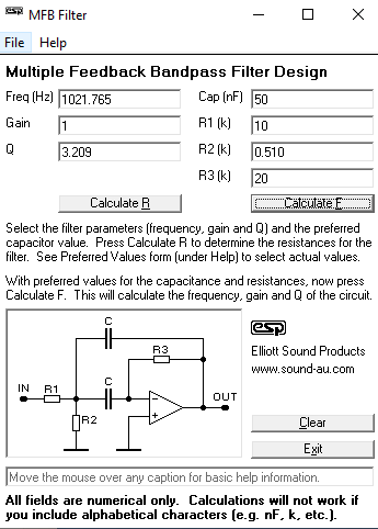

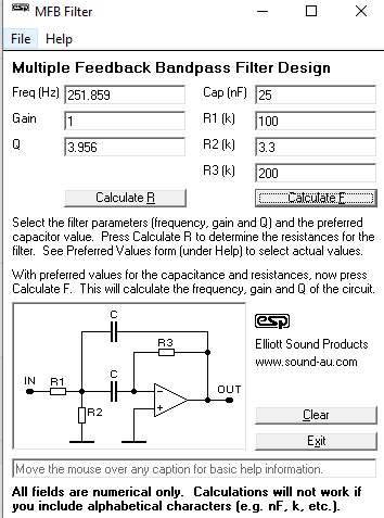

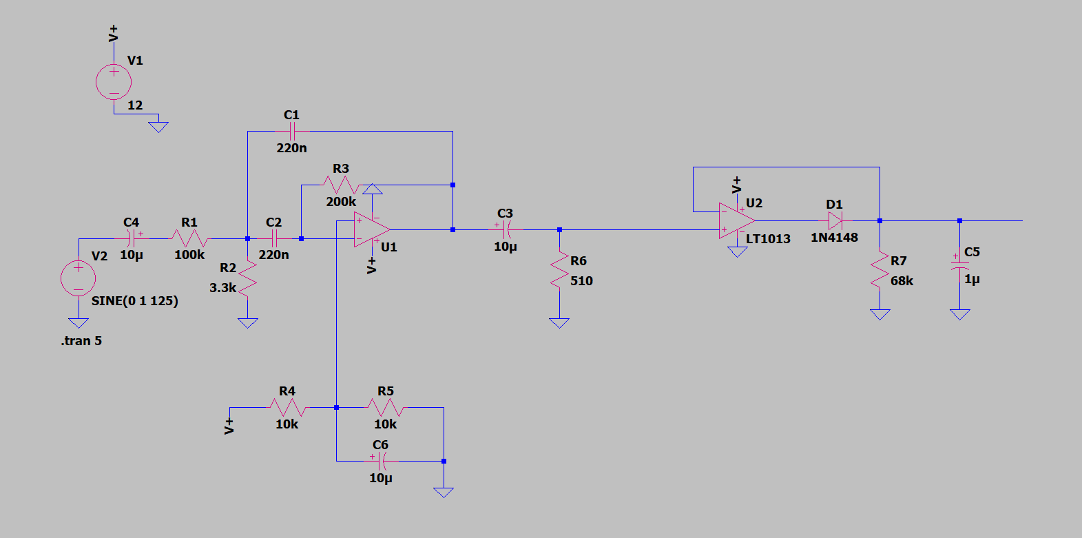

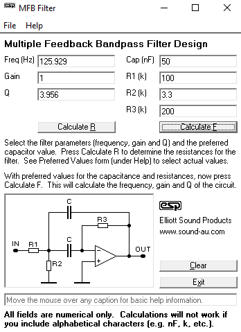

Hi, I'm building a 10 band spectrum analyzer based on 10 multiple feedback band pass filters and 10 LM3915's.
Filters have a Q of 4 and 3 . Used Rod elliott's software for multiple feedback band pass filters.
Now, I was thinking I don't need very fast op amps for the band pass filters, maybe for the rectifiers ( peak ) , Chat GPT suggests otherwise.
2.5V ref for the LM3915's , 680R both resistors. So 2.5V max at audio frequencies I think I don't need more then a few V/us slew rate. !?.
Any recommendations for op amps to use ? for the band pass filters and for the rectification ?. I have plenty of 4558 but I think they might be slow , I also have NE5532P , But I can buy any other op amp.
Thank you .
- Bruno.

It may function without it, but not accurately without the decoupling.
The virtual center reference voltage in a single supply circuit must always be decoupled to ground.
But R2 can go directly to ground. Just the non-inverting input goes to V+/2.
Also don't forget the local main supply decoupling.
That cap reduces the DC gain to unity (+1), to minimize the output DC offset voltage.
Which is a different purpose than the "virtual ground" cap in your active filter circuit.
The "virtual ground" active filter cap could be replaced by a battery of half the supply voltage instead.
The battery would (nearly) be a short circuit for AC signals as well.
Not the other cap though. That one is intended to provide an open circuit at DC.

Damn, I made a mistake, when I added the voltage divider on the + input. R2 should go straight to ground . I wonder how it worked tho, R3 wasnt 3.3k anymore since its in series with R5 to ground .But R2 can go directly to ground. Just the non-inverting input goes to V+/2.
- This is how it should be right?
@raymaI wonder how it worked tho
It sounds good only on low volume , I guess because the missing cap ( in LTSpice the vaweform is triangular without it ) . and R3 not directly to ground.
Any recommendation for the filters Q , 4 seems to be letting to much other frequencies , so may be a Q of 10, I might need to try.
Besides the Q , what order is this filter, 2nd order 12dB ?.
The higher input impedance will give you less voltage droop in the sample hold type section of the circuit with U2.
Cost vs performance !!
It is hard to beat them in many cases such as this one.
Unless you are feeding a +16bit ADC, they are much much better than any JRC opamp I have ever used tested and swapped out.
In the past I also had an issue with using a NE5532 in a filter sections on my Fostex 454 mixer , this was due to the resistors were to high for the BJT type of opamps in the filter sections and would oscillate, so I used the NE5532 in the main direct chain and TL082's for the filters and all was nice and quite with no squealing filters .
