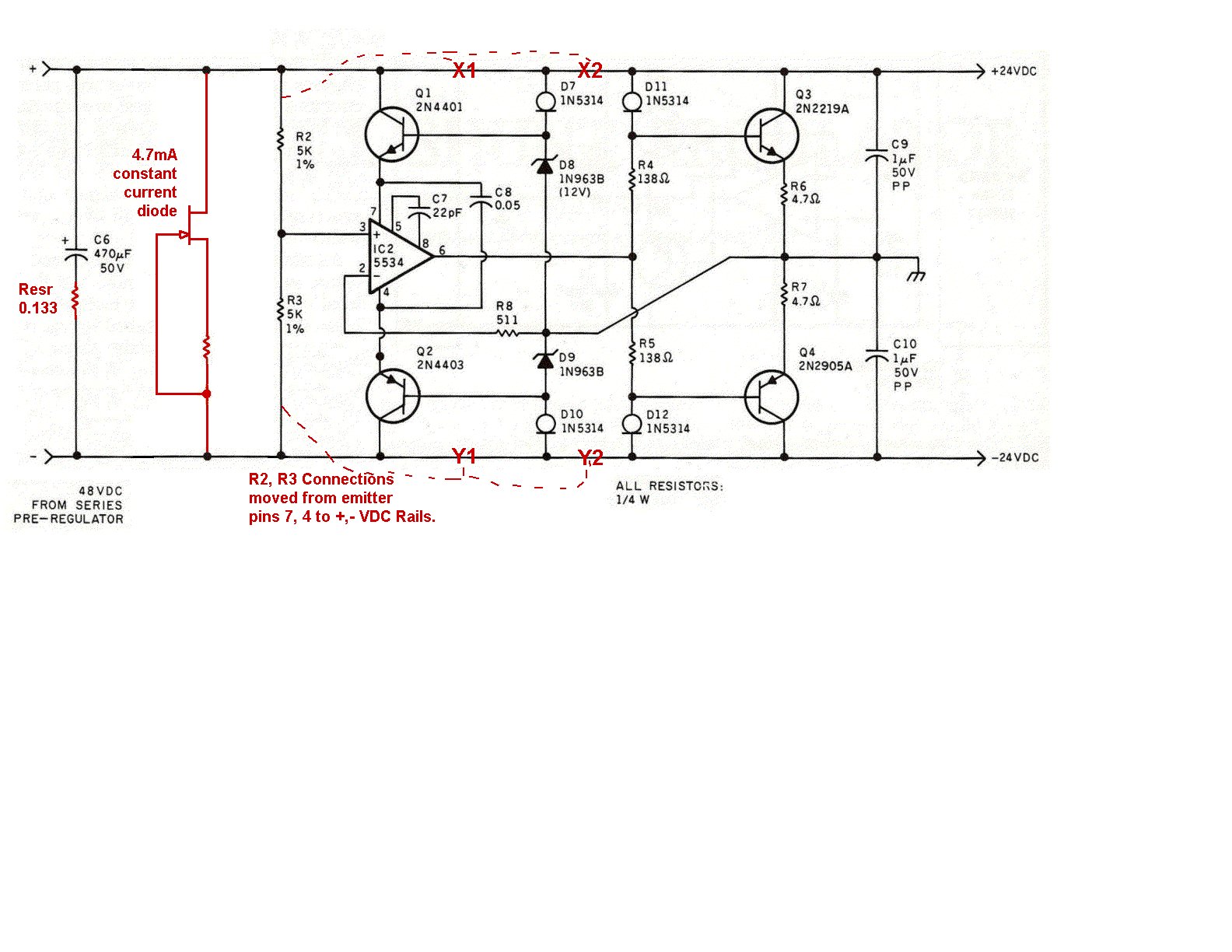

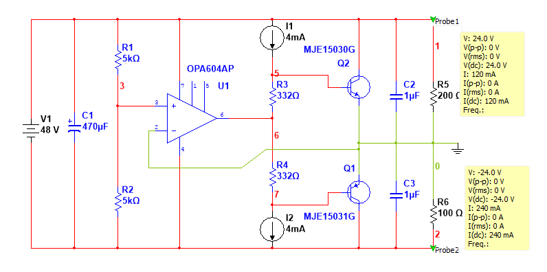

You could use one of the TI high voltage opamps, not just the '604:
Since the opamp output bias point is halfway between the rails, you don't need or want a Rail-To-Rail-IO opamp. Since you don't need to swing the opamp output very far at all, you can run the opamp using lower voltage supply rails, created via a pair of zener diodes or a pair of LM7812 3-terminal regulator ICs. With less voltage between the opamp supply rails, you can use those zippy 350 MHz opamps like the LM7171, that don't go up to nosebleed supply voltages.
And since you're not swinging the opamp output very far at all, you can use monolithic Darlingtons for the emitter followers, without compromising output swing. If you wish. My railsplitter pcb uses TIP142/TIP147.
Me, I'd prefer series resistors in the emitter legs, plus a bias splitter ("VBE multiplier"), just to set up a known amount of standing bias current in the output stage.

Here are changes based on the thread discussion of the rail splitter.
Since we moved R2, R3 from emitter to the rails, then it was suggested to the middle; I didn't know which would be better X1, Y1 or X2, Y2...assuming farther down the rails to follow on nodes not marked...X3, Y3, then X4, Y4, then at the load...X5, Y5.
Honestly I'd leave R2, R3 where they are drawn in the schematic for now, or maybe move them in the other direction.
However, there's one big question that has to be addressed - where's your input coming from?
Is it a floating transformer supply? In this case, leave things as they are.
Or is it an existing unipolar supply? Then parallel an electrolytic cap to whichever of R2/R3 goes to the "clean" side (ground).
Adding a buffer to this would be much the same as in a headphone or speaker driver, really. It would be good to know how much current you'll need, since I suspect a single emitter follower with BD139/140 (MJE340/350) or similar would be plenty in many cases and getting it stable thermally and electronically ought to be far easier than for a Darlington.
