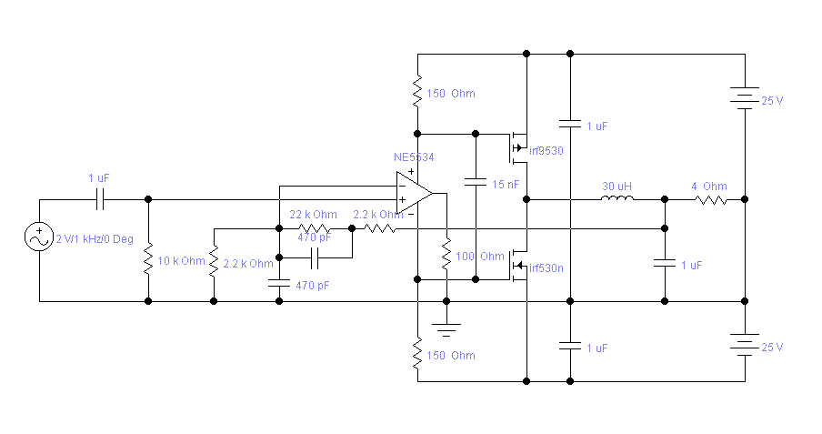

I think IRFZ24N and IRF9Z34N are well enough. I attached a simple schematic. In this circuit your OPA can be quite useful because of its high short circuit current. (But it's just an idea!) You have to change some values! (Gate-resistors and 100 ohm must be reduced significantly if you use AD818.)
Take special attention on supply decoupling, and ground plane, if you build it!

the schematic that you made, i guess it is self oscillating?..

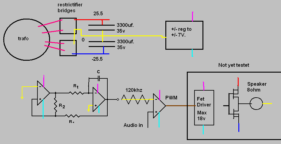

i have already made a test breadboard. looks like the pic i attatched,
i just need to know, where and how to add "dead time" ??
the op amp i use right now is lm833n, the carrier is around 120khz..
when i connect my 8ohm speaker, it actually sounds great..
Yes.
Between gate-driver and FET, or between comparator and gate-driver if your gate driver has 2 channels. How? R||D, C
In any cases you must disconnect two gates from each other! And you need level shifting between gate-driver and FETs.
Where do you connect it, if power stage is "not yet tested"?

how i testet,
i have a "unused" amp in one of the chips so i just made that do the "dirty job" of driving the speaker, i know it is a bad solution, but just to test if it was working, it is clear that the opamp is lacking in current.

Maybe, if you insert two level shifter and two dead-time circuit between gate driver and FETs.
You can't put it there, if you have only one channel of gate-driver! Think it over!
I think first you should learn basics of electronics. Or simply copy a well-designed circuit.
