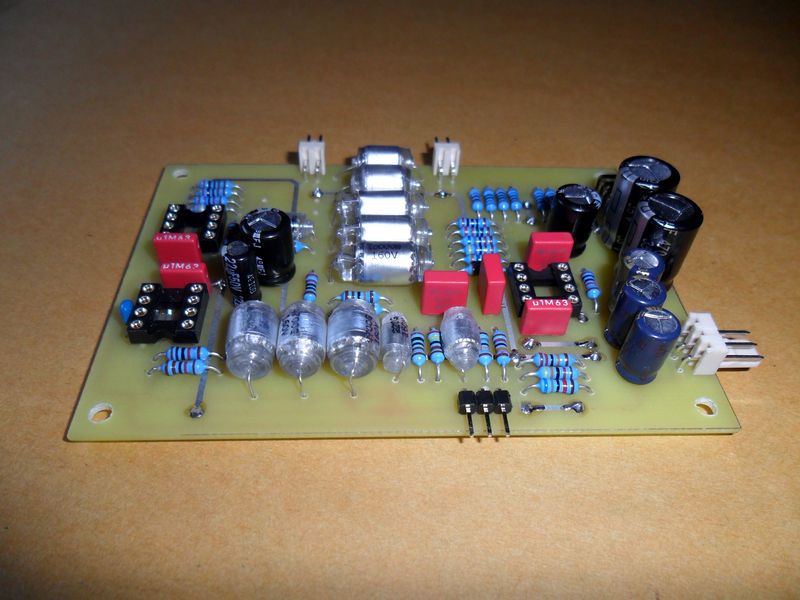

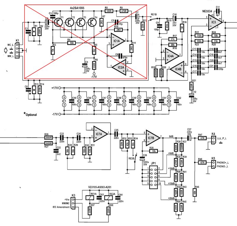

I also so think, therefore the question must be, which OPA provides the sound, which is close as possible to the EAR834. I need not to create a new phono preamp. I want to know this for upgrade already exist phono preamps with appropriate operational amplifiers in the above mentioned topology.I basically agree with Koifarm which is why now I only design tube based phono pre-amplifiers, I will admit in one design that I used a DN2540 as the upper device in a mu-follower, but in general if you want this sort of performance you need tubes in the signal chain.

In my experience no op-amp sounds like tubes in this application.
I do prefer the old Analog Devices OP275 (Butler input configuration) to many, but have never tried it in a phono stage - I suspect it might be too noisy. (6nVrtHz)
I'd say it's worth a shot then, I replaced OP275s with more modern devices and ended up going back. It's good.
