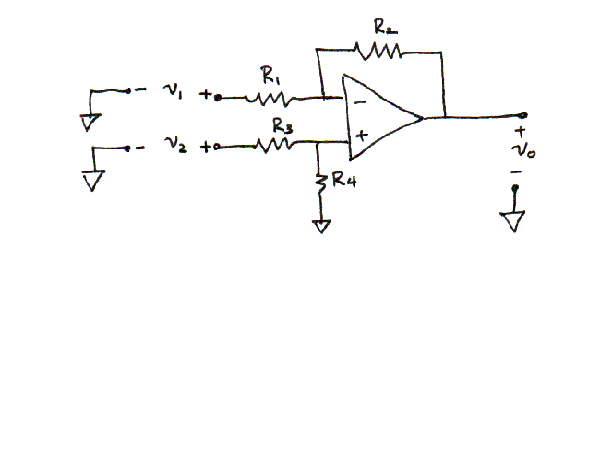

Can someone please give me the formula for the gain in db of the difference op amp pictured? I have formulas for the voltage gain.
In my circuits
r2=r4
r1=r3
For example:
r2= 10k
r4= 10k
r1= 1k
r3= 1k
gain is 20 db
Can someone tell me:
r2= 2.31k
r4= 2.31k
r1= 1k
r3= 1k
gain is ?db
I've got to make a low gain microphone pre-amp and can't find the correct formula on line.
What are the correct values for r2 and r4 for a gaijn of 10db?

If the voltage gain is Av then it is 20logAv dB.
In the first case (10k and 1k resistors) you have a voltage
gain of 10, which is 20*log(10) = 20 dB
In the second case (2.31k and 1k resistors) you have a
voltage gain of 2.31, which is 20*log(2.31) = 3.6 dB
Generally the difference between two voltages v1 and v2
is 20log(v1/v2) dB and the difference between two currents
i1 and i2 is 20log(i1/i2).
