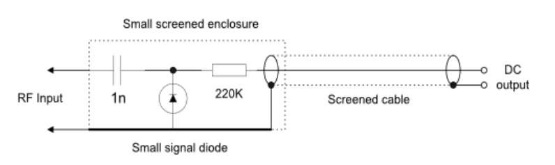

If you have a 'scope you should really look at the output that there's no oscillations.
Most modern opamps are much faster then the older types and may oscillate in a circuit not meant for them.
It will often work, but there are no hard and fast rules.
The harsness you mention could well be oscillation.
If you don't have a 'scope, try an RF detector build from a diode and a cap, lots on Google.

You also need to look at the power supply. It is unusual and limited in current delivery with neither rail regulated with respect to ground although each is stable with respect to the other. Note #2 on that diagram recommends TL072 and tbh I would take those over the 4558 (which is imo not good). That supply will not support four NE5532's or similar power hungry opamps.
If you noticed a difference in volume with TL072's then something is wrong. There should be no change in level with any suitable opamp fitted.
