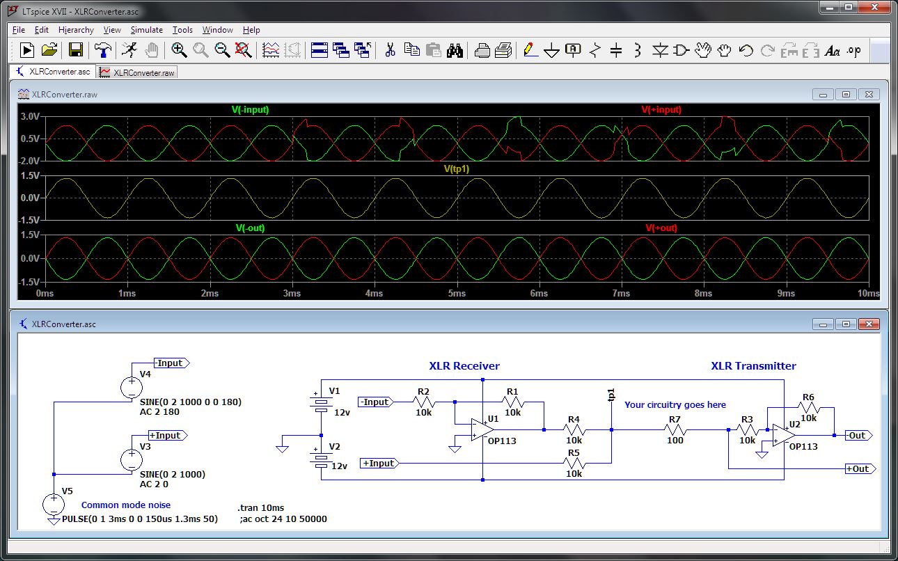

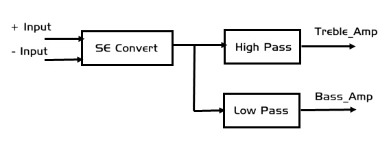

The first thumbnail is a simplified flow chart. The second shows a simple XLR (balanced) Receiver and Transmitter. You would most likely only need the receiver part.
In the spice screenshot, the top graph shows a differential input with considerable common mode noise, the middle graph shows how it's all cleaned up by the XLR Receiver, the bottom graph shows a nice clean differential output.

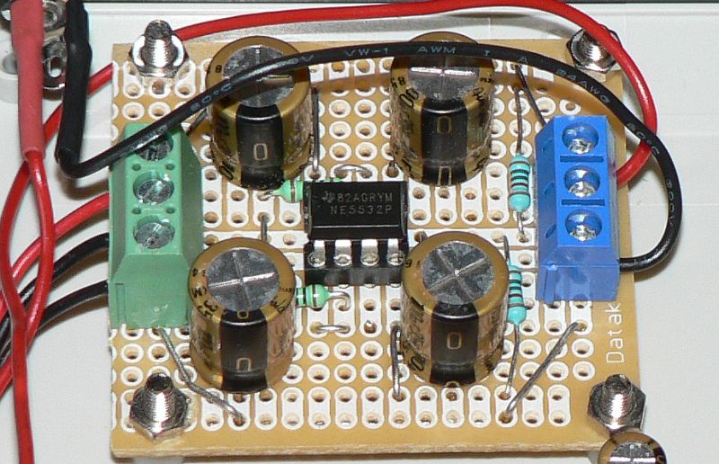

The 2xLM4562 are on the pre amp board only. My P43 supplies are built with a single TL082 or NE5532 (see example in pic). Rod said in the article that it's suitable for higher level stuff like crossovers and his active crossovers have heaps of op amps but someone with more knowledge on current requirements may chime in. Whether the current is dependant on the DC wall wart output or is restricted or not by this circuit?
There's an alternative to using a DC supply if you want to use a wall wart (plug pack). An AC wall wart can supply split rail DC using 317/337 or 78xx/79xx if you read the ESP P05 articles. P05-Mini
