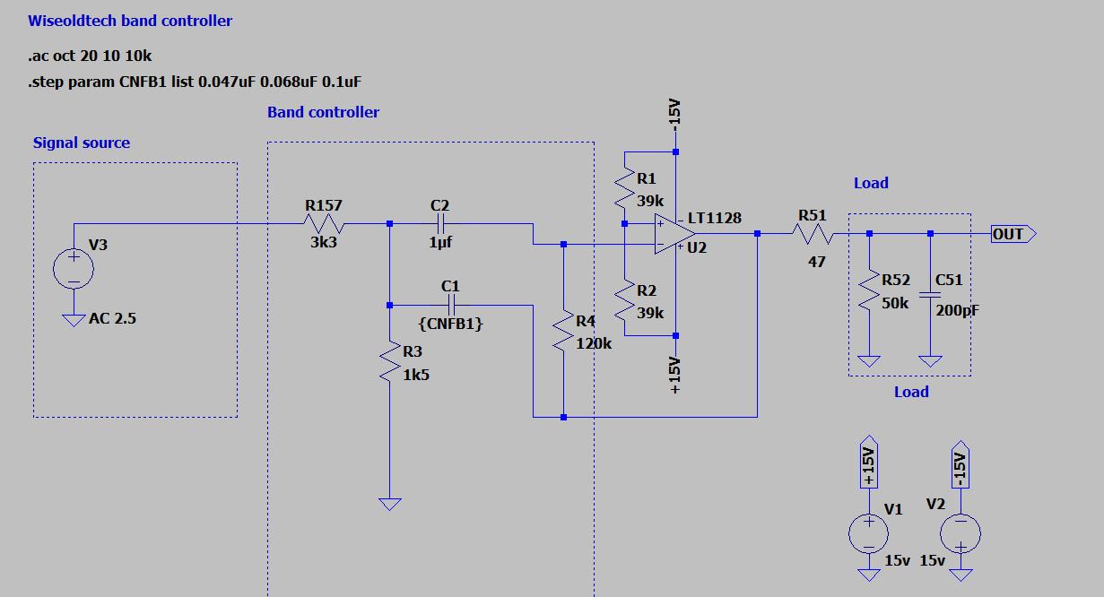

I have this 4-channel "Color Organ" in a previously finished project.
And it performs nicely to animate the colored lamps to the music.
Yellow=trumpets - Red=vocals - Green= lower vocals - Blue=bass notes.
However, one thing bugs me....

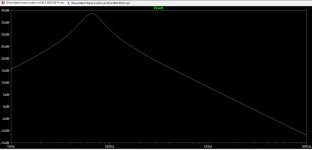

The lowest frequency just isn't low enough for my tastes.
The "Bass" section of the IC activates higher than I'd prefer, and I'm in a bit of confusion on making it activate at a lower frequency.
As shown, it's around 300Hz.
I have tried 0.1uf caps in place of the 0.47uf, but the lamp doesn't even activate at all. ( actually jumped the .047's with another .047)
I want it to center around 80 to 150Hz.
Anybody here have any positive (not guesses) ideas on how to mod the existing circuit (caps, resistors)?
This is the circuit.

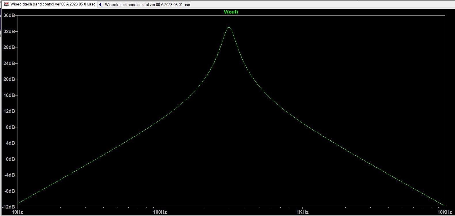

Do you mean that you want to change the center frequency as well as the quality factor, so the response over the 248 Hz to 350 Hz range shifts to 80 Hz to 150 Hz?
If you just want to change the center frequency while keeping a 6 dB bandwidth of about half an octave, then it's simple: the center frequency is inversely proportional to the capacitance, so 150 nF capacitors should get it in the desired range.
What I don't know, is whether the 0.47 uF should also be increased by about a factor of three. Is it 0.47 uF in all the other channels or does it depend on the center frequency?

Sorry, I meant 0.047, my earlier was a missprint.
And each "band" uses a different capacitance and resistor layout.
The other bands are fine.
Indeed, I want to stay in basically the same bandwidth and sensitivity area.
Just closer to where the real bass is, not at 300Hz

Why are you insisting on increasing both capacitors in exactly the same way?
My layman reasoning says that one is the gate keeper for the lowest frequencies and the other one is determining the upper limit of the filter.

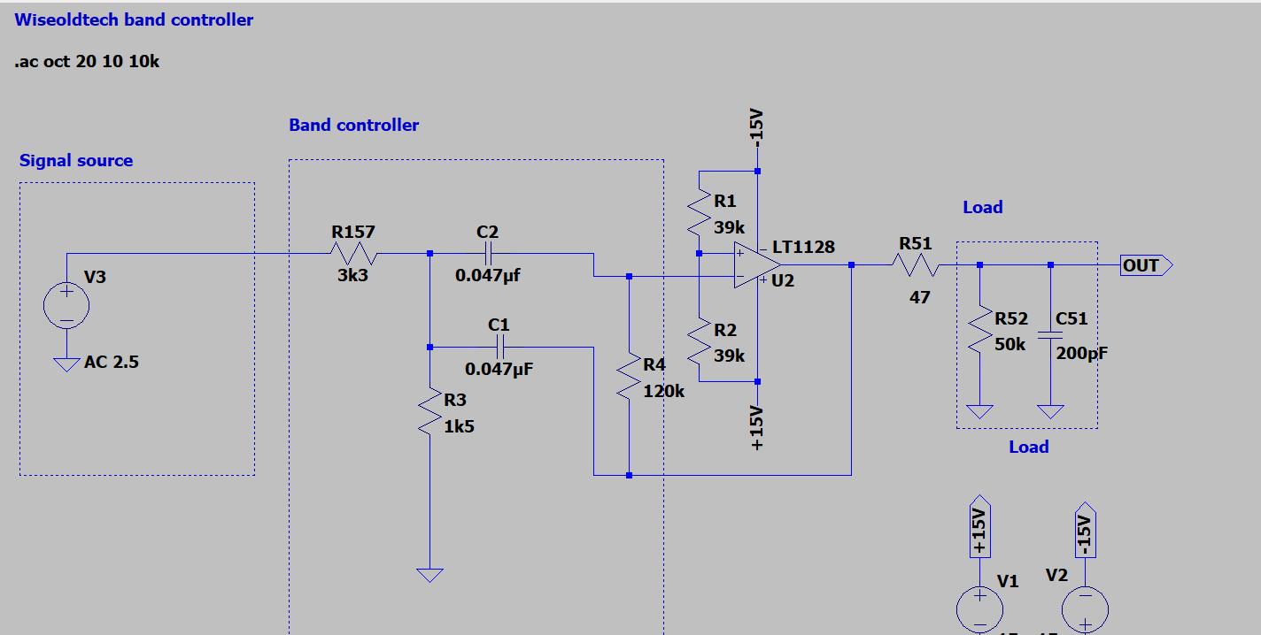

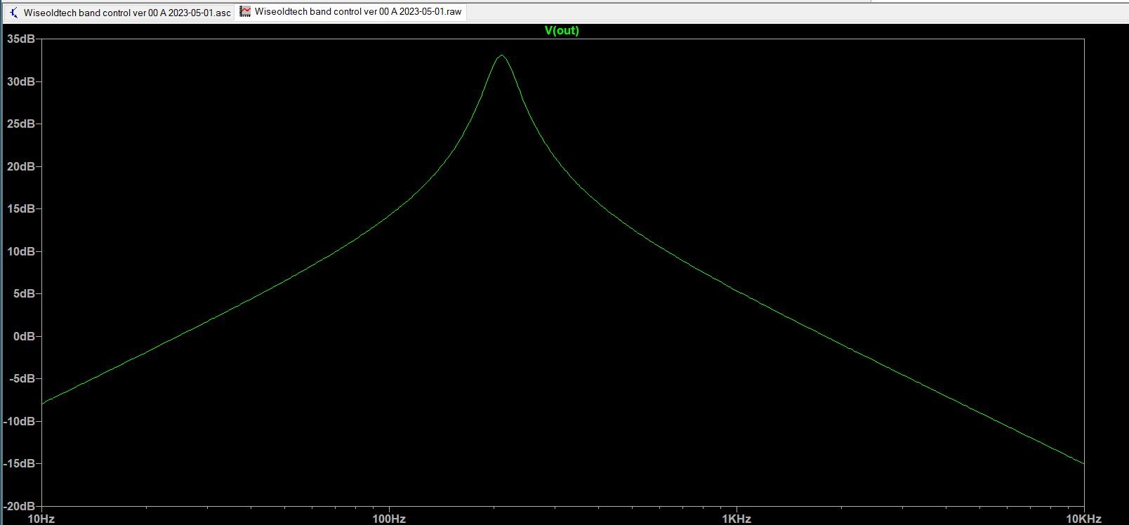

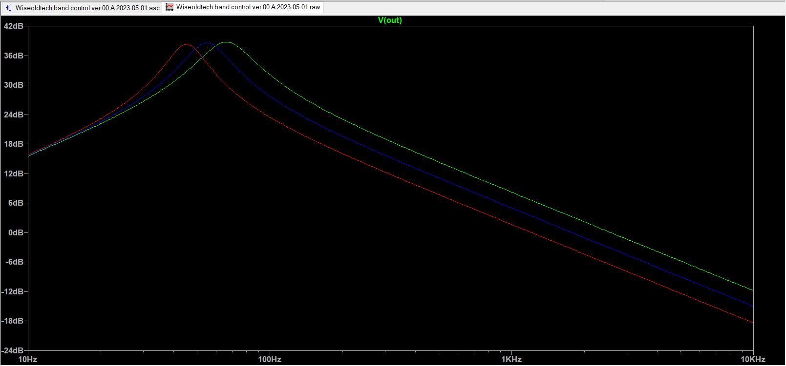

Anyhow, C1/C2 0.068uF graph would be like this.
Just ask mooly to help you starting up with LTSpice 😉
It is a bit rough when starting up but after that it can save you a lot of time.

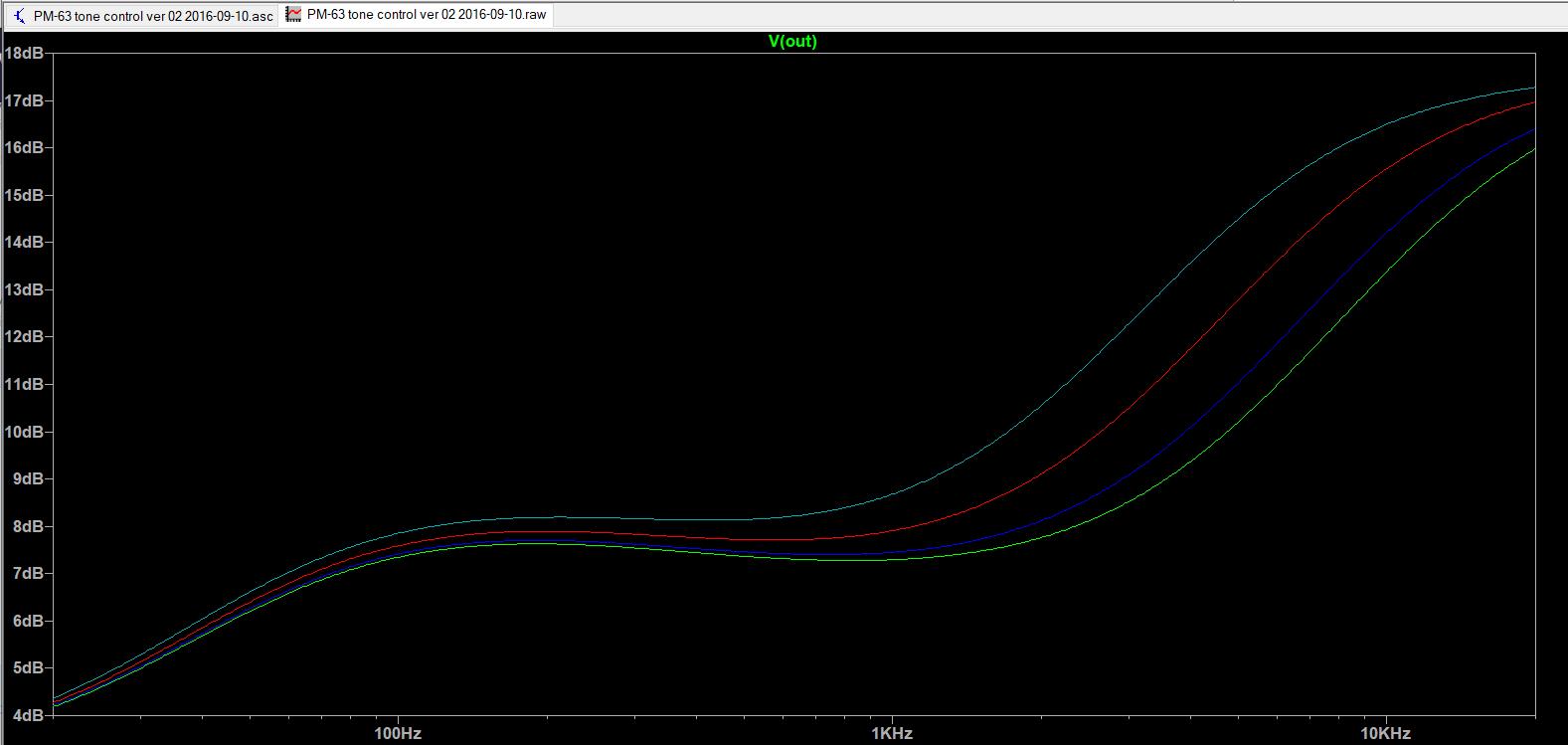

Edit:
when I decided that Marantz PM-63 tone control was not according to my preference then modelling it clearly indicated which way to go.
Not really: the center frequency is determined by the geometric average of the two caps, and their ratio affects the gain/Q of the filter. Small alterations of the ratio are not going to change things very much: 47n +47n will be almost identical to 39n + 56n, except the gain/Q is maximal for the balanced situation
For an amplifier, maybe; filters are a different breed of cats and obey they own rules.
You can make simulations to corroborate or infirm your hypothesis, but basically you should find that my statements are true: geometric average and gain are the governing parameters
