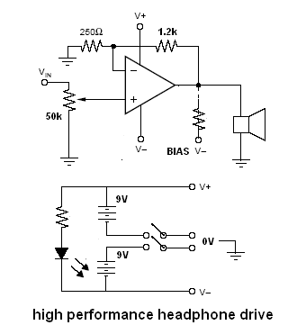

You could try the simple design. This sch. with good opamp like LME49860 would match or at least very close to top class headphone amp (you name it) with 32R headphone.
I recommend using NiMH battery and forget about the bias for now.
If you got too much hiss, try 1k/5k or even 100k/500k (or something between) instead of 250R/1K
It will work.
And be real hi-fi
When using CD-Player output and Gain=5, like you do
with your LME49710, LME49720 or LME49870 or LME49860
this would suit most anything between impedance 32 - 300 Ohm
