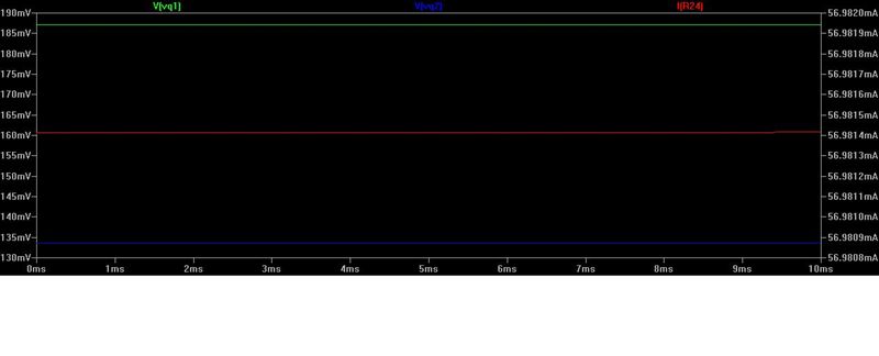

Well, a quick exercise with the simulator shows a few possibilities. Think I'll use a modified VBE amplifier bias generator with the 6 diodes (3 output pairs) in the base-collector leg. Now all I need to do is try it out to see how well it tracks.

About using the thermal traks themselves, I was thinking of using them (their internal diodes that is) in a modified VBE multiplier, except for one device. That last device will be the temp sensor for the protection circuit. That means one output stage junction will be uncompensated. Assuming equal current sharing, I think that'll be ok. Comments, anyone?
